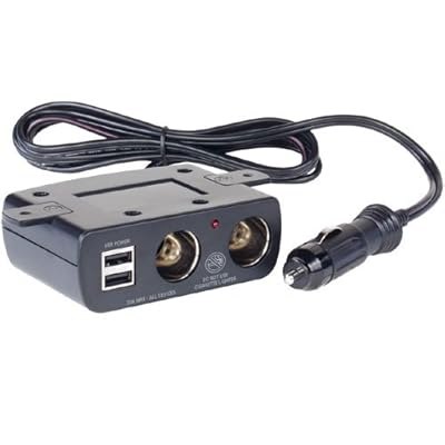

I did spend some time looking around the net for the product I was looking for and found a couple that might work but I really wanted to hide the whole tangled wire look. I actually have used the flashlight a couple times, but my driveway is not lighted and I often get home after dark so it has come in handy. I also take it with me when I run out to check the mail after coming home at night. One product I found that holds the most promise so far is:
My idea would be to cut off the end and hard wire it into the fuse panel and then run the wiring and place the power end somewhere out of the way. But I was hoping to find something like this with JUST the USB.

Nice, but where is the link to the item shown?
Old Jan 18, 2008 | 04:00 PM
ACEkraut11's Avatar
ACEkraut11
Joined: Oct 2007
Posts: 1,559
From: Durham, Maine
Sorry.....
http://www.amazon.com/Multi-Use-Car-...0700921&sr=8-4
