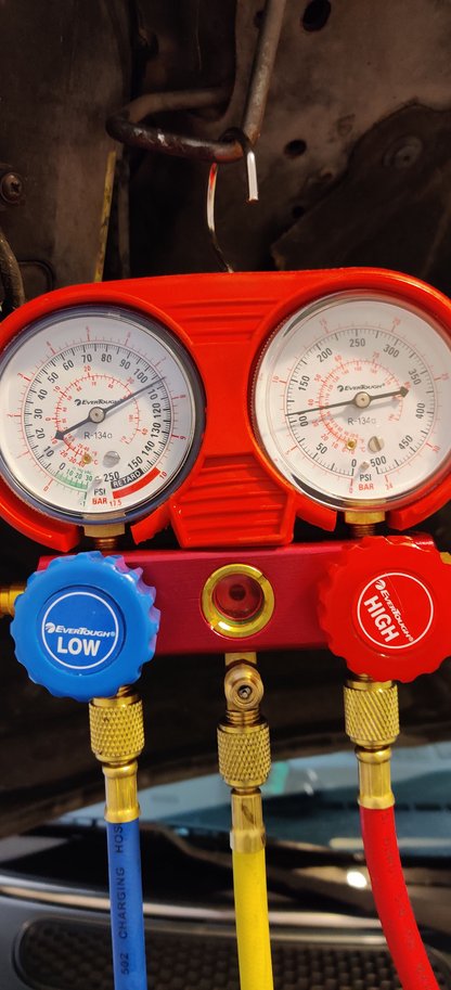

After checking my connections again, it was time to get the guages and vacuum pump back out. This will quickly tell me if I have another leak or not. I let it run 5-6 minutes and with the low pressure side bottomed out I **** it off and let it sit for an hour to see if it leaks off.
At start of hour
End of hour. Still the same so I was good to go to the next step. I then turned on the vacuum pump and let it go for another hour to ensure the system was free of air.
After letting it go the hour, I was finally ready to charge the system. I started adding oil and refrigerant, but the pressure kept increasing as the compressor wasn't kicking on.
