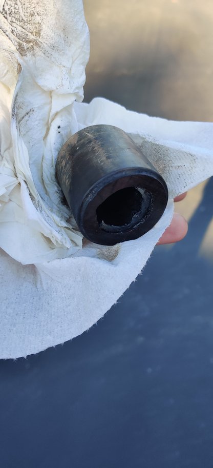

Also, while cleaning up the garage while it was on the test drive, I found this on the floor under the lift. I didn't come across anything like this during my repairs/upgrades so I have no idea it it's from the car or it was in the spare box of old parts that came with the car. I checked the control arm bushings since they was my first thought, but they don't look any different.
Thoughts?
That inner lip in the opening is metal, not rubber. I cut my finger on them when I picked it up.

TRW part does not ring a bell, I would also think a control arm bushing, but you double checked that already.
