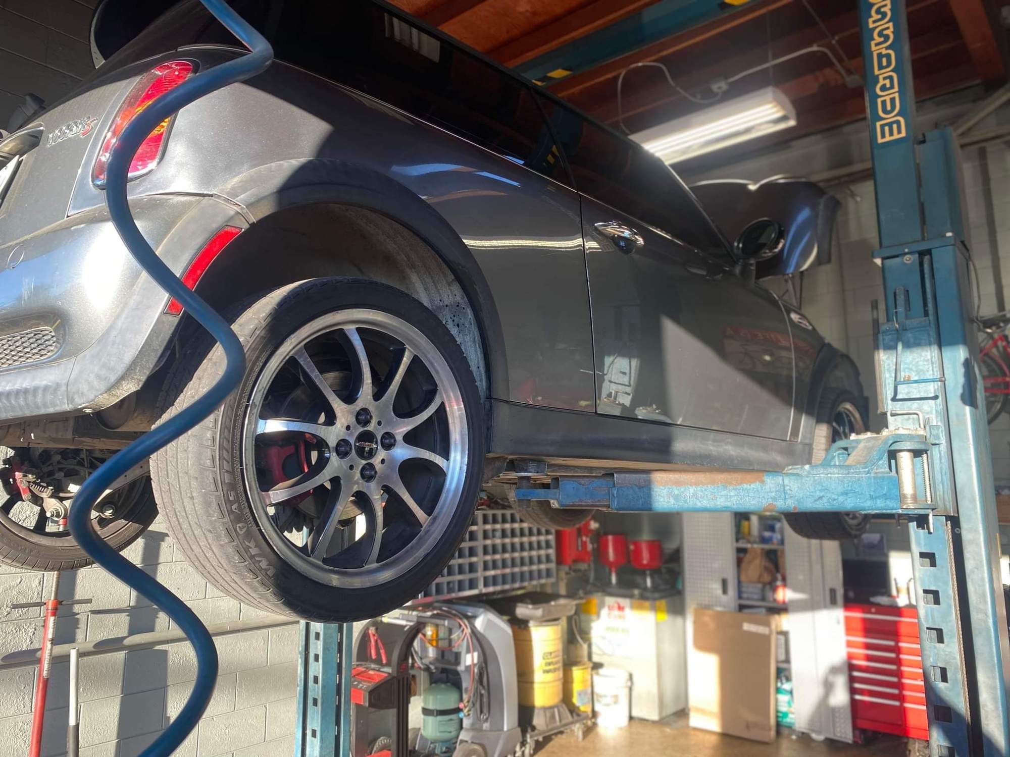

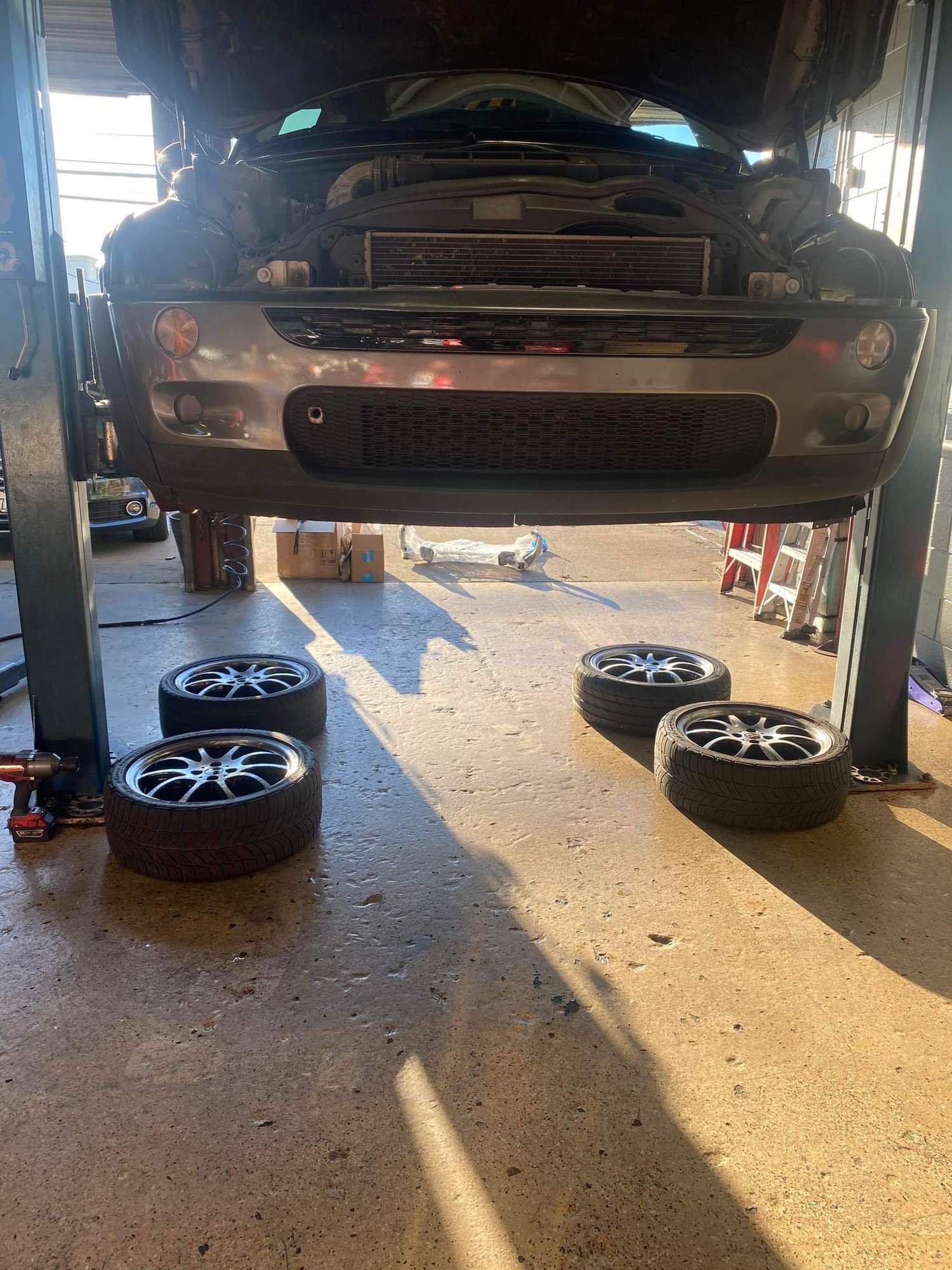

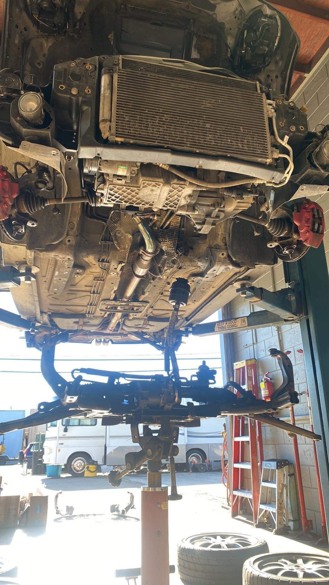

The suspension upgrades have begun! The car was dropped off at German Auto Service for the work as he's a member of the local Mini club and he does great work!
The Roach was put on the lift, and things started coming off. The subframe is out so we'll get the replacement fitted with new bushings and hard parts. We did discover that both hoses to/from the power steering reservoir were leaking so we'll replace them while we're here.
After rebuilding the subframe, the coilovers will be installed before the reinstall.

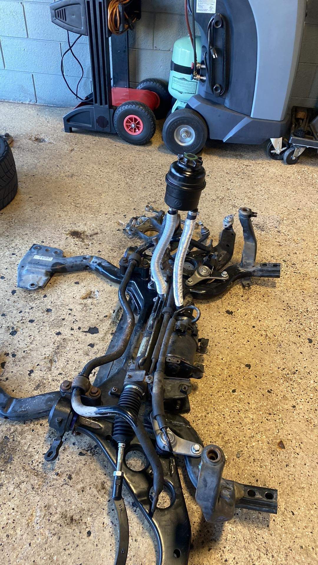

I'm picking up the Roach this morning. The new and rebuilt subframe is installed so that should tighten things up. Poly control arm bushings are definitely welcome!
The coilovers, sways bars, and rear control arms didn't get installed due to a mix up. I'll add more detail on that once things get sorted, and then the car will go back to finish up.
Sub before reinstalled. Also new hoses for the p/s reservoir will clean things up.
