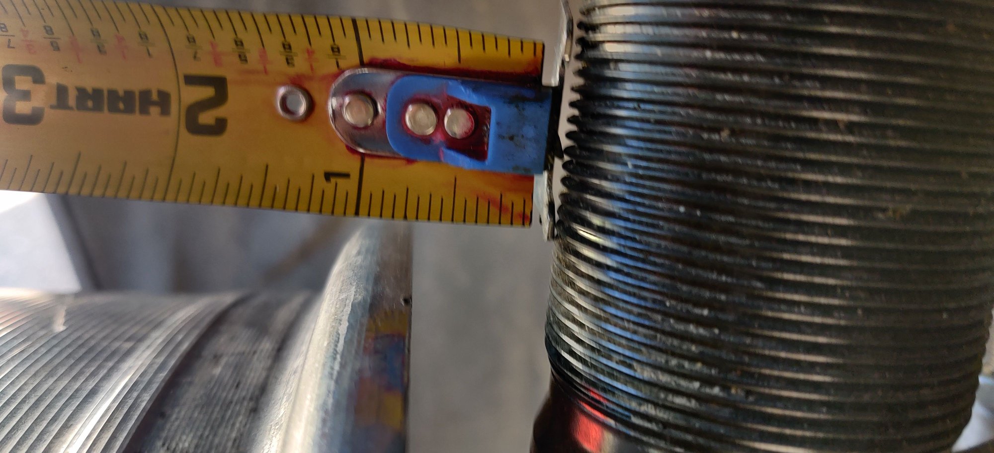

Well, this was quite the revelation. With clearance issues due to the new suspension, I decided to have one of the old tires pulled off the "new to me" wheels just to make it easier to check clearance and determine the best tire choice.
I had the tires pulled this morning, and I measured again just to make sure my prior measurements were ok. Well, the wheels were not sized correctly in the ad , i.e. 17x9 with 43mm offset.
They are actually 17x8s with ~38 offset.
So, now that I know what size the wheels really are all my prior calculations are off. I'll cancel the previous spacers ordered and after my checks today order another set. The biggest issue will likely be my wheel studs are too short. I may not have enough threads exposed after tightening to pass track inspection.
Just looking at options a 215/40/17 may be the good size to consider. It's shorter overall for better clearance with the coilover, and it will be fairly square with this wheel for tighter turning response.

The cheap 12mm spacers delivered yesterday so I did some more test fitting last night. I'm happy to say I have a couple mm of clearance so I'm good to go now. They also allow for 3-4 threads exposed on the studs so that is enough to clear track inspection as well. I'll take the wheel by a powder coater this week to see what my options are for color. I intend to keep the gloss black hoop so just need to find a center color that works.
Seems the 215/40 will fit just fine based on these measurements on the 8 inch rim. Once color is sorted, tires will get ordered.

Test fit #1 complete.
Once the AST coilovers were on, the 225/40/18s on the R105 wheels needed 16mm of spacer to barely clear them.
I picked up a set of 17x8 +38 CCW wheels to use solely for track fun. After reading tire specs forever, I decided on a 215/40/17 as I didn't think the 215/45 being only .5 inch shorter than the 225/40/18 will be enough.
The tire fits well with just a bit of stretch that I don't really like, but it will make for great steering response.
I now have plenty of clearance with a 12mm spacer which is needed to clear the R56 JCW calipers.
It has some more gap obviously, but still having the taller 18 tire on the rear may be causing some of it since they car is so stiff now.
