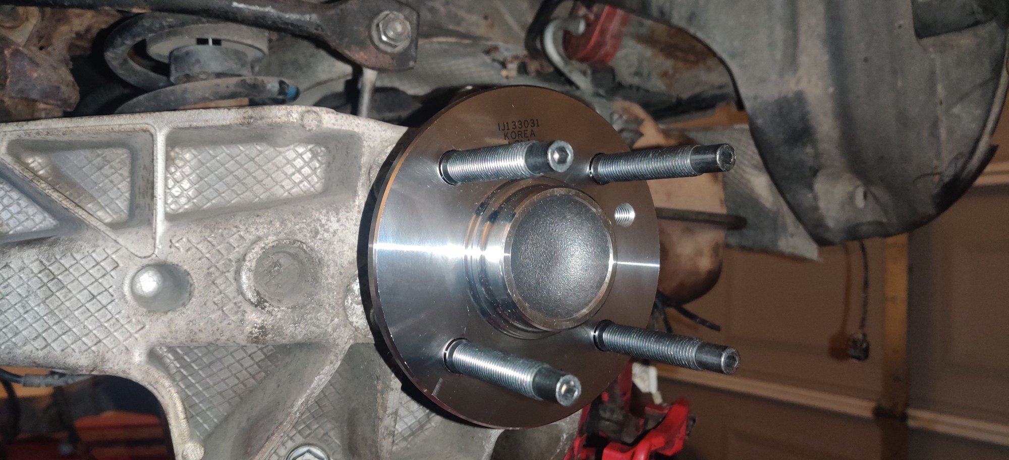

It's been a while since my last update, but I finally got the parts in that I ordered as part of my brake swap. Just to say it up front, this is been a PITA!
Alol the bolts for the hub and caliper bracket were seized up and corroded. After spending over a day messing with it, I decided to just pull the entire trailing arm out so j could have better access. That didn't make the bolts easier,. but it did move me to make a last minute call to upgrade to the R56 aluminum arms. I might as well replace them with something better, plus the CA yards are full of non corroded parts with like new bolts!
I made a run after work on Saturday, and scores a complete pair of arms with all mounting bolts, ABS sensors, and all the caliper/hub bolts to replace mine. It only cost me $61 which said I should have done this sooner to avoid wasting the time earlier.
Old vs new....
From there is was just matter of doing some quick cleaning before installing the alum arms with new parts.
I really like the StopTech pads. I've been running them on another I'd my track cars and they work great. Maybe mot for the hardcore driver, but I like them.
Once the new arms were in, everything bolted up easy. Due to the last minute change, I was able to connect the shocks as I need the bushing adapters. I'll get those ordered tomorrow and hope to have them by end of week.
​​​​​​I Still need to get the rear brakes bled. Due to a bad line I ended up making a new brake line for the right caliper. All is good now, but I'll need to bled them this week so that I can start on the fronts next weekend.
I got the new front hubs in on Friday, figured I might as well swap the fronts too just for peace of mind. The brakes look good, and I can't want to see the larger front brakes!
BTW, I could not find a plug for the pas wear sensor. Was this not available on early 2003 MCS? I looked all over and not even see see cut wires so I left the pad sensor disconnected for now

The shock spacers from WMW arrived a day early so I had to get out in the garage to finish up the back side.
With those in hand, it didn't take 15 to hand thread them in and then torque all the bolts before reinstalling the wheels. Very excited to get this done, here's a quick pic with the rear caliper seen through the R105 spokes.
I definitely like the new studs over the wheel bolts. Makes things much easier!
I moved to the front end and got it in the air, pulled the wheels, and then the wheel liner since I'll be swapping the bad strut mount. I'll be replacing both liners since the originals were cracked, plus it will clean things up nicely under the hood.
Actually, this might be the perfect time to throw in the chain tensioner since there's more room and I can see it easily now.
I figured while I was out there, I might as well check out the bolts on the front. Surprisingly, they looked pretty good without all the corrosion I fought on the back. I grabbed my wrench and easily got all the hub bolts and caliper bracket bolts loose. I then move to the driveshafts, and both of them broke loose without any fuss.
With things going so well I decided to call it a night. My luck was running high, and I wanted to leave the garage on a high note....lol
Tomorrow after work the old stuff comes off, and then after some cleaning the new stuff with start getting fitted.
