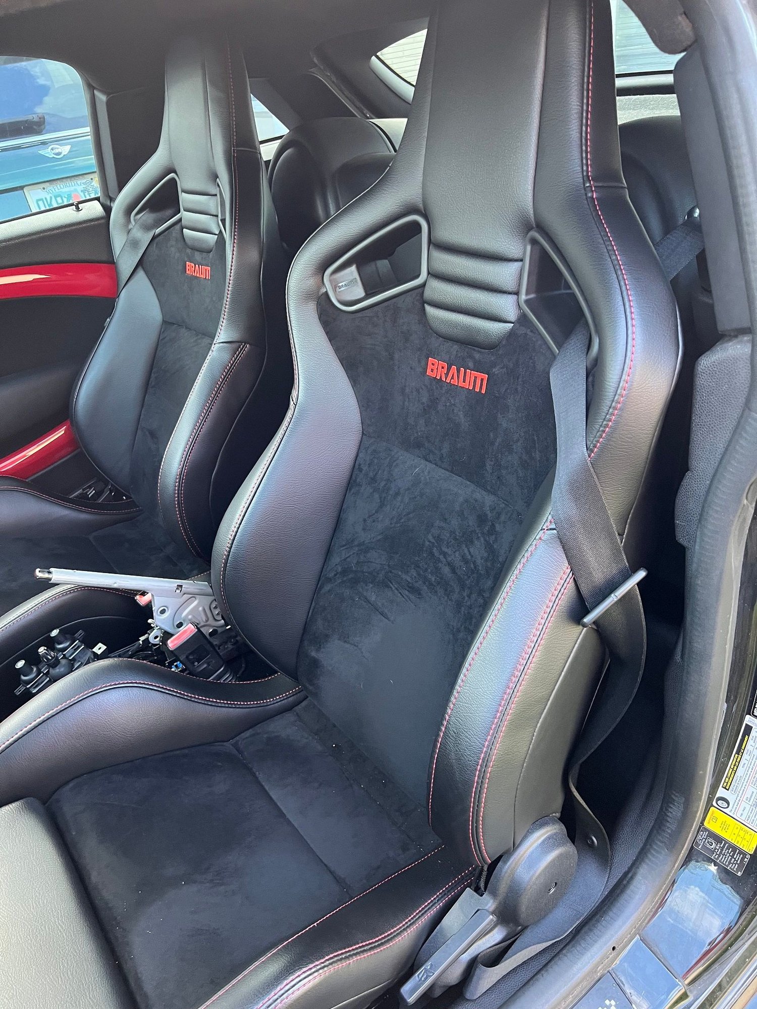

So once the frog gauges were installed I kinda got off on a tangent on the interior. The factory Recaros were out and installed in Heinrich so new seats were in order. They needed to be reclineable sport seats, comfortable, affordable and fit in a Mini. That's not always an easy combination to find. The back width in the shoulder area is where things can get tight. After a bit of measuring and searching I came across the Braum Elite V2 seats which seemed to fit the bill nicely. So I ordered those along with Planted seat brackets. When I pulled the original Cooper S seats from Heinrich I swiped the wire harness since the guy I was selling them to was planning to install them in a 47 Mercury. Slapped in some 2.2 Ohm resistors for the airbags along with an occupancy sensor bypass and the seatbelt resistor and all was good. I'm super happy with the fitment and even though they are designed as a performance seat they are surprisingly comfortable. I haven't taken any cross country trips yet so my opinion could change lol.

Few more interior updates. Installed the CAE shifter which I love, love, love. At the same time I installed the Vibra-Technics lower engine mount. Surprisingly I don't notice a large difference in NVH. Little more transmission noise radiating up through the open hole till I get the console re-installed. It's all trimmed up and I've been waiting for a billet brake handle I ordered that's made out of stainless. Hopefully it will look pretty good. Other updates include the Rennline pedals which are also great for those of us the aren't that great at heel/toe shifting. Last thing updated so far was the GP2 steering wheel. I looked at quite a few carbon wheels but I didn't want one with a flat bottom. Glad I choose the GP2 as it feels great and doesn't look too shabby.

Previously I mentioned I was waiting on a stainless steel EBrake handle to arrive. The handle is made by a company called Storm Motorwerks out of the UK. The Director of the company is also a Co-Founder of Eventuri so it's not surprising that they make a quality product. Tracked it via FedEx to Memphis where it got held up. Could not get an answer out of FedEx other than it was held up in customs. Turns out customs managed to lose it. Grrr... the Sales Director, Sulaiman was super cool about it though and sent me another one that made it with no issue.
Packaging was excellent and as you can see from the cut out in the box they also make billet shift ***** as well.
The handle uses three stainless set screws to secure the base and has one o-ring in the base and one towards the front to ensure a snug fit with no movement. The billet cap is held on to the factory release button with two set screws which are hidden inside the handle. You slide the handle on first, secure the end cap, slide the handle forward which covers the setscrews then you secure the base. One thing to note is that the end cap is a very tight fit on the factory release button. I sanded the end of the button down some to make sure it would slide on far enough for the set screws to fully engage it.
Really happy with how the handle turned out. The is zero movement of the handle, engagement is smooth. I was expecting to feel NVH through the handle being a billet unit but the o-rings isolate the handle very well.
Next I need to finish the Lohen sport button relocation and decide what I'm going to do with the open area around the CAE.
