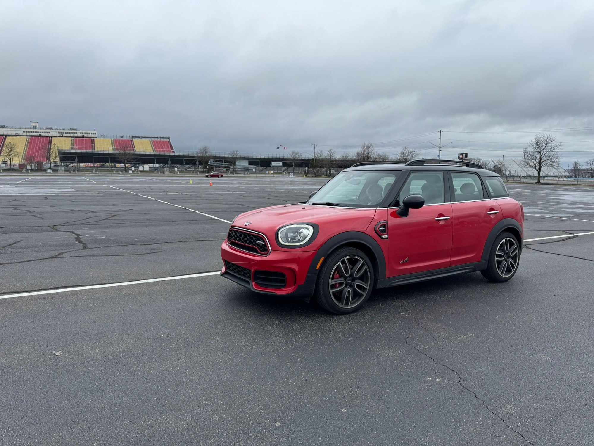

Here he is on collection day:
Seems that finding ANY F60 JCW in the US is a rare feat, but I found the one I wanted down in Savannah, Georgia. He is an early 2019 JCW with quite the spec list. Seems the only options NOT included on this thing are the head-up display and adaptive cruise control.
First order of business... Drive it home.
1,100 miles later, he is resting in his new dwelling.

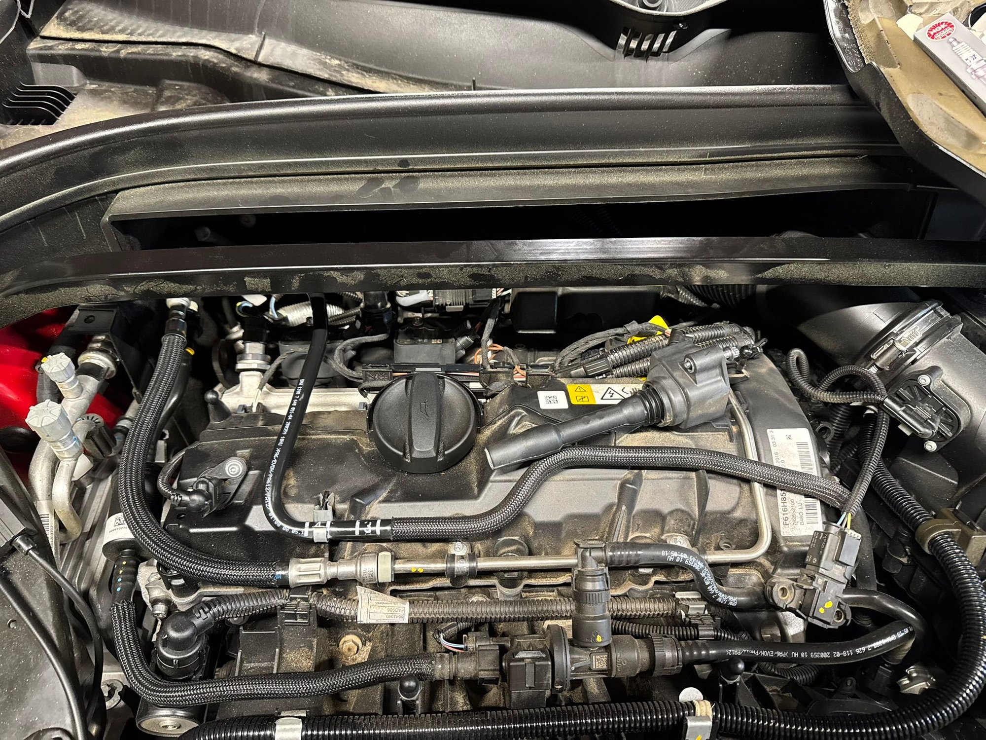

With just a tick over 60k miles on the clock, new spark plugs are in order. Picked up some NGK 96206 plugs and swapped 'em in. If anyone has changed plugs on an F60 before, not fun. The strut brace goes right over the coils. If I hadn't picked up a swivel socket, I would have had to dismantle the struts brace tog et them out.

Didn't realize there was a brace in those models. Daughter's F54S doesn't have that, plugs are relatively easy.

With the engine tight against the fire wall, and the strut brace right over the coils, it doesn’t lend itself to accommodating what should be some easy maintenance tasks.

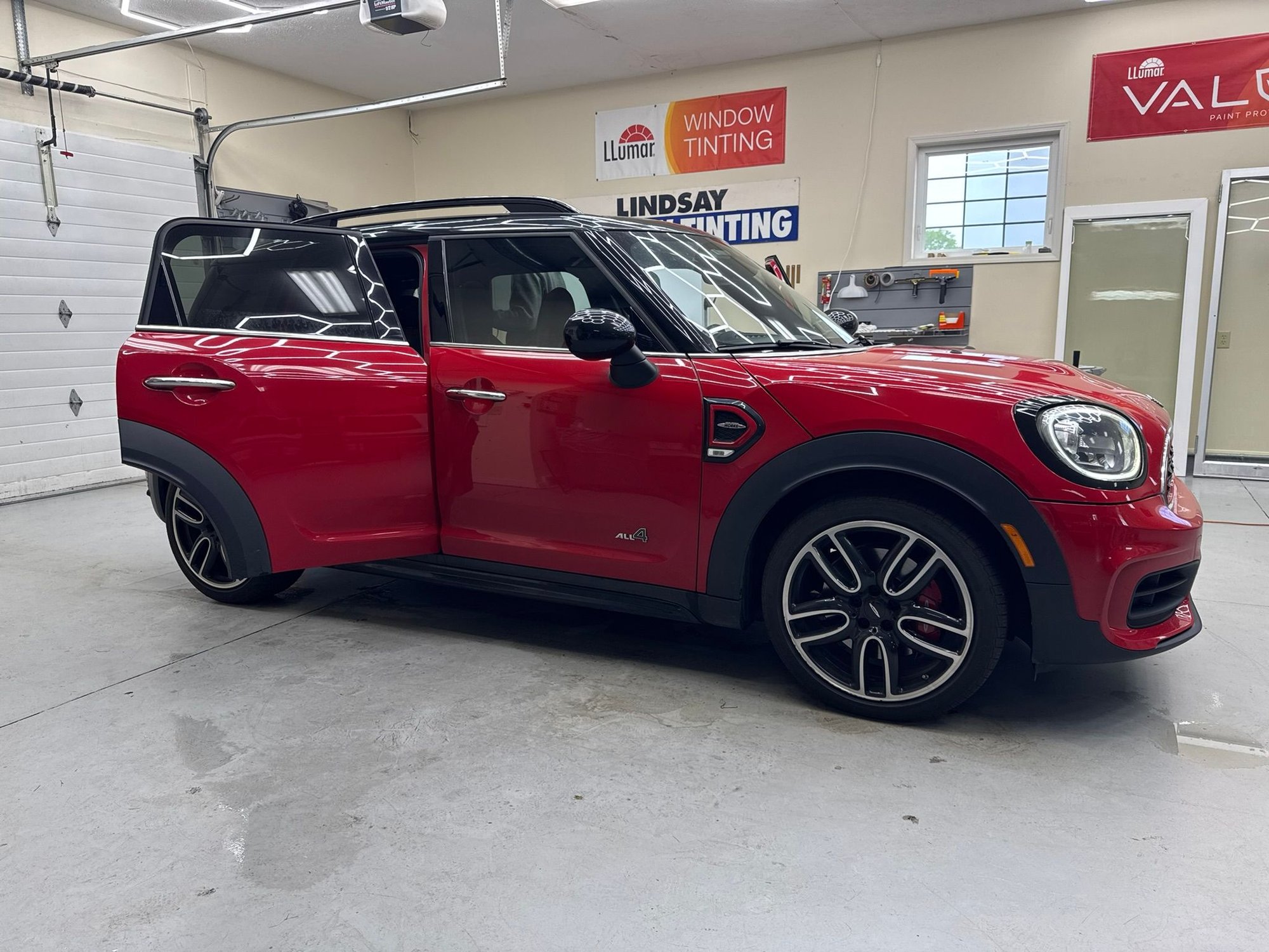

Getting window tint installed to keep the sun out of the interior:

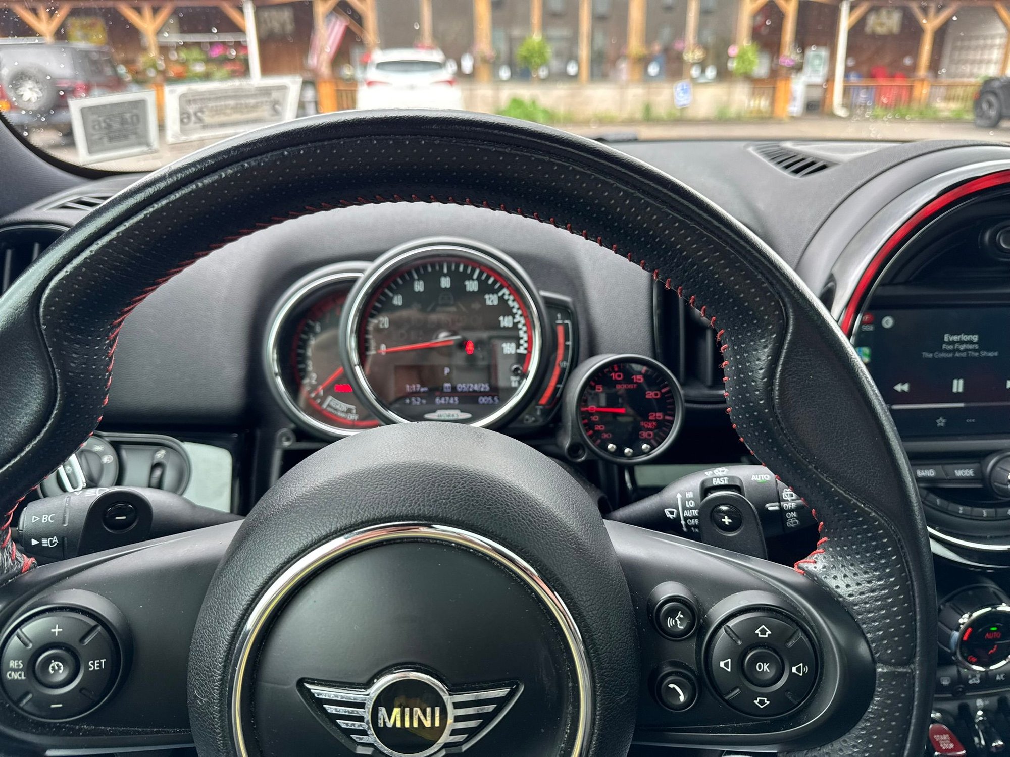

Boost gauge install:
Not sure how I feel about the CravenSpeed mount... Because of where it is, it vibrates quite a bit. I had to shove some foam pipe insulation in between the gauge cup and the steering column trim. I prefer this placement to anywhere else, however.

I might have missed it but where I are you getting signal from for the boost gauge. I'm sniffing around a gauge myself.

There is a sensor on the intake manifold that gets piggybacked with the CravenSpeed boost tap. Torque Solutions and NM Engineering also sell similar boost taps. I don’t have any pictures, but if you search them out you’ll see where they go. The boost tap gives you a spot to run the boost gauge sensor.
One thing I learned from installing a boost gauge on this car: these engines do not run any vacuum. Like at all. (or VERY little) The gauge only goes slightly under 0 during highway cruise. The N18 engine in my R55 would pull vacuum on cold start, then make the switch to VANOS operation and run 0 vacuum. These new energies run VANOS at all times, even cold start.

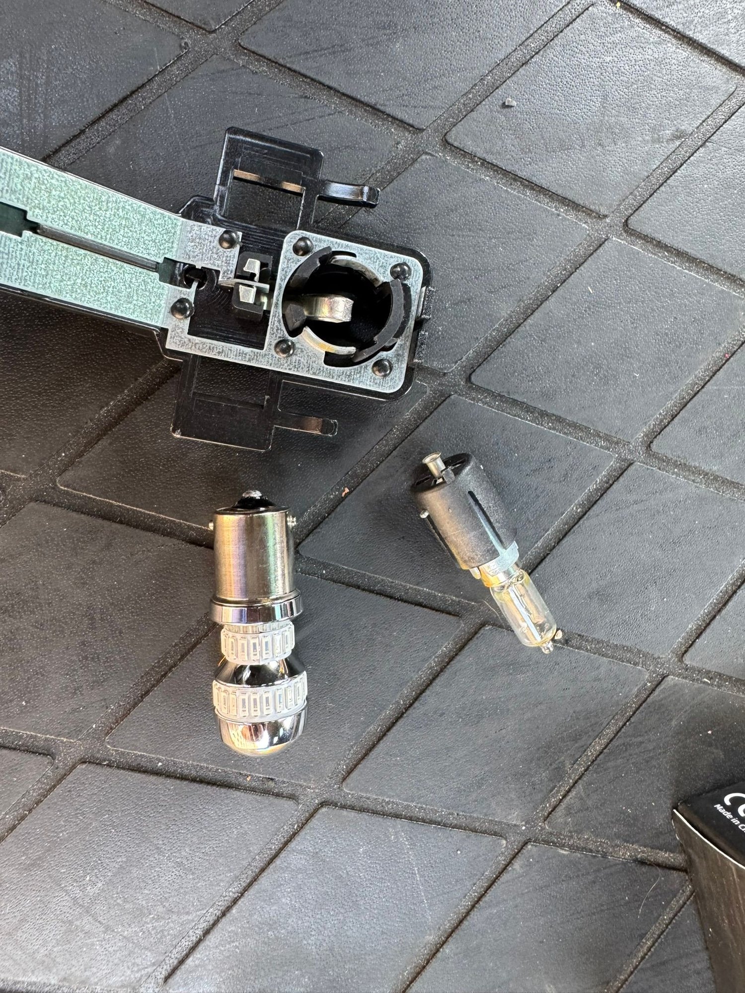

So, learned about a weird design implementation / choice that Mini made today regarding the rear tail lights on the F60...
I am a BIG fan of LED bulbs in my cars. Not only are they super cool looking, most times they are brighter than their halogen style brothers. Since I purchased the car, I've been wanting to upgrade all the bulbs to LED style. Brake lights were next on my challenge...
Enter RealOEM.com and a quick search reveals that the rear brake light bulbs in the LED tail light housings are item #6 and are an H21W size:
https://www.realoem.com/bmw/enUS/sho...diagId=63_1817
OK, now a quick internet search yields about 2 manufacturers making red LED H21W bulbs... Great. Much deliberation, and I settled on these:
https://maxgtrs.com/products/2-super...44676962844906
Based on the website, I liked the design, and they had the appearance of quality. When I received them, I was impressed, and made plans to swap them out.
Enter today, and I popped open the trunk, removed the bulb carrier, and found a very amusing part... Sorry, but no pictures as I was too flabbergasted at what I found. Turns out, the H21W bulb fits into an adapter, which then mounts into the bulb carrier. And, guess what? The bulb adapter adapts the H21W bulb to fit into an 1156 socket. That correct, the brake bulb COULD have been a standard 1156 bulb, but rather Mini, in its infinite wisdom, decided to use a fancy alternate bulb and an adapter instead of a regular 1156 bulb that is used literally everywhere else on the car. In fact, the turn signal bulb and reversing bulb are both 1156. AND, the regular non-LED tail lights are also 1156 for all bulbs. In fact, if you look at the parts diagram again, you can see the little adapter, conveniently without a part number associated with it:
That being said, I was not happy with the output of the H21W LED bulbs, so I put the OEM bulbs back in, and will run those until I can find some 1156 LEDs to swap in. At least now I know that regular 1156 bulbs will fit in there...

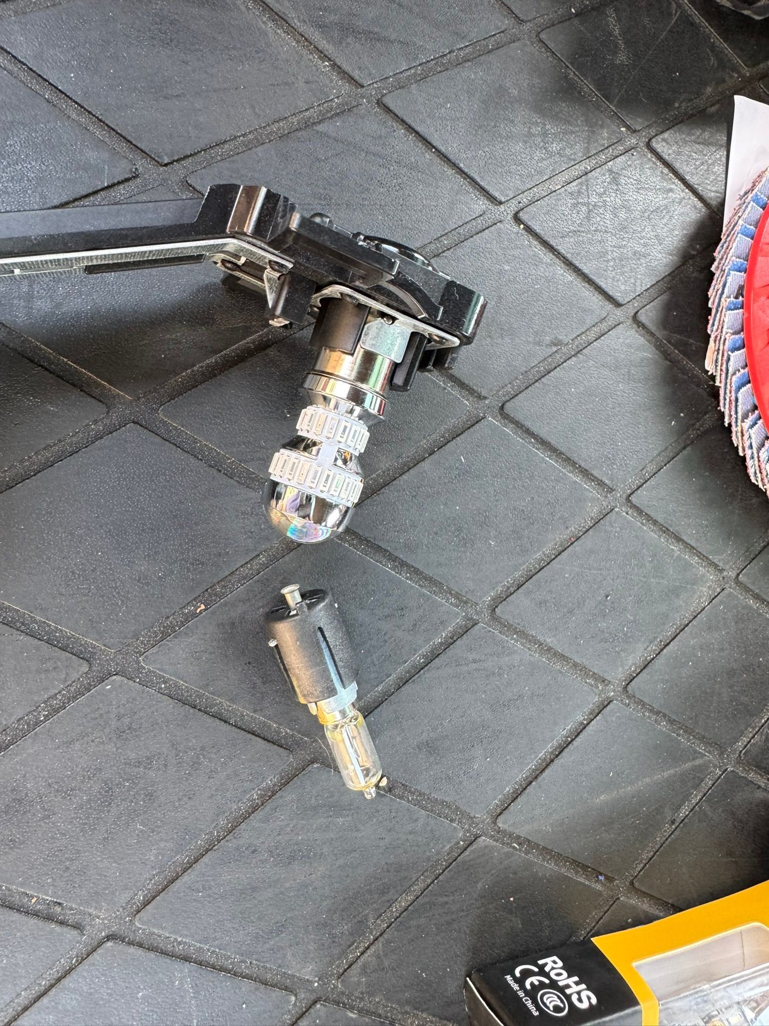

My new LED bulbs came in, so time for a follow up. I got some pictures this time, too.
Just a recap, I have the pre-LCI "LED" tail lights. While Mini refers to them as "LED" version, only the running lights are LED. The rest of the bulbs are regular halogen filament bulbs. Turns out, however, that the bulb carrier for the LED version is the same as the non-LED tail light version. As such, the brake bulbs do not have to be the fancy H21W style bulb. If you remove the bulb adapter, a regular 1156 bulb will drop right in. My only guess for this adapter is to prevent the heat from the 1156 bulb from melting anything. But, this is only a guess.
My car now sports 1156 LED plug-n-play bulbs for all rear tail light duties.
And, these plug in LED bulbs I picked up from Amazon are B R I G H T. I about blinded myself when I unlocked the car in the garage this morning. I happened to be looking at the turn signal when I hit the remote button, and it made me see spots for a few moments.

Here is the H21W bulb in the light carrier
The infamous H21W bulb and adapter removed from the carrier
H21W bulb next to a plug-n-play 1156 LED bulb
The 1156 plug-n-play LED bulb mounted into the tail light bulb carrier. A perfect fit.

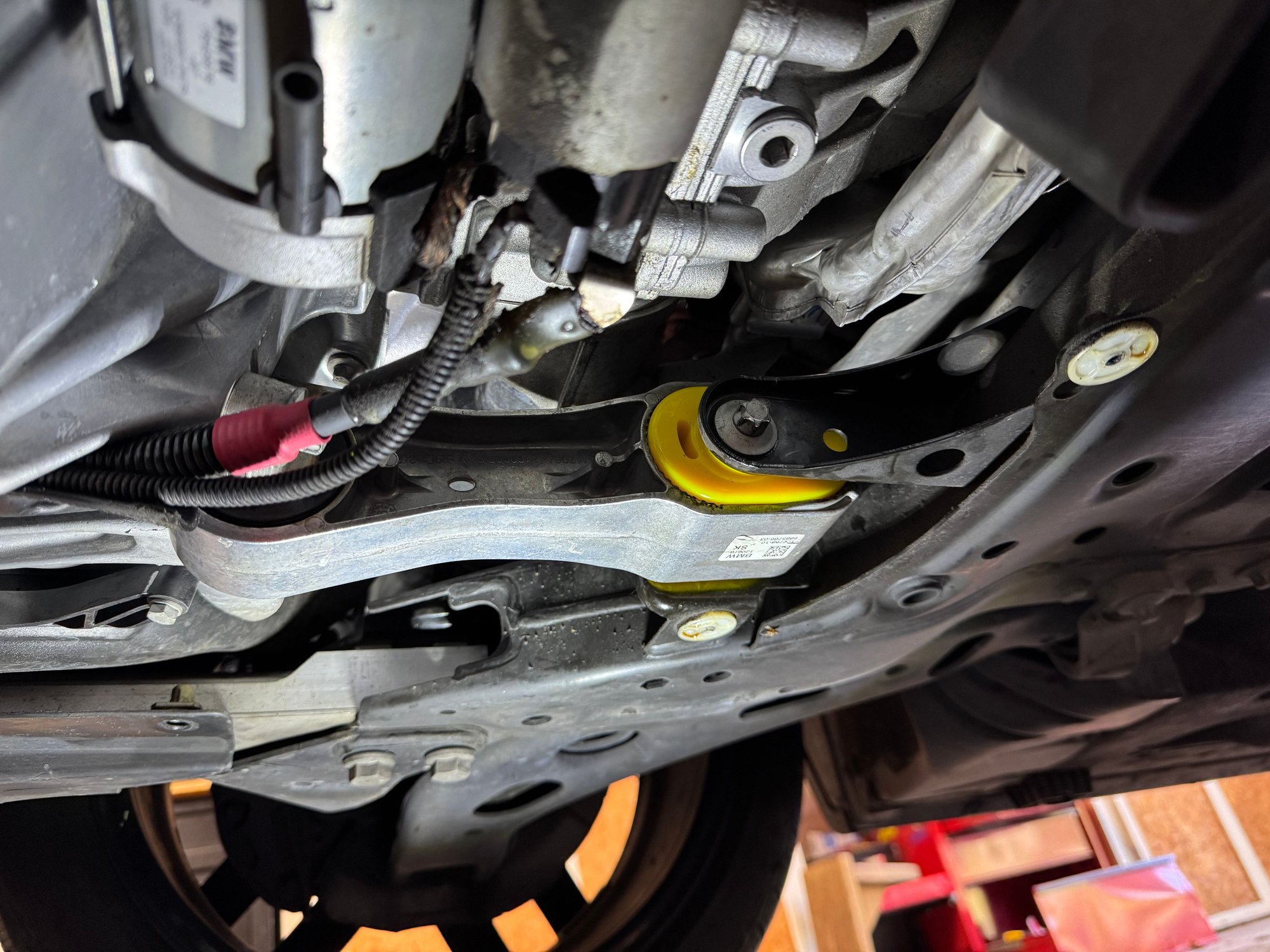

Got the lower mount bushing installed!
Initial impression: Didn’t notice much change with throttle response, but it feels like it made the shifts feel smoother. Will report back when I have a chance to give it the beans in Sport+ mode.
The bushing added just a slight whiff of vibration at idle, but added much needed throttle response. Since my F60 has the 8-speed automatic, throttle response seemed to be lacking. This bushing helped. I am noticing a bit of jerkiness on Sport+ up shifts. Daily driving shifts seem smoother. Where I see the biggest benefit is in the corners when I give it some throttle. Keeping the transmission in Sport+ Manual mode, I can now feather the throttle in the corners and feel the drivetrain responding.

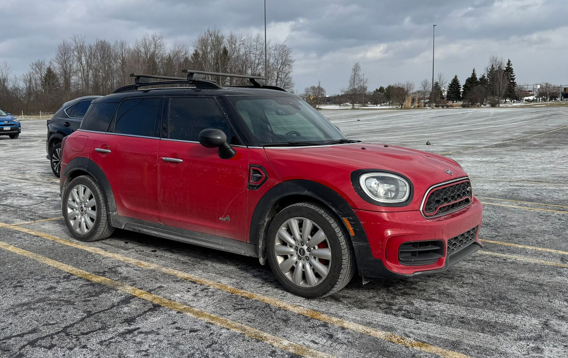

Bought some roof rack cross bars from Erkul. They do the job.
And, whooo boy, this car is fun

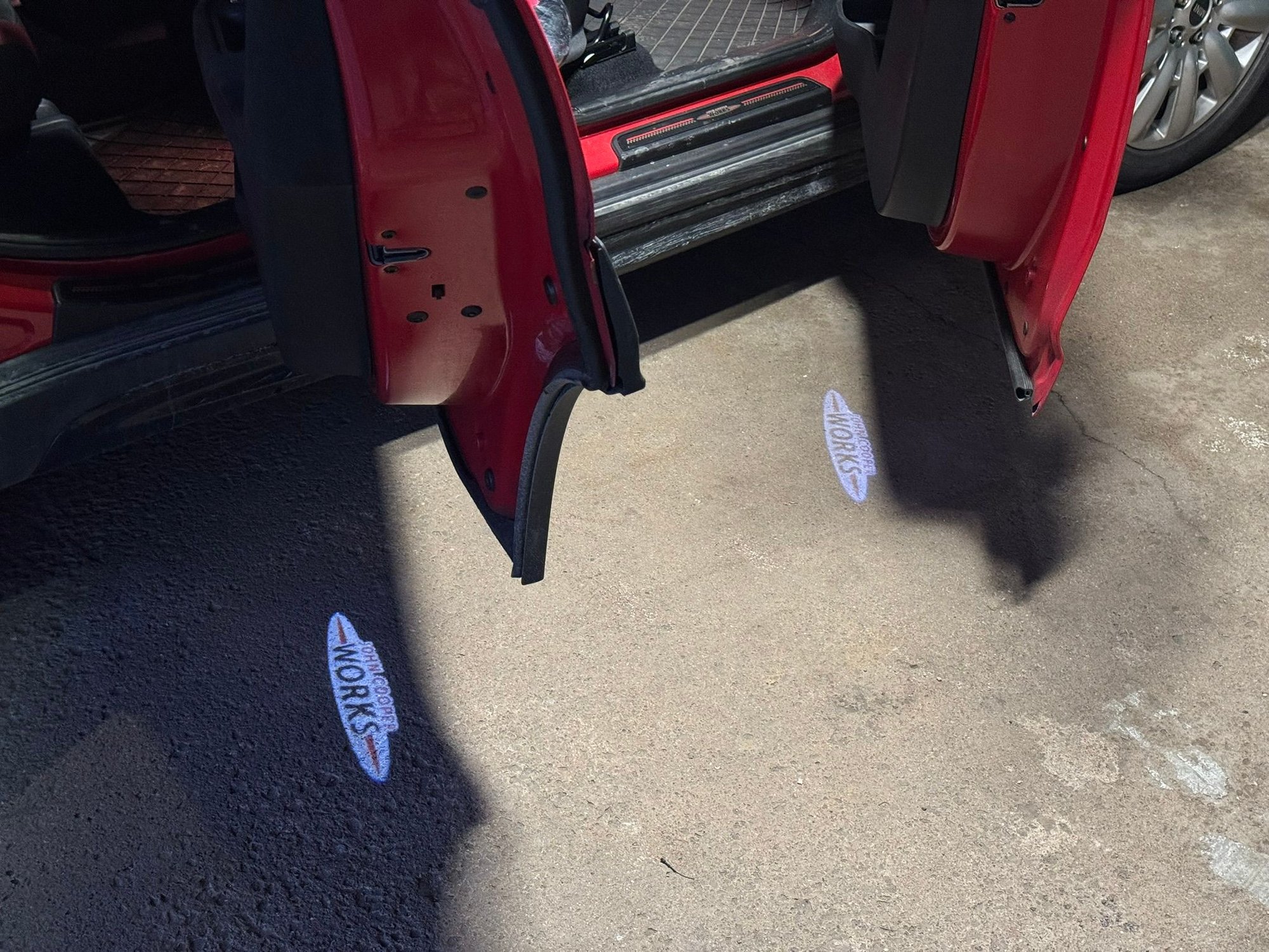

Added some JCW logo door lights from China. They were cheap, so I won't feel bad if they don't last too long.
