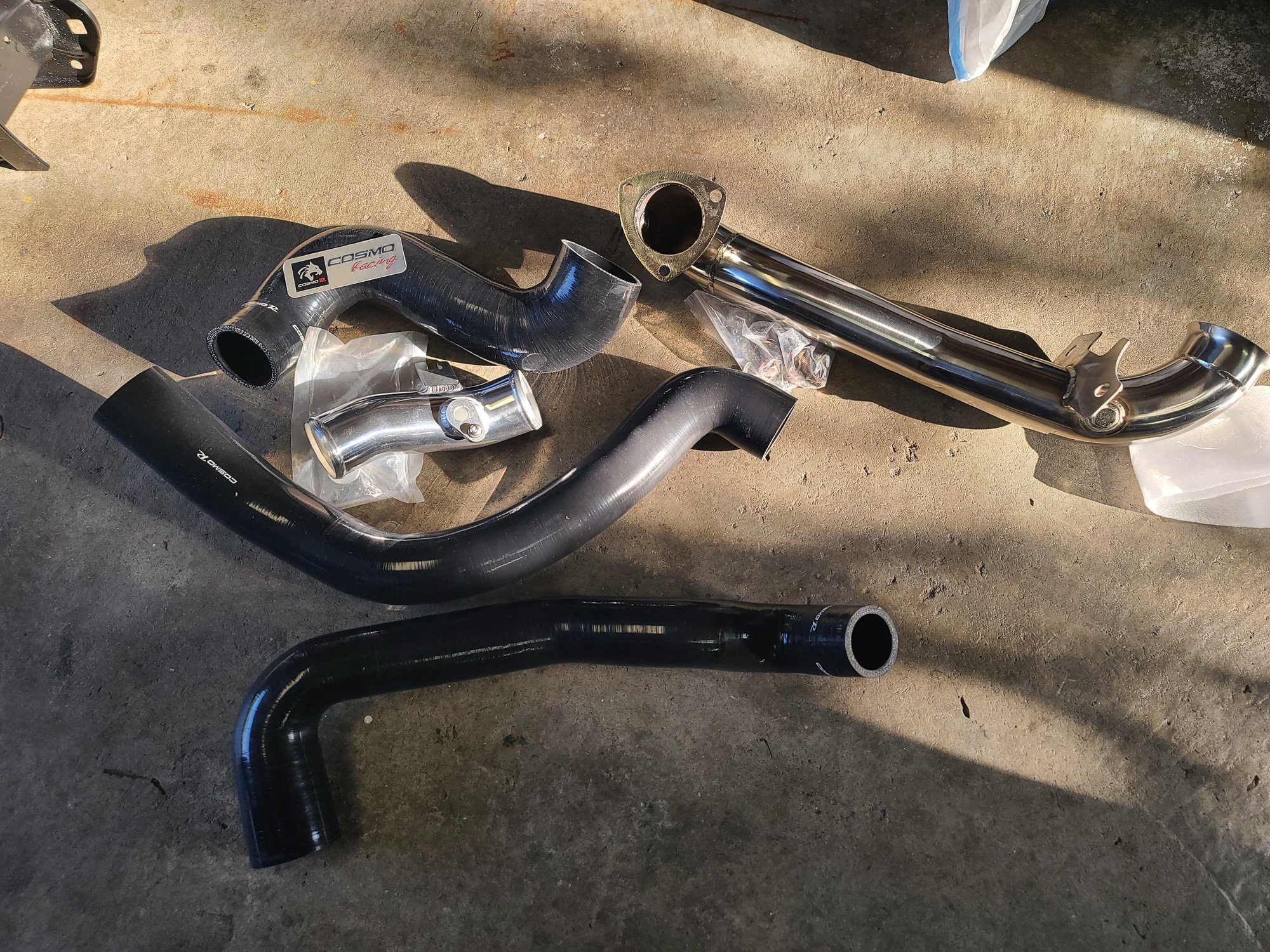

Buddy came by today and we did a little pre 4th of July partying and threw the k04 turbo on..
Other day i also installed a jb4+ and installed a boost gauge.. i made 18psi with the jb4 and the oem jcw turbo... it actually pulled decent but meh.
My upgraded intercooler piping arrived today alojg with the catless dp. So i need to get a bung welded into the dp to run a wideband. I also wanna wrap and coat it too then. I'm also still waiting on the turbo blanket..
i cleaned up and repainted the crashbar AND i took off most of the STUPID coating on my alta intercooler.. idk why the F anyone would paint an air2air intercooler
well heres some pics , sorry they suck and not many nor any videos yet BUT thatll change ina week wgen my new phone gets here.. my camera barely works on this one i got so bare with me guys.. i promise to mske this more interesting soon.
Jcw turbo forsale too if anyone is looking for one !
o yeaaa.. I also removed the underwounderhood heat keeper inner and then I opened up the hood scoop and made it fully functional.
I was baaaaaarely able to get the intake on over this larger k04 housing BUT I have a custom intake coming i had made in CHINA. The company has made custom intakes for me for ny r53s I'd had.he price is still byfar cheaper too than any namebrand intake and when I'm done building it and piecing it together, it's going to be an awesome Hella efficient intake.

This is the first time I’m seeing that silicone cold side pipe… How’s it fit?
meh , took some modding but good enough...

Daaaaaaaaaamn the car picked up GOBS of power.
totally impressed !!!! Ebay for the win again !
This turbo goes into boost SOOOO easy and hits that 18.5psi threshold soooo soon and holds it until redline.. it definitely spools quicker too. Not too quick to pop a cel or knock/ping.
im sure the upgraded piping helps too because geez oem is small by the tmap in that plastic tube.
this turbo isn't as sexy sounding as the 6x6 blade i ran last time BUT I feel like its a better responding turbo. Once I get tuned I will see if it can make 23psi my goal. Because last turbo that 6x6 it maxed out at 20.5 and no matter what was tried it couldn't boost above that.
I broke my flex pipe underneath just like I did my clubman so just like my clubman i Jerry rigged it till i get a replacement. Atleast it doesn't leak but lol it's ghetto.
soon as my phones here in the next day or two I will take a video and do a drive along and some pulls and let you guys get a good look at the car..

I also advise you guys to not buy the ic piping I did.. Selmer is nor willing to help in anyway. The passenger side hose Was much too short and I had to splace in part of the stock holes to fit. I also had to cut off the mountain tab.On the hard metal tmap adapter pipe Because that was well did in the wrong orientation. I notified the seller of all these problems and asked if he could send me out a replacement hose and I was told no. I showed him all the pictures and told him all the problems and his excuse for the that man was. " this is made to fit a stock engine, you have an aftermarket intercooler so that's why it didn't fit " which is ******** because I have an alta intercooler that fit my stock hoses perfect.
Heres the fitment on either side before I had to cut up and splice in the sections.
