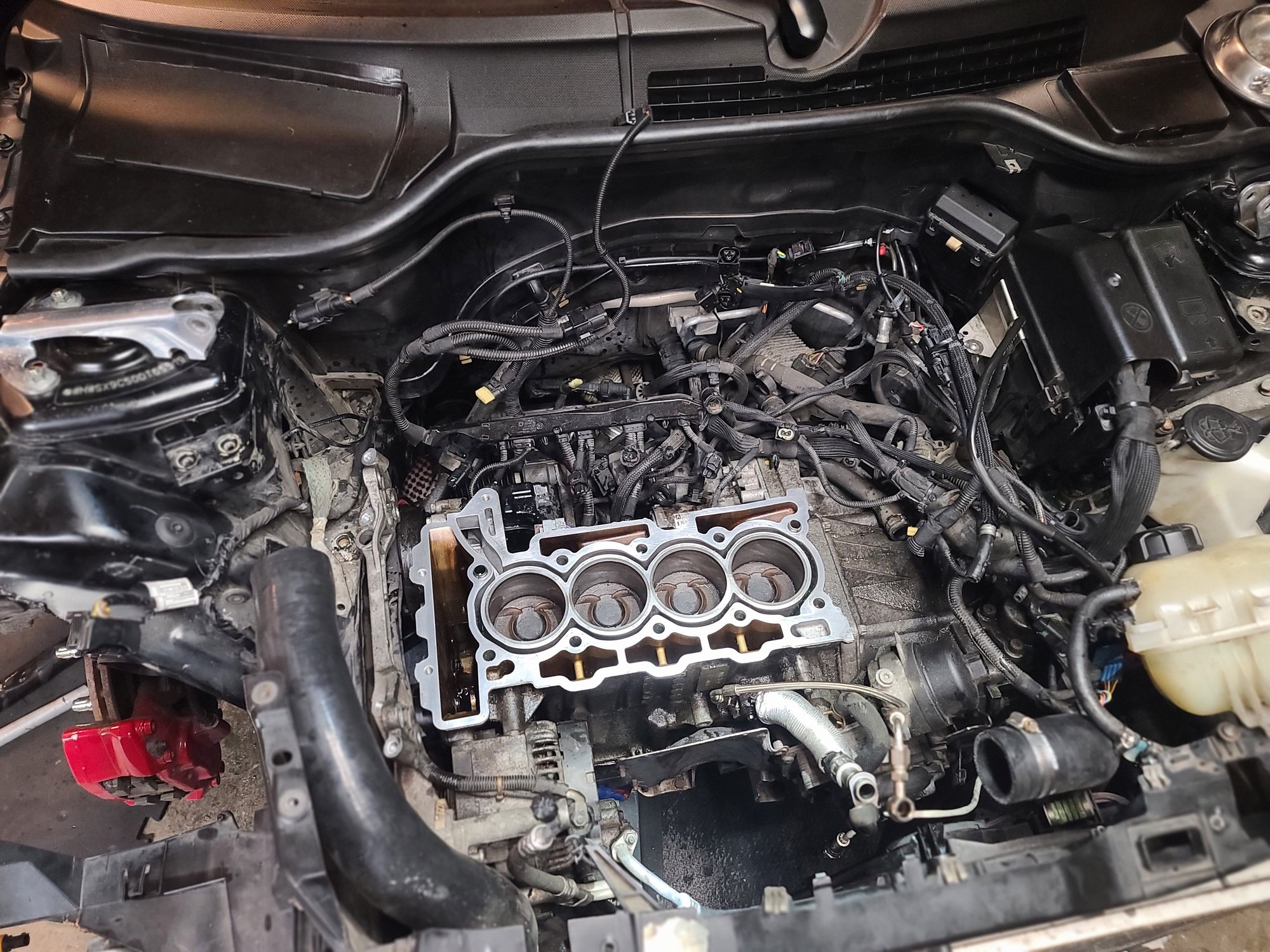

Sorry been so long. I've had alot going on and many things done to the car. But as it is , I'm about to order a rebuilt cylinder head and port it and install that along with the SWEET header !
my valve stem seals are bad and the car has begun exhibiting the tell tale signs of it.
I'm also doing new wp , aluminum coolant pipe and thermostat housing , new hardware and a tad thinner hg for a little bump in compression. It still is a mls hg.
So if anyone will be interested in my square port jcw style manifold speak now because it will be up for sale in under a month. it IS THE BEST flowing , best turbo spooling one made too btw... shoot me an offer.. o yea I habe a pic of mine from when I did my turbo install.

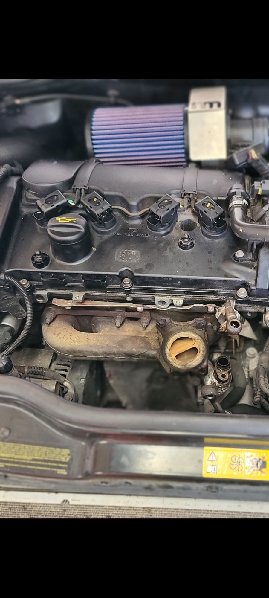

The welds on that tubular manifold look pretty bad… Might want to try and port match to the head and whatever turbo you bolt up that thing.
welds aren't the most beautiful but they're good.. no pitting or burn throughs , the flange is already port matched to the gasket so i will need to also port the cylinder head to match. I will port the intake side too for when I get the sidewinder intake manifold.

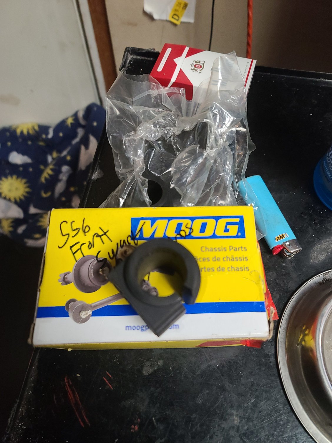

New speakers AGAIN , these handle more watts and go louder. So yea..

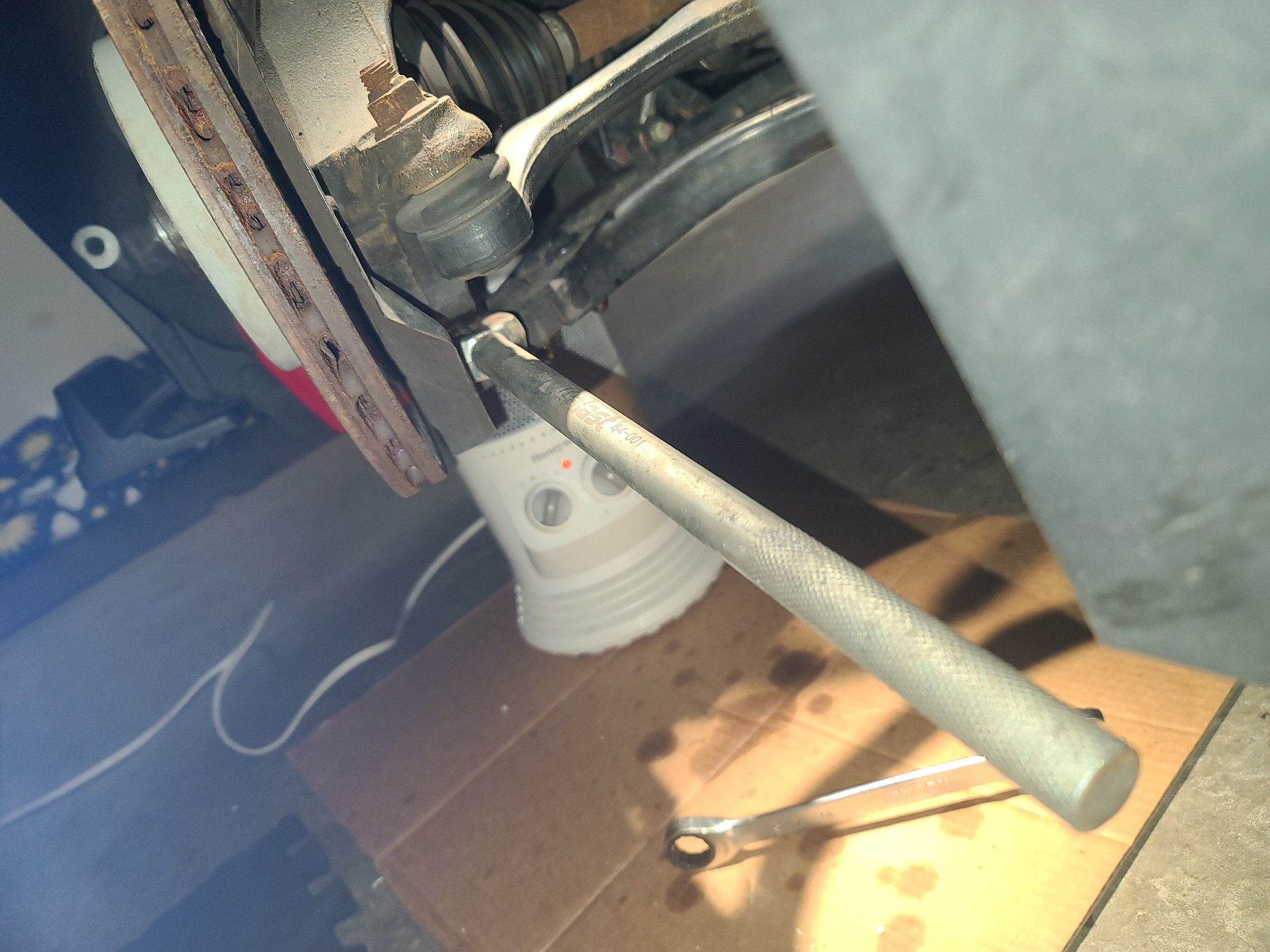

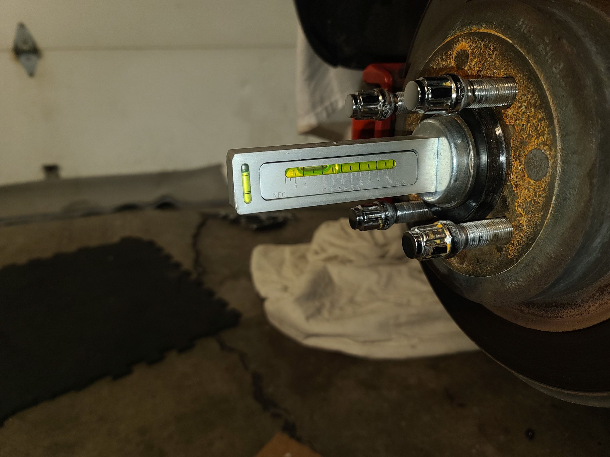

Since chasing the passenger side clunk I've replaced swaybar bushings ( without lowering subframe) , inner and outer tierods , outer balljoints and passenger side hub. Clunk still there.. so I'm replacing the rear control arm bushings now WITHOUT lowering the subframe. I cut them out and I will use a bolt and washer to pull into the polly bushings , I will get new control arms too since they come with the inner balljoints already in them then , I will have replaced everything up front now since putting on the coilovers 6months ago.
I also got am nm module to see if or thr ib4 is better for more power but ille test that once I get this suspension all figured out and dialed in..
o yea , lol I used boards to do my alignment and got it perfect after doing the tierods.

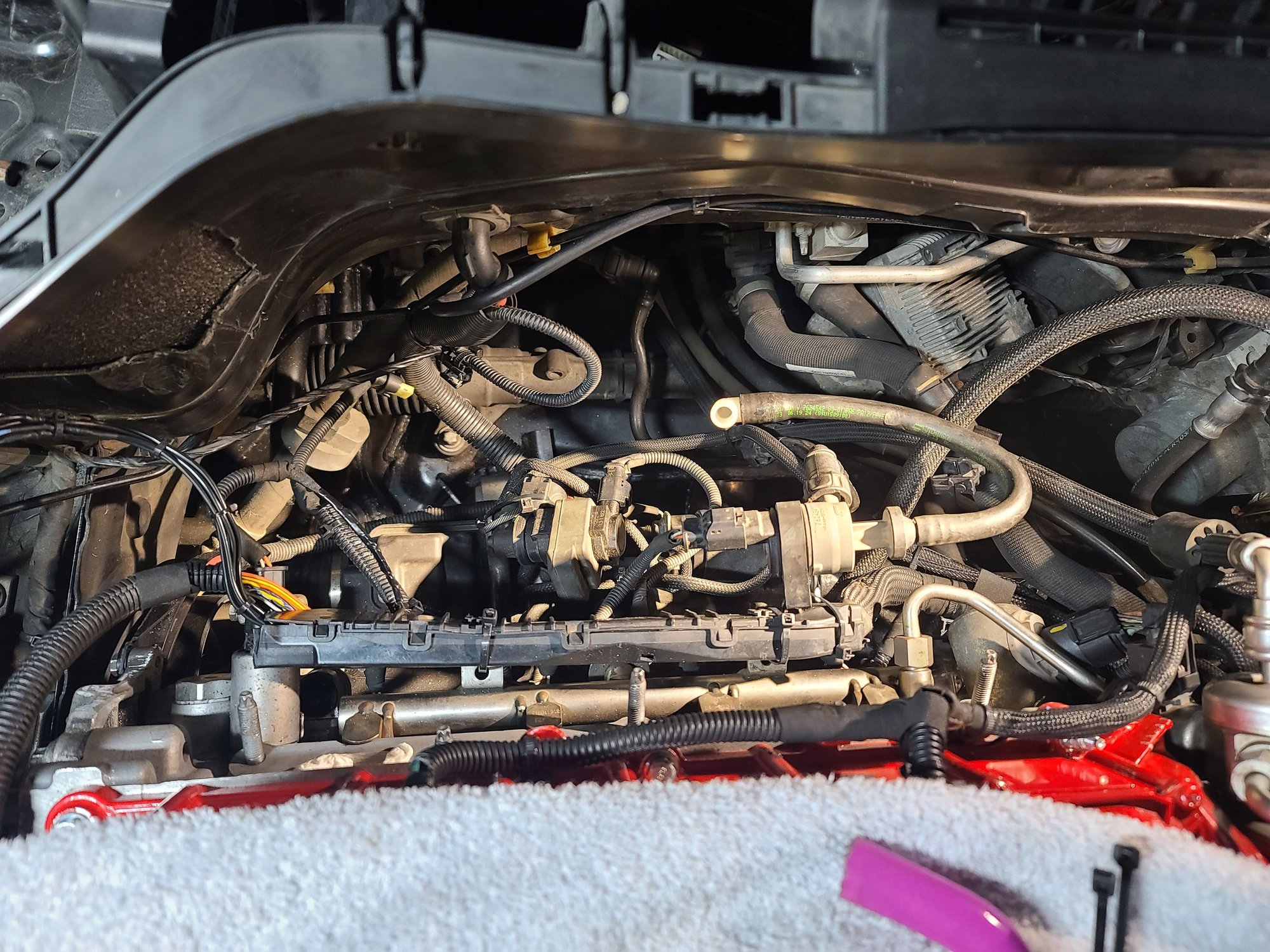

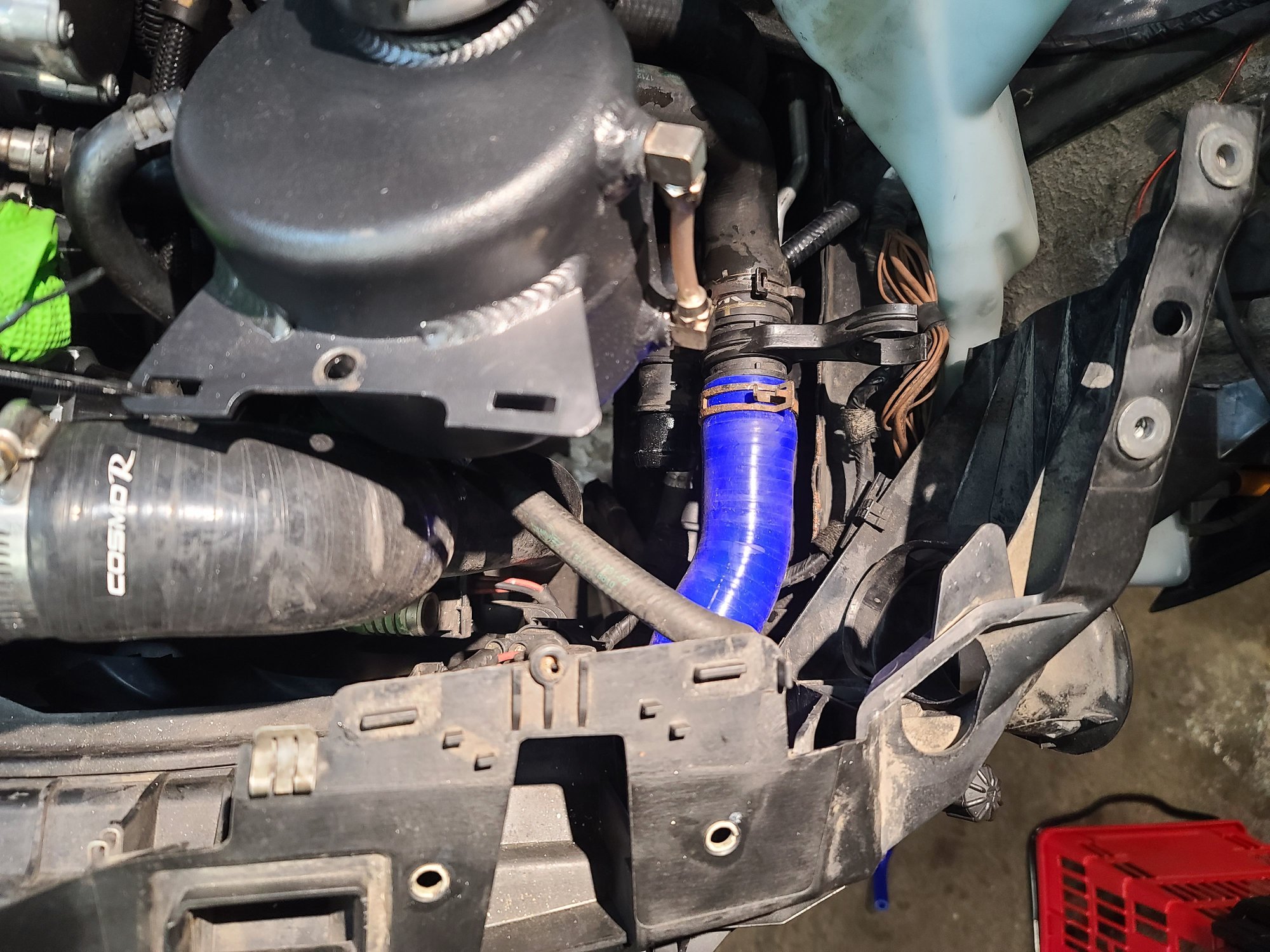

I'm halfway through installing the silicone coolant hoses and auxiliary oil cooler.. though the car literally just started to leak oil enough to drip onto the ground below it. The engine and transmission were COATED. Hollyshit !!! Pita cleanup.
instead of brakecleaner I found intake valve cleaner works 10x better at softening the caked on oil so it can be easier to clean up.
when i went to remove the turbo cooling pump ,i literally breathed on it and it broke , the plastic was SO brittle i cant believe it hasnt broken yet.
you ALSO don't need to remove your downpipe amd heatshielding ect , just remove a few bolts off the heatshield and bend it out if the way , then you get access to the 3x oil filter housing bolts.
unfortunately the oil cooler radiator is like 2x the size than i expected so either i need to section out the crashbar and bumper or just get a smaller cooler.
I've had no problems fitting the coolant hoses either. Not bad of a kit especially for 45$ shipped lolol. They fit better than the ecs hoses i installed on my buddies. I haven't had to trim or stretch a hose or anything. The ONLY thing though is some of the plastic fitting that go around the hoses to hold them in certain places 50% are fitting so I'm swapping those out for a zip tie clip.
