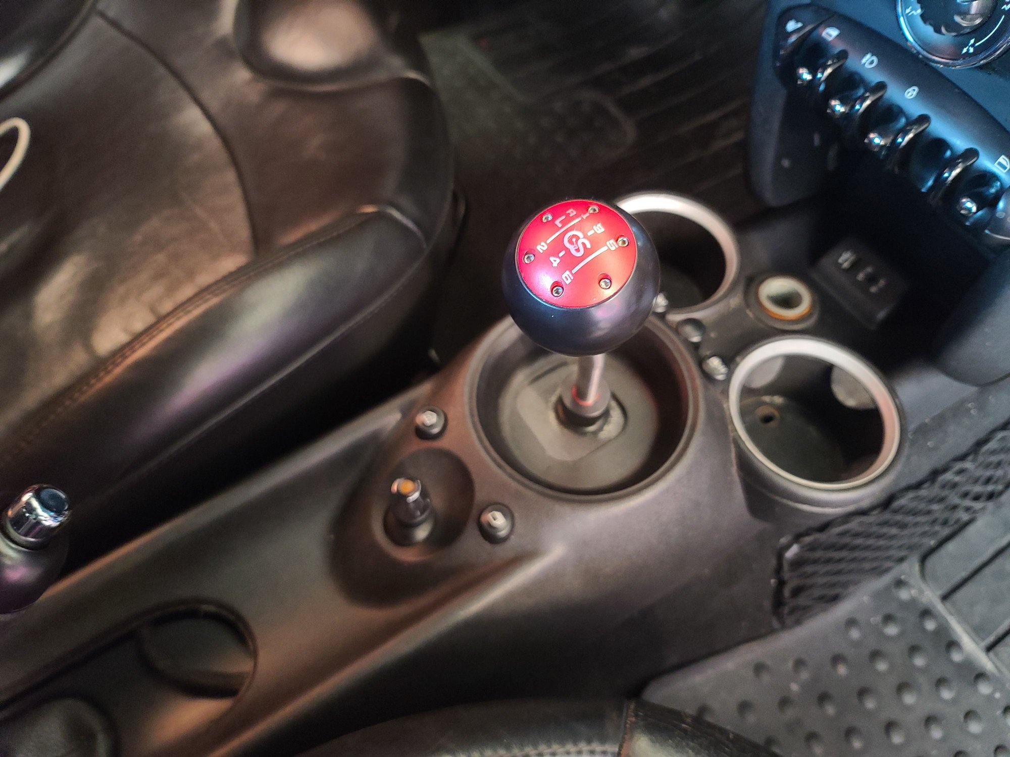

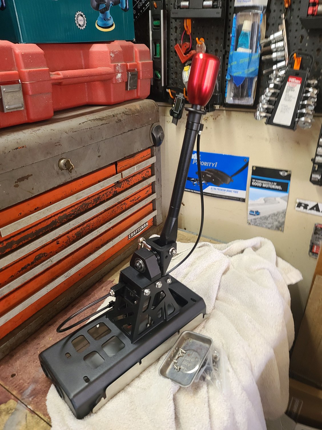

Aaaaaand i found the exact same shift light i had in an r53 i used to have ,so i bought it and that'll be here Ina few days and I will get that installed. I'm pumped because I like this shift light much better than the jcw shift light or any actually I've tried. Unlike the jcw shift light , this one immediately starts climbing the lights the second your on the gas where as the jcw shift light only runs from 4k rpm to what ever redline you set it to and when your ***** footing the car , the light does nothing then and that always irked me.
God, I'm even more excited to get the car out and enjoy it.. can't spring hurry up and get here already....
O yea ! And since it lost a little fluid removing the axle i decided to just do another transmission fluid change.

Here's that shift light when I had one in my r53..

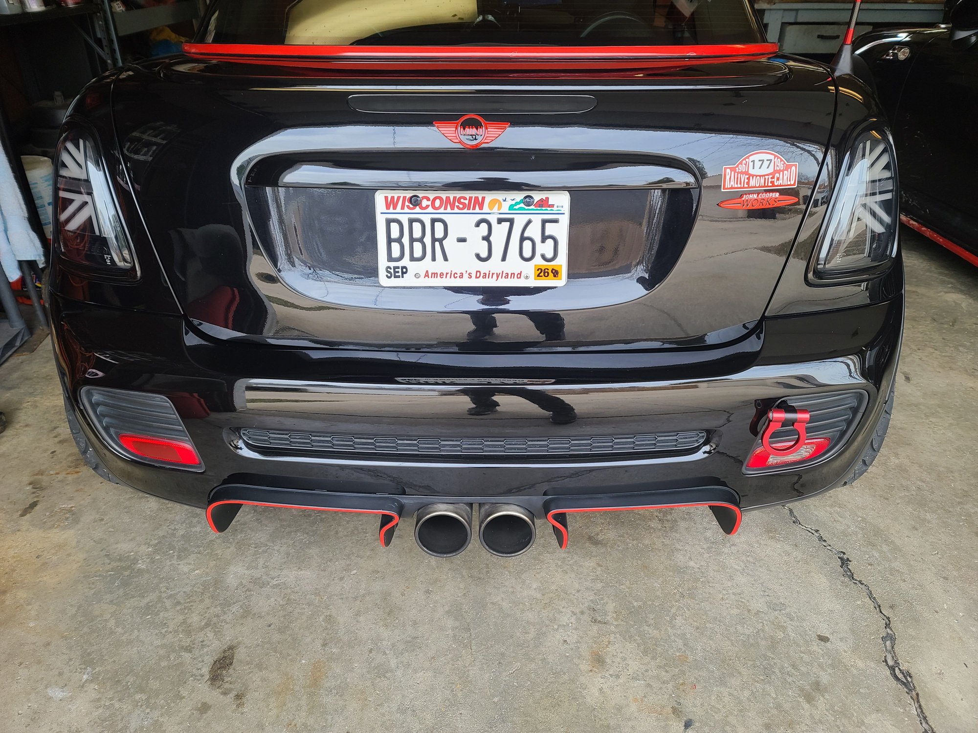

Took the car on a trip to Indiana to look at an r58 S because my brother drove mine last September and FELL IN LOVE and has been brought to the light ! He sold his 94' transam and saved up a little more but we passed on that S in Indiana and now he's on a flight to North Carolina to go I'm sure he will buy it because it's a Hella deal. A 2012 r58 JCW with 70k miles for 8500$ cash !!! THATS A DEAL IMO !!!
Well , I had a low oil pressure warning pop up RIGHT as I pulled out of my garage so I immediately pulled it back in.
i Immediately put it into partial front end service mode and my bumper had A BUNCH of oil residue in it and i found an an10 fitting must have loosed up a little during installation or from the trip to Indiana i just took. Lol i love these minis though even with these problems because any problems that ever arose for me the car has NEVER left me stranded. Well my r53 did ONCE but that way my fault.
I ordered and installed a new oil pressure sensor and upon restart after 30seconds the low pressure warning came on AGAIN. F to the A !
so now I'm thinking " ahhh crap , here we go again and another messy oilpump install " BUT after pricing a few oilpump it occurred to me , maybe I need to reset and clear the codes , which I did AND THEN thx Mr Cooper him self ! The engine is ok..
I found i had the towhook cover from my other r58 I'd owned and I drilled a hole in it amd painted it black so that the front towhook looks like that's more how it would look if it came from the factory that way. I will order a rear bumper towhook cover too and do the same to that , I'd like to have the covers still encase I ever decide to get rid of the towhooks.
aaaaaaaaaaand lolol the CAR PICKED UP more power too after fixing the oil issue , I must have set the wastegate a little different though I swear I did the same amount of threads ect. But lol I guess not because the car gets into boost so much better. And the wastegate can't be more than 1x thread different than what it was before. There is a sweetspot that needs to be found when setting up these aftermarket wastegates.

Had to replace a tierod end because tiresplus stripped the other one , the bolt that pinches it shut they stripped. So I gotta take it back to have the alignment checked, although I got it set VERY close by my self with the few alingnent tools I have. It actually drives pretty dang good but I'm still taking it back for tireplus to atleast check. I'd really hate to prematurely wear these tires I have.. very seldom do I splurge and get name brand higher end stuff..
I also did a flush mount for the rear towhook now too.
