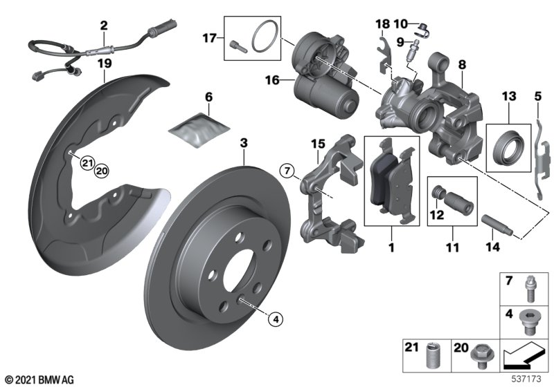

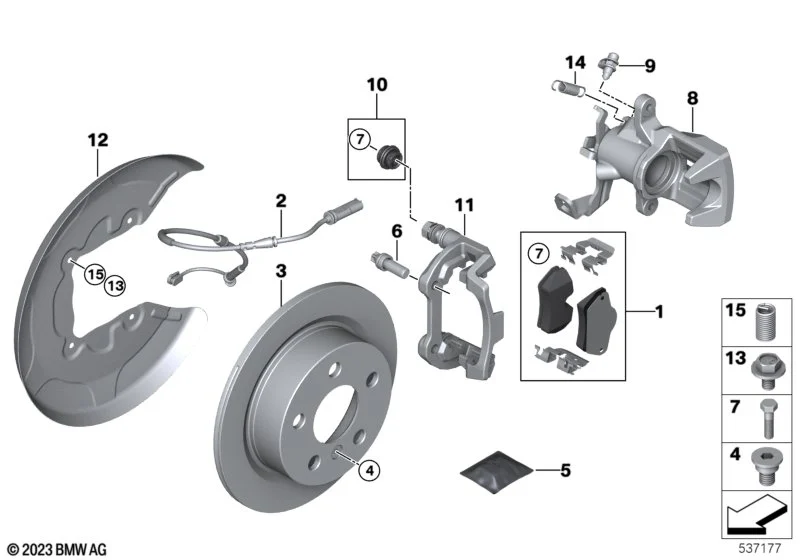

I always check https://realoem.com/bmw/enUS/select for OEM part numbers before buying any parts for my Minis. Even if I'm not buying parts direct from Mini, it helps know that I'm getting what I need. It an excellent resource.
Here are the two rear brake diagrams for your car:
Mechanical parking brake-
https://realoem.com/bmw/enUS/showpar...diagId=34_3047
Electronic parking brake-
https://realoem.com/bmw/enUS/showpar...diagId=34_3051

Awesome!!! Thank you so much!!
