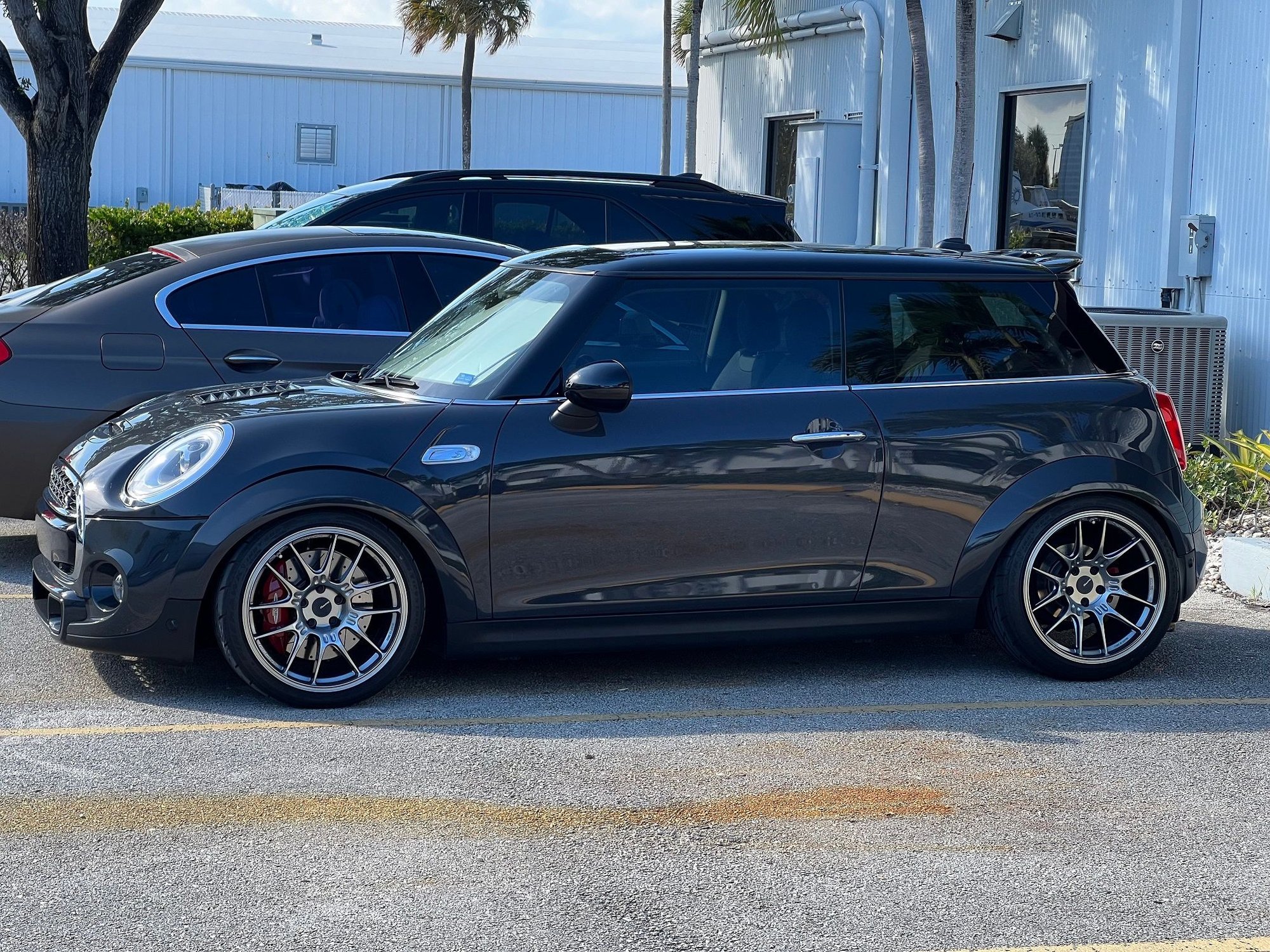

Vlad has been enjoying his new shoes about a week now. Gotta say I'm pretty impressed so far with the Yokahama Advan. Nice quick response to input, lots a stick, the ride is nice, they don't rub and they're quiet. Checks all my boxes I was hoping to check. Here's a few pics of the new rims and tires. Good news on the BBK front is I still have some more room to play with. Will see what happens when I get the 5mm spacers this week.

Looks great!

Thanks. They turned out better all around than I thought they would. I think I could have gone with a nine inch rim with these 245's and still been fine but rubbing on the lip is a deal breaker for me. Whats the sense in having a wider tire if you can't push it hard without interference.

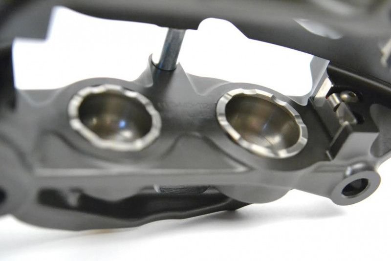

Holy thread revival Batman! Had a couple of people ask if I'm still tinkering with Vlad and has there been much progress. Which made me realize I was being a lazy twit before Covid sidetracked the world. Then other projects, remote tuning and my job in aviation really started sucking up all my time. To those that were left wondering my sincere apologies. I'll start bringing this up to speed. Hmm... where to start? I guess I'll start with the Reyland AP Racing big brake upgrade. This includes a 300mm rear disc that uses the factory brake and a CP4440 front brake with 330mm discs.
So before upgrading the brakes I figured why not replace the front and rear bearings at the same time. I went with NSK for the fronts and NTN for the rears. Had to order new studs as well since the old ones wouldn't budge.
Then it was on to the rear brakes.
Since the emergency brake cables have to be re-positioned you can expect to have to re-adjust your parking brake when performing this mod.

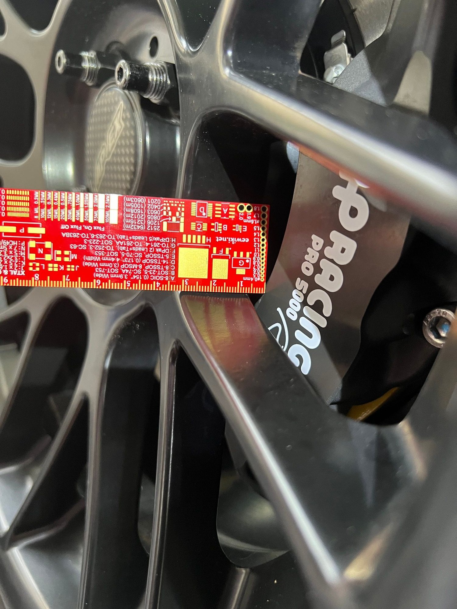

The rears have about an inch of clearance. Next up for the fronts I decided to install the GP2 heatshields to go along with the larger discs.
Pagid discs with Reyland floating bells for the front.
The kit comes with Pagid racing pads as well which are amazing when hot but scream like a banshee till they come up to temp. For street use I replaced these with Hawk HPS pads.
Clearance is still pretty good at 6mm.
That's it for now. I still need to cover the new meth system, audio upgrades, race seats along with other interior updates, gauge upgrades, new shifter, electrical upgrades then progress on the engine build, new clutch and turbo Vlad will be getting.
Happy Motoring

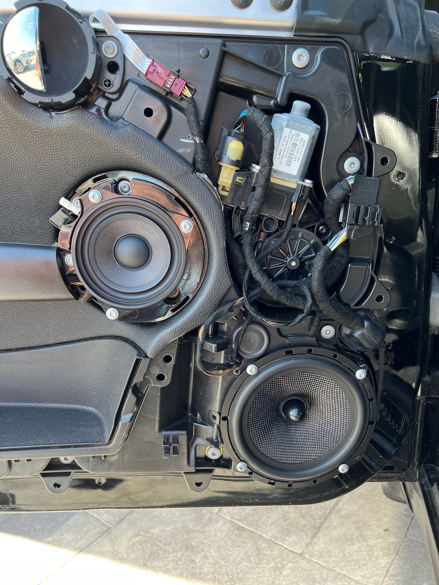

Since Vlad came with the JCW Brembo's the only factory upgrade was the GP2 brakes. Those are outstanding brakes and I had even gone as far as getting the GP2 clutch pedal actuator. But I kept looking as I wanted an equivalent or better level of braking but with better heat tolerance that would also reduce unsprung weight. I had finally settled on the Reyland kit out of the UK but Reyland couldn't sell direct to the US. Luckily, Orranje can sell to the US and they are a distributor for Reyland. Since it's AP there's a ton of pad choices and with the CP9440's castellated stainless pistons plus the thickness of the pad, the heat resistance is outstanding. Performed several high speed stops in a row with zero fade. The only minor thing of note is that being floating discs on the front you will get some low speed clicking sometimes or slight bump noise when going from reverse to forward. It's pretty minor though. When I pulled the original brakes off of Vlad I rebuilt them and installed them on Heinrich my 2013 S with EBC USR front and rear disc that I was using as a daily driver. Once spoiled on better brakes in the Mini I just couldn't deal with the stock brakes on the S. Here's a better pic of the pistons in the CP9440 brakes.
I looked at a ton of head units but really couldn't find one I was crazy about so I figured why not upgrade the speakers now and worry about the rest later. What I really wanted to do was order the Integral Audio system as lets face it, that system sets the bar for quality audio and clarity with a nice bit of thump. It's not an inexpensive system though so it came down to choosing between a billet intake or Integral Audio and well... Integral lost out. Plus I hadn't finished designing the new meth tank/pump mounting system and wasn't keen on having to cut the integral box to make it fit. So the search continued and I decided to try the BavSound upgrade speakers for the Mini while upgrading the 6.5" drivers. Here's the mid's that come with the BavSound. Pretty large difference in the size of the driver and I do like the high's the silk tweeters produce with the HK system.
I ended up choosing 2 Ohm CDTAudio CL-62 for the 6.5" drivers. The BavSound bolted straight in but CL-62's required fitting to the door and changing the connectors.
All in all I'm pretty happy with it. It sounds pretty good as long as I'm not mashing the go pedal too hard.

I’m interested in your woofer choice there…. My drivers side woofer has been making some nasty noises, which leads me to believe the speaker is giving up on life. I’d like to replace it with something better, but having the HK sound system in the car, not sure what to go with.
Old Sep 4, 2023 | 10:20 AM
  #367
Tigger2011's Avatar
Tigger2011
Alliance Member
Joined: Jul 2013
Posts: 1,474
Likes: 248
From: Sunrise, FL
The pdf attached gives you basic specs on the HK in the Coupe but the door and pillar speakers are the same in the Clubby. Technically a 6" driver would be closest in size to the original but I figured. Hey, while I'm in here I might as well.... and we all know where that leads.
The most important consideration is the resistance of the speaker. To work properly with the HK system amp they need to 2 Ohm units. If you install 4 Ohm you will loose a lot of output. I like the CL's compared to original. They generate more base but that's just an adjustment away.

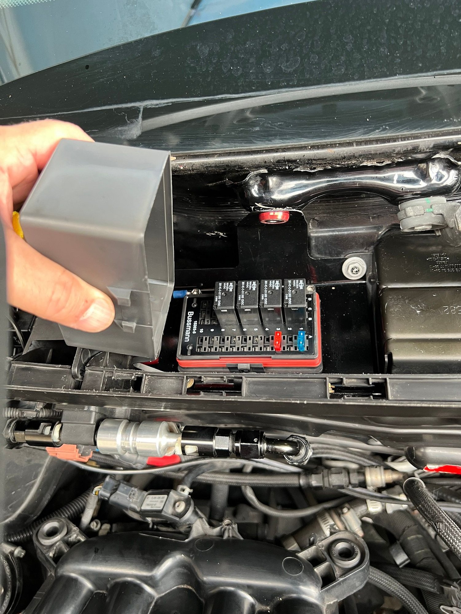

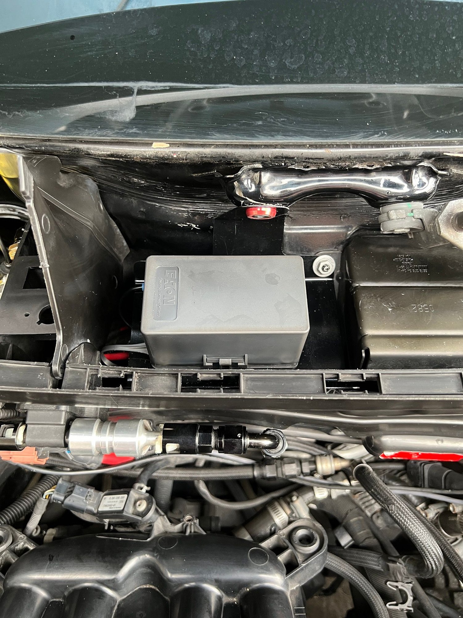

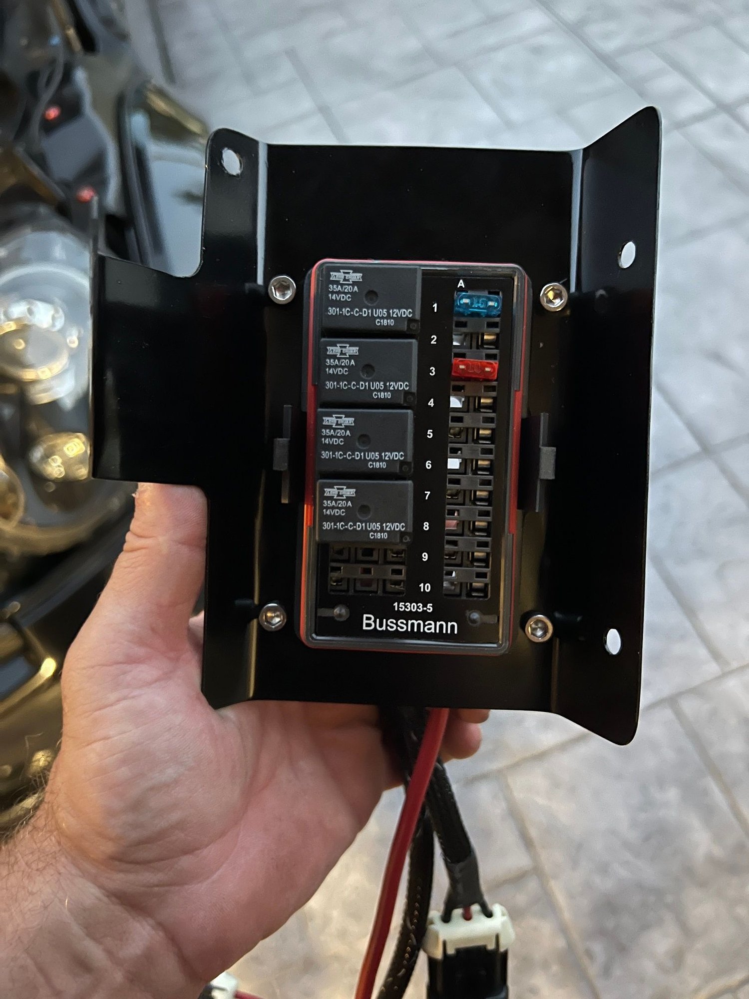

Couple of short updates. Wanted to clean up the electrical system. As I've added systems over time the underside of the dash had started to look a bit like a rats nest. Since there will be additional systems being installed later I figured a separate fuse box was in order. Currently the relays trigger off of terminal 15 but I may add some separate switches for some of them later. The biggest challenge was figuring out where I could squirrel away an extra fuse box in the Coupes engine bay.
This is the Bussmann relay and fuse panel I chose and the bracket I made to mount it once I had found a spot.
New home for the fuse box.
All buttoned up.

One of the reasons this has been such a slow burn project is I have way too many "squirrel" moments. I mentioned Heinrich the 2013 S I bought to daily. Picked him up with 30k miles on the clock in bone stock condition. I really did plan to mostly keep him that way but.... well you know. Squirrel > and off I go.
This is him when I sold him recently. OCZ HLT4 powder coated Porsche silver, Swift lowering springs, JCW brakes w/stainless brake lines, EBC yellow pads with EBC USR rotors, Recaro seats and scorpion exhaust.
Sold him to pick up Ollie a garage kept 2014 F56 S with 20k miles that belonged to a client of mine. Ollie will get his own build thread though.
