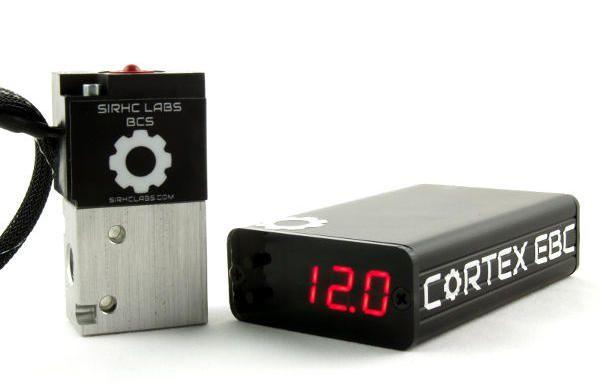

On the tuning front Nick is working on the standalone boost controller version of the tune for the X51. I'll be using a Cortex electronic boost controller purchased specifically for this phase. There are a lot of boost controllers to choose from but the Cortex EBC has some really nice features like multiple profiles and map by gear.
The boost by gear allows you to set boost limits and curves for each gear using 3D maps which gives you a great deal more control when it comes to fine tuning the boost curve. This is the forth gear setting for profile #1 for Vlad.
One of the nice things about a system like this is gives you the ability to create multiple profiles for each map. You can create a profile to have fun with, one for the track to maximize traction, one for wet weather or even a valet mode. It creates all kinds of possibilities.
