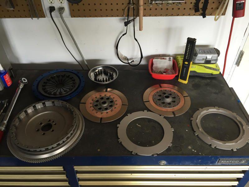

Had some spare time so I finally got around to installing the new clutch and LSD. Babying the factory clutch so as not to smoke it was getting old. I used an engine support bar and skipped putting it in service mode.
All the other usual stuff applies (remove exhaust, subframe, suspension etc..). Went ahead and dropped the oil pan to replace the factory rod bolts with the ARP and learned something new in the process. The N14 engine oil pump is not ECU controlled like it is on the N18.
I know some have used a pry bar to keep the flywheel from turning during removal. I just used the alignment pin from the cam kit.
The old clutch was pretty low mileage so I expected it to look decent from the outside and it did.
Next up was taking a peek inside. A few hot spots which was expected and there was a lot of material left on the disc.
Since I had weighed the OSG I figured I'd see what the complete DMF clutch setup weighed. Thirty six pounds even, so OSG shaved 21% off that and doubled the torque capacity. Nice work from our friends in Japan.
Next up was splitting the transmission, inspecting the teeth, cleaning the permanent magnet and installing the Wavetrac and putting everything back together with new bearings, input shaft seal, pivot pin, guide tube and fork. The old fork had a small crack in it so having a spare came in handy.
Next up was pulling the OSG apart. Note the discs on the STR twin are solid. Having solid discs with a SMF can sometimes cause gear rattle at low RPM or at idle with the transmission in neutral and the clutch engaged. Without the mass of a DMF or a sprung hub individual engine pulses can cause the gears to couple/uncouple causing a rattle.
Here you can also see the intermediate plate that floats and separates the two discs.
Once the OSG was apart I was able to measure the flywheel thickness and am happy to report that on the STR2 it is the exact same thickness as the factory flywheel. So no monkey motion with cutting new factory flywheel bolts is required. Just bolt, torque, apply 90º and your good to go.
One piece of advice if considering the OSG twin. Order a spline alignment tool as it does not come with one. Unlike a single disc, the splines on both must be aligned perfectly or you will have fun getting the input shaft to go in. I ordered one over two weeks ago and it never came in. This required leaving the cover bolts loose, sliding the transmission in then back out, snugging the cover bolts and sliding the transmission in and out one more time before torquing the cover bolts.
Once everything was back together I went ahead and put in a new slave cylinder and swapped out the brake lines with new braided steel ones. After that I flushed the system with Torque RT700 brake fluid. It has a very high temp limit and the specific gravity of the fluid is higher than any other I could find. In braking applications it is touted for its fade resistance and improved pedal feel.
Full metallic clutches don't need much in the way of break in but I plan on putting about 500 miles on the clutch before beating on it. I've put about 50 miles on it so far.
Initial Impressions:
1. This is not a clutch you need to be afraid of. The engagement window is only slightly narrower than stock and the pedal pressure is nearly identical. Engagement is smooth and pulling away from a light can be done with as little as 1100 RPM.
2. Twins usually produce a ringing or rattling noise when sitting at a light with the pedal depressed. This one does as well but its very quiet. I can hear it with the windows down but if they're up and the AC is on I can't. Kinda sounds like chimes more than anything else.
3. No gear rattle at idle or low RPM...yeah. I was prepared to use a mixture of Turco SGO 70W and 140W if it was an issue. Happily that wasn't necessary.
4. All in all the clutch behaves itself very well and is a breeze to drive on the street. The only unusual behavior noted at this point is some clutch chatter when downshifting without rev matching. It will be interesting to see how this changes during breakin.
5. The RT700 combined with the new slave cylinder has almost completely eliminated the soft spot at the top of the clutch pedal and brake pedal feel is definitely improved.
6. I did get a chance to hit some twist's and turns with the Wavetrac. It does not fully lock like the OSG LSD but it seems to transition much more smoothly and makes the car very neutral.
