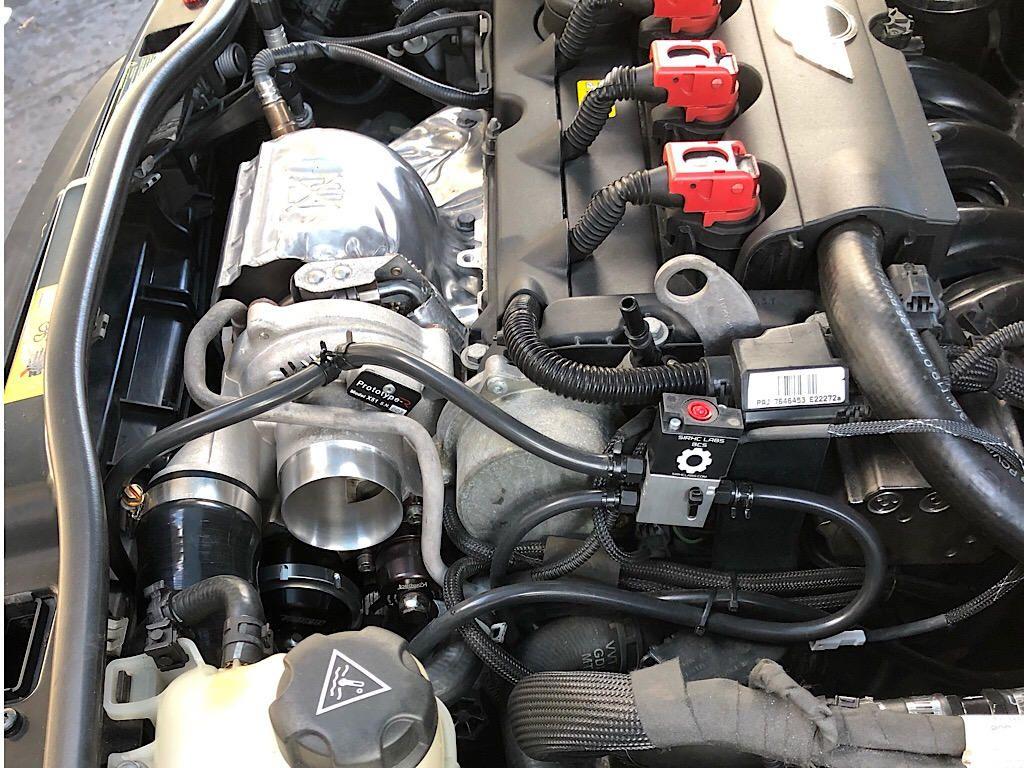

So far I'm absolutely loving the Cortex EBC. No more boost spikes as the turbo comes up to speed and I have full control over when, how and how much boost to run. Both ports are now connected to the boost solenoid which I temp installed while I make a bracket for it.
Thought I'd post some how-to info to help others that might be interested in running an EBC. The Cortex really only needs three connections other than power to function. Boost input via a port tap, throttle pedal input (TPI) and RPM input. To use the boost by gear function you also need a vehicle speed signal (VSS) input. Below are pin outs and diagrams I put together.
First up the ECU with connectors. We're only interested in the forward and aft connectors. I used posi-taps to tap the signal lines and feed the Cortex.
X60004 is where you pull the signal from the throttle pedal module
You can tap either pin 34 or 35. I tapped pin 34.
So now that the boost controller knows how far I have my foot into it ;-) it needs to know current RPM. For this signal I tapped into the ignition coil signal from the aft connector X60232.
You have four pins to choose from but it doesn't matter which one. I chose pin 10 which was the easiest for me to get to.
Since I already had a boost gauge I just put a T fitting to tap the silicone boost line to the Cortex. At this point I had a functioning boost controller but no boost by gear yet without a VSS input. The Cortex compares vehicle speed to RPM in order to know what gear your in. Cortex has several way to tap into a VSS signal so I chose the least expensive option which is a speed sensor adapter.
This takes input from a Hall effect or variable reluctance device and converts it into a signal the Cortex can read. Since we have Hall effect ABS sensors I thought this would be perfect and tap into ABS module connector. A little digging around convinced me this connector was not the way to go as BMW hung the ABS module in the air and built the car around it. Plan two involved tapping into the ABS sensor lines between the connector behind the left front wheel liner and the ABS module.
Unfortunately, the BMW wheel speed sensor operates at a much lower voltage than most other vehicles. Normally the pulsed signal is between .5 volts at rest and up to 1 volt as the teeth pass the sensor. Our sensors generate .34 mv at rest and approx. .500 mv at 45 MPH. So the speed sensor adapter was a bust. Luckily, they make a CAN-BUS adapter that connects to two wires of the OBD port that can take the OBD signals for RPM and VSS and convert them into a signal for the Cortex. So I ordered it and it should arrive this week. Right now I'm running with boost limited to 21 psi as a compromise till I can configure the boost by gear setting. Had I bought this first I could have passed on tapping the ECU coil signal and just picked it up from the CB-2 adapter.
The Cortex also has several other built in options that I'm currently not using. For example it has two other output signals that can be used to control the activation of things like water meth injection, a sprayer for the FMIC or even nitrous. Now I need to fab a bracket for the controller itself. It's currently tie-wrapped to my boost gauge lol. Now they also have options for a 52mm pod display. Wish they had that when I bought the system back in January. But the E85 gauage will be going in that pod so I guess it worked out best this way.

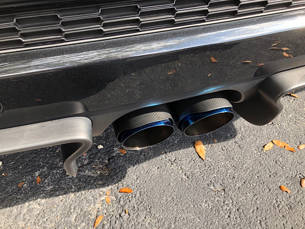

Meant to post this earlier when I removed the 18" Magnaflow and installed the 16" Thermal R&D muffler. Instead of reinstalling the 4" carbon tips I went with 3.5" carbon/blue tips. I need to get some audio clips up but here's a pic of the tips.

Old 12-26-2017, 11:54 AM
AWD_Rally's Avatar
AWD_Rally
AWD_Rally is offline
Moderator
Join Date: Mar 2011
Posts: 717
Received 40 Likes on 34 Posts
Nice! Those look awesome.
