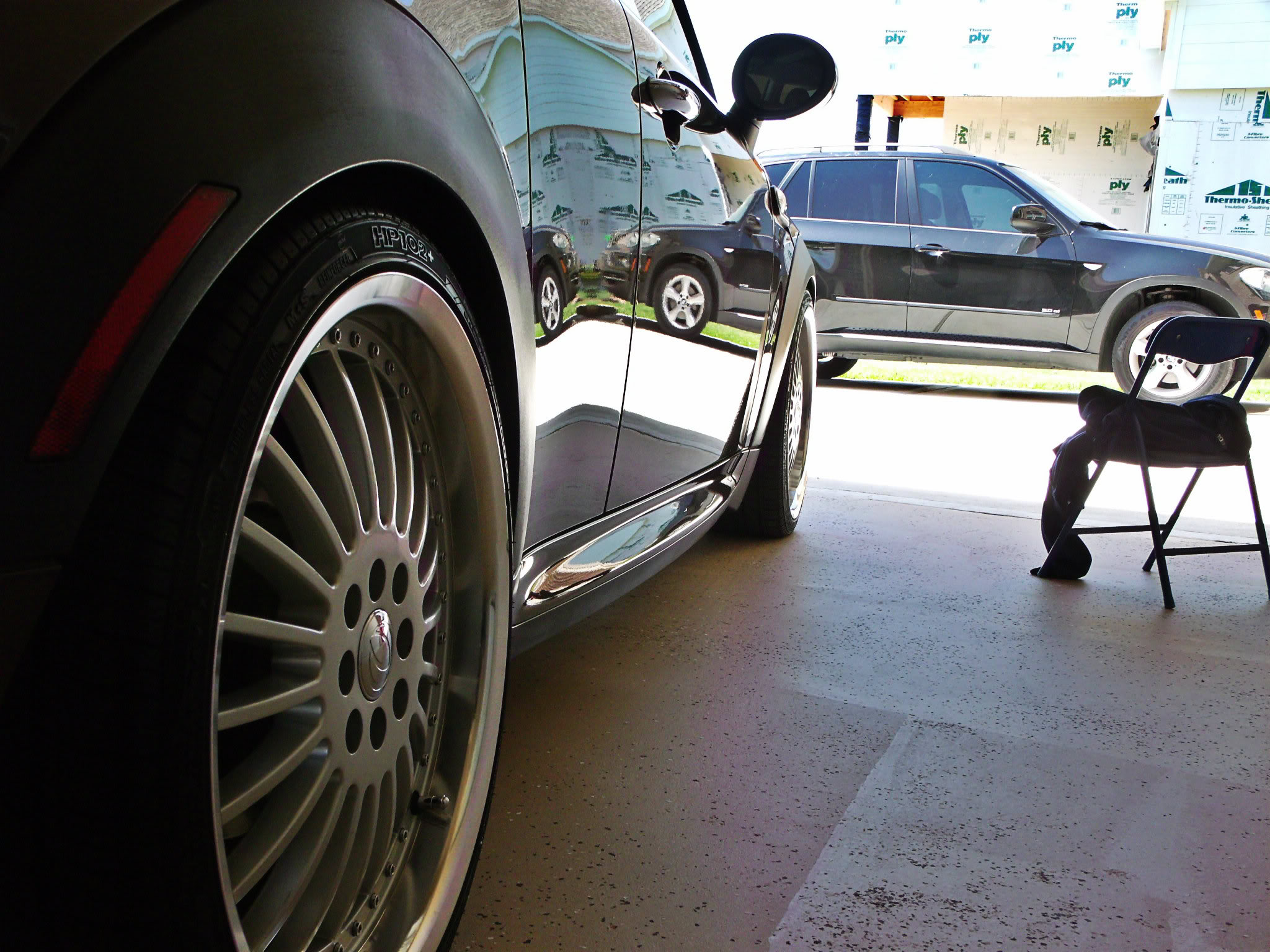

Thanks for the help. i did a test fit today and that setup will not, I should have known because my last set was 18x7.5 with et38 and they were right at the fender.
