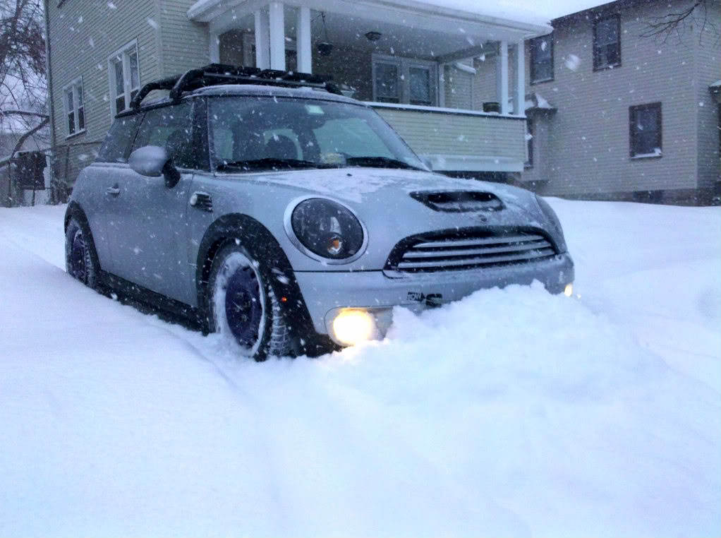

Blizzak WS70 are the snows I have been using. I don't really have any pictures that show the tires in great detail.
Here's my car plowing the driveway though:
Also for comparison sake:
Tread depth:
Most summer tires - 7/32 through 9/32
Blizzak WS70 - 12/32
BFG All Terrain T/A KO - 16/32
I overstated it with my two to three times claim. But it is also just as much about the rubber compound and tread pattern as it is about the tread depth.
