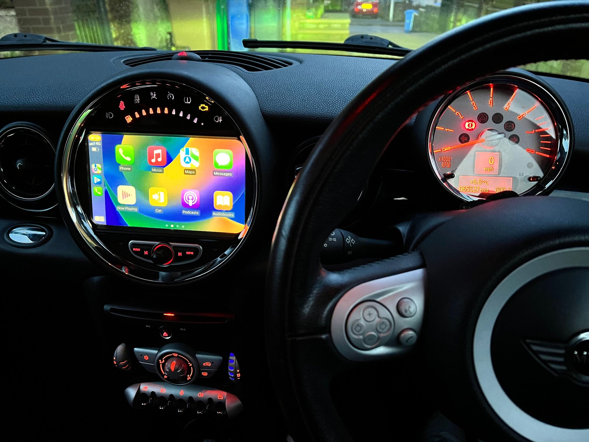

Eventually got around to installing my new android headunit in my car- upgraded the centre console to the LCI and swapped over the manual aircon to LCI black controls as well.. (couldn't find the exact LCI air con controls I needed - so the new one is missing the switch for the front fog lights - but will do until I can find the exact unit) - overall, very happy - sounds amazing compared to the stock unit and wireless carplay works flawlessly... currently waiting on a OEM USB port arriving and then I'll be swapping out the factory AUX port for a factory USB port linked directly to the new headunit (the other USB cable from the head unit has a DAB tuner connected):

I’ve been really happy with the unit as well! - just wanted to sort the usb cable dangling down with something more factory looking! 👌🏻👍🏻

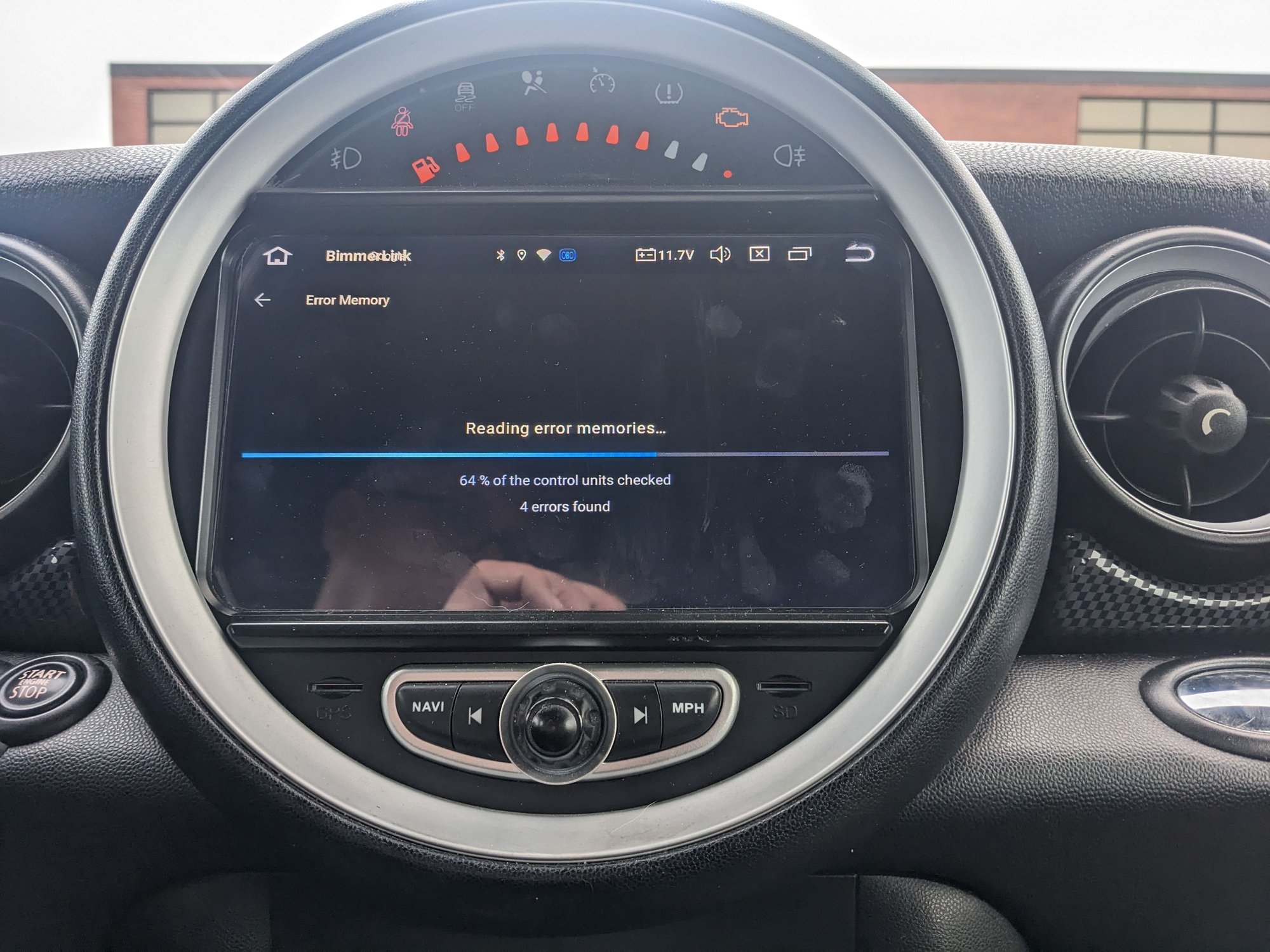

Also using the K+DCAN cable and having Bimmerlink installed on it, I always have my scan tool with me. Threw a code yesterday, plugged the K+DCAN cable into the ODBII port and USB in the glove box, opened BimmerLink, read and cleared codes. Looks like I might have a cam sensor going out.
The only thing I haven't confirmed is setting the time on the Mini. I haven't had an issue from it but, I know some spoke of it in the link above.
I also put my phone in hotspot mode and can email the results to myself from Bimmerlink. When I get where I can look up the errors I use bmwfault.codes to see what it is and possible solutions to the problem.
