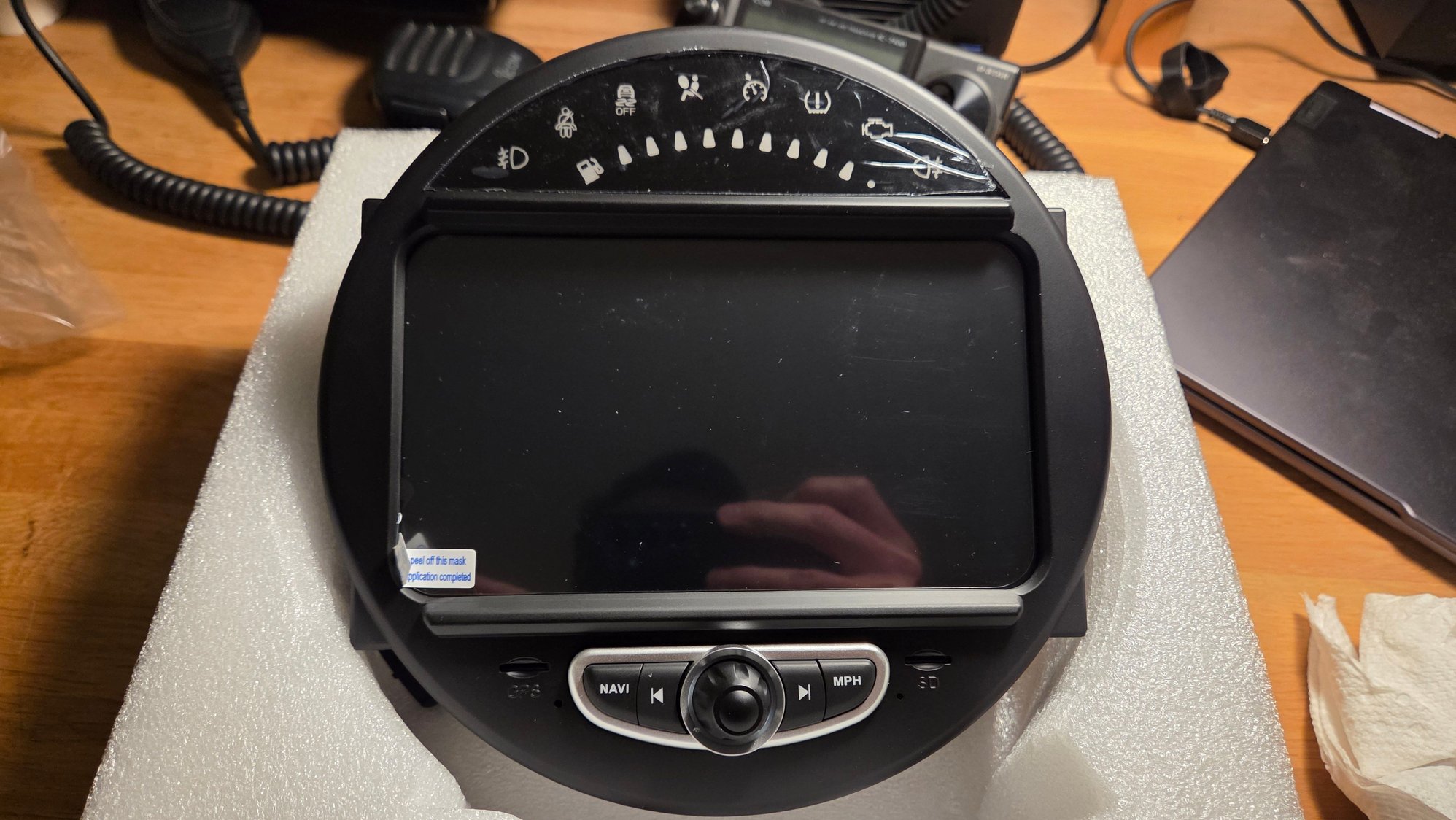

Hello Mini Community. I just installed the Android unit from CarNaviPlayer in China. It's only been 2 days and so far it's great. What a huge difference. I had the base system (no HK) and no nav. So really anything is a big improvement. I watched many of the videos on YouTube which were very helpful. Note that the early versions used the CD player as the "hub" and the screen was secondary to that. Now all the connections occur at the big screen and the CD/DVD player is secondary. You actually don't even need it. I included it as I didn't want to have an open space or non functioning device (you should get the later center stack bezel as the locations are different for the CD player). Works great with the Android phone. The on board nav is perfectly fine. As far as inputs, you get two USB A whips and also a micro SD card slot on the face. I have a 512GB card in that which plays my MP3's. I installed the GPS antenna on the glass windshield running the cable via the headline and weatherstripping at the A pillar into the removable dash sides. I did the same with the microphone. The 4G / Bluetooth antenna is installed in the center stack directly behind the HVAC controls. The stock harness plugs into the aftermarket harness so no splicing. I did remove many of the wires and RCA connectors from the harness I knew I would not need. I did not hook up a back up camera (yet the screen switches to backup camera mode no matter what when you go in reverse, need to figure this out.). I am going to try a new music player for the MP3's tonight as the main screen stock player is not the best. The manner in which it sorts and organizers the music is very clunky. You can log on to your home WiFi to download any apps you need. It's very easy. You can change the wall paper to whatever you like.
As stated the directional audible sound from the tiny speaker is weird. It does not give you a sound for "you left the keyfob in the ignition" anymore for some reason. Seatbelt alarm chime does still work.
Of note is the lag from starting the car to unit up and running is about 30 seconds.
I will review some more over the next few days.

As a quick follow up, the Musicolet app is vastly superior to listening to MP3's you have stored locally on a USB jump drive or Micro SD. It is a big improvement over the music player on the home screen of the CarNaviPlayer. I tried Poweramp which I use on my phone but it was not suited for the car. Plus it has a small fee for the app.

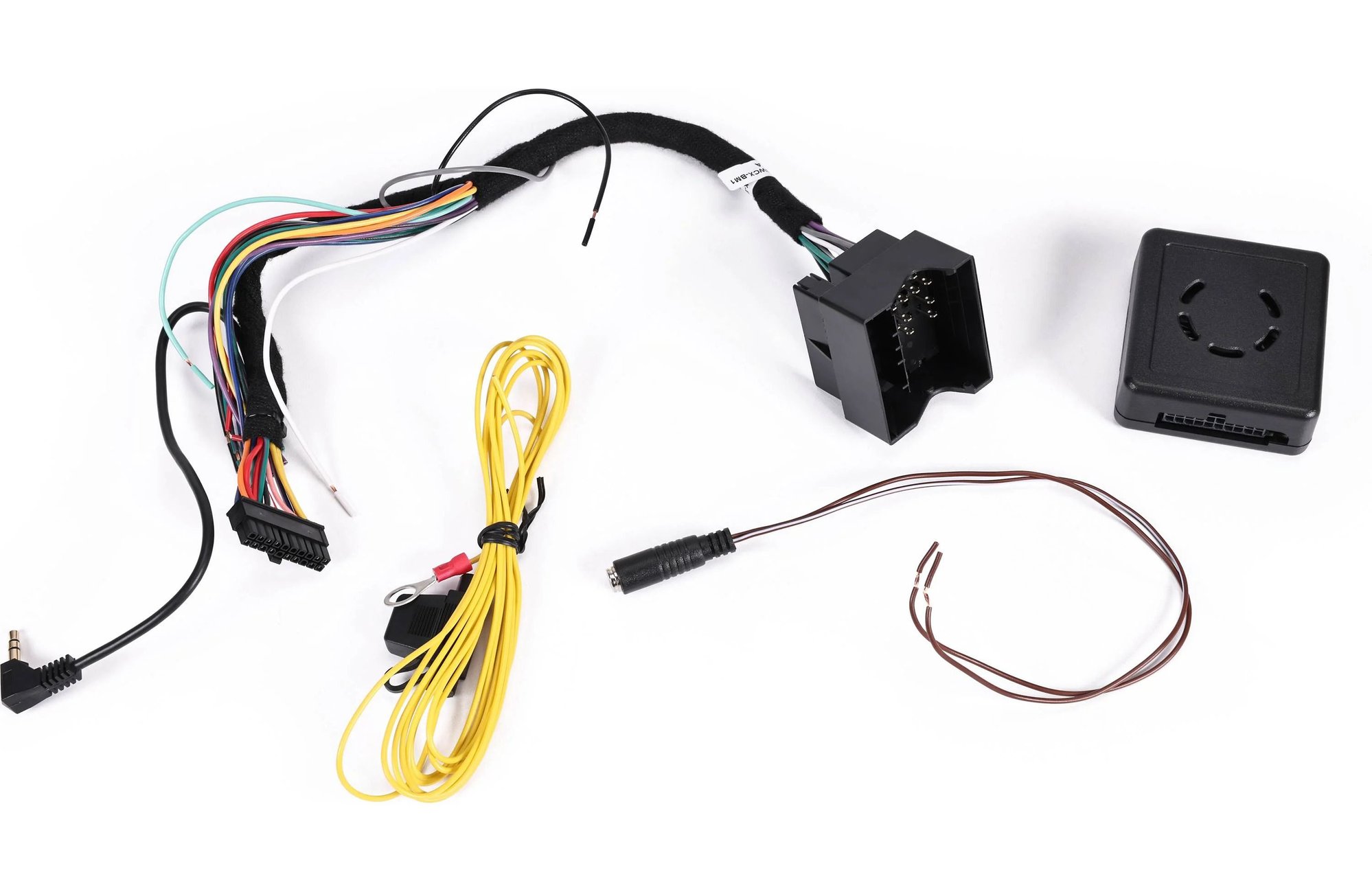

As I had no plans to use some of the wires, connectors on the harness, I unpinned them from the connectors. This included 3, 4, 5, 6, 7, 14, 15. The connector for 20, 21, 22 could be removed entirely for me (manufacturer agreed).

I think what I needed to do was take better picture of that main connector to determine which pins were being used and/or had wires in them.

To follow up.....I have confirmed the stock MINI wiring does NOT provide constant power to the new HU. My MINI times out at 30 minutes. I need to provide proper consistent 12V+ battery power.
I found an option in the radio where you can adjust standby (not turning completely off) up to an hour which is handy when driving around running quick errands. I also confirmed the radio will retain the time providing the HU receives constant battery power. What is nice with this feature is that when you come back to the car, the radio starts instantly.
