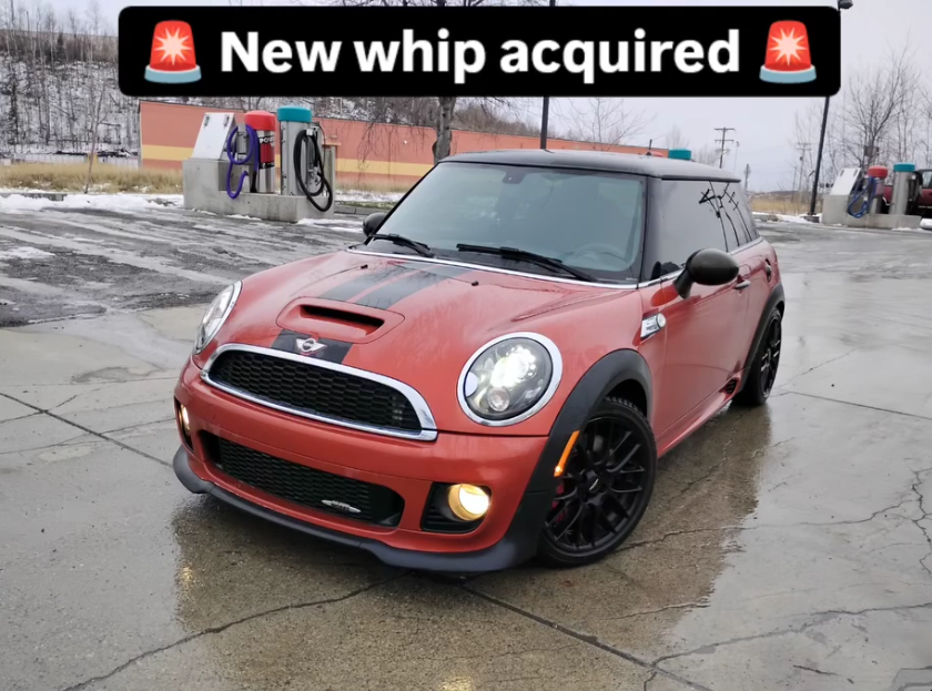

I'm sorry, I still haven't posted a picture of my car. I'll do that here since I have it on my computer now. (Note, I re-screenshotted this from the Instagram post I made when I bought it, that's why there's a caption)
One of the problems it had when I bought it was a leaking front damper, however judging by the way the front end floats and bounces over bumps, neither corner is great.
