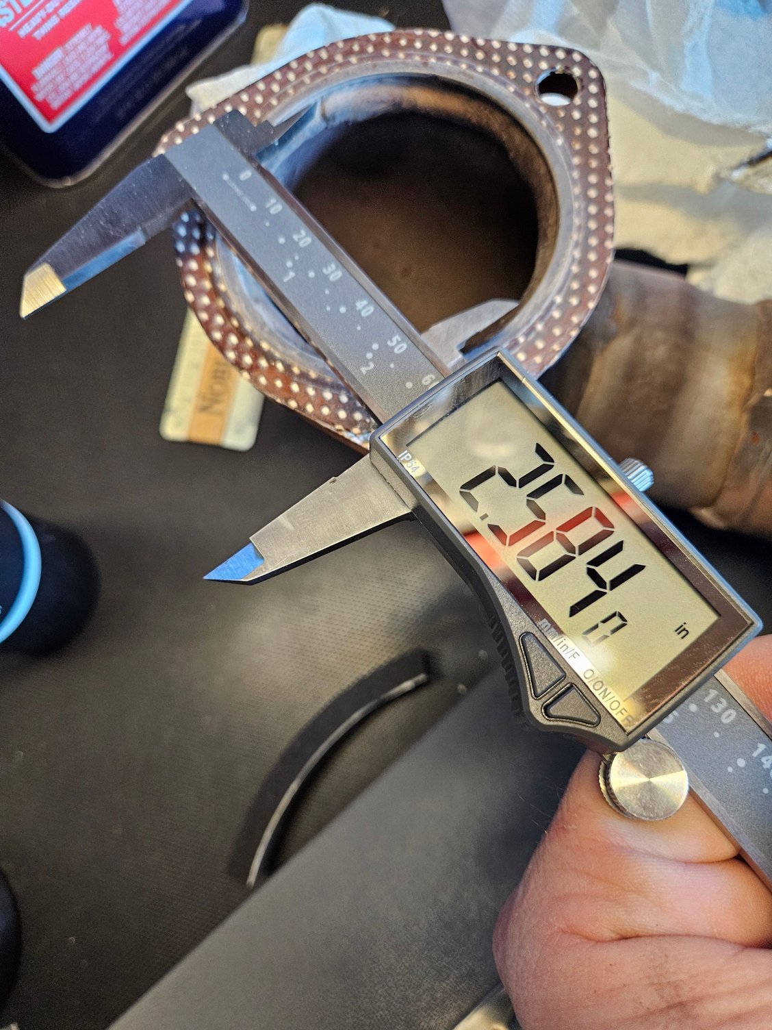

To go back and answer some questions. After clearing out some other issues when I got the head off, I'm finally ready to put the car back together. I bought the Magnaflow Cat because their customer service said it was 2 1/2"...
well... it wasn't. The exact thing that I was concerned about to begin with is exactly the issue here. The parts are made to Cooper S specs and sold as "fitting" all N14 models. This just isn't the case and if I actually mounted this thing, I'd have backpressure and turbulance and probably premature turbo failure.
So here I am tracking down a part that fits.
Here is the OEM downpipe/Cat
Here is the Magnaflow (notice the insanely shitty build quality to boot)

I do not think it is made to the S specs as I think my stock S DP is the same ID as yours (I will measure when I get home).
I think it is just aftermarket is garbage unless it is more performance based and custom made.
