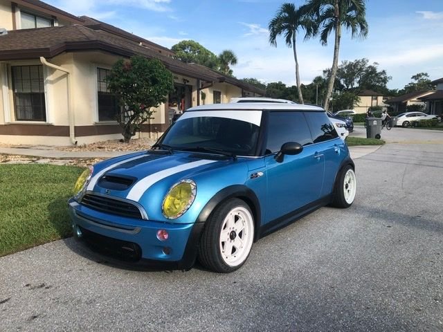

Here is a pic. More pics to come and I’ll post here with any new issues, repairs, or modifications. It’s the summer in FL and the A/C seems to be working great, (knock on wood) so that’s extremely important.

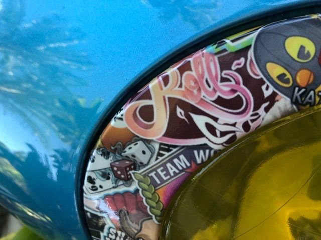

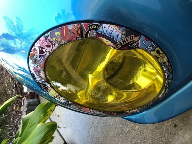

Took some closeup pics of the very interesting vinyl wrap on the headlight surrounds. Haven’t gotten around to seeing the best way to peel it off
Well that's...different.

Also known as "sticker bomb", the idea behind it is a lot of small sticker overlapping, but you can buy it as one piece nowadays.
kinda looks like flowers around my headlights from 10 ft away. But I’m sure the headlights are in rough shape underneath the stickers and yellow. Do I really need specific headlight restorer product or can I take abrasive polish to them with my random orbital and then follow up with some sealant wax to keep the restored look?
