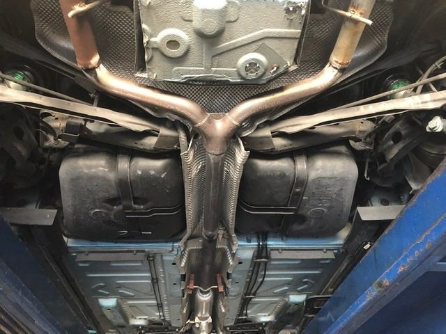

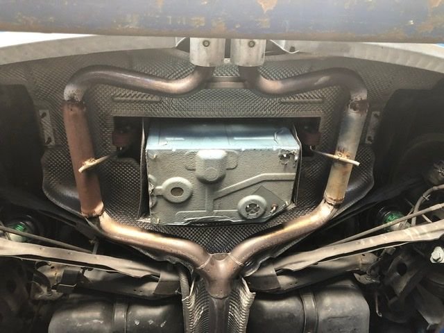

Had a shop put in a “turbo” straight muffler where the stock jcw resonator used to be. Cut down on the overall volume and drone. But did get rid of most of the crackles and pops. Which were cool but sometimes a little too loud also. Has a decent deep tone still.
Still no mufflers in the back. I’ll get some sounds clips soon. Pretty happy with the result though. Still a sporty nice tone and volume without being excessive.

Got some in car video of the new exhaust setup. Doesn’t sound like a race car now, but much more daily drivable. It’s still pretty loud.

straight muffler
Almost looks like an old school glass pack ("cherry bomb"). Sounds pretty good, would have thought it would be a lot louder but maybe it's the device you're recording on, not sure. How's the 25mph neighborhood 3rd gear drone level?

If you watch the other video I posted, that droned A LOT.
This has a deep tone but the drone has been cut to maybe 1/4 of what it was. It really was dump truck sounding before.
the guy at the shop showed me a flow master and magnaflow straight through round can mufflers. With holes inside. Pretty much looked like resonators. The muffler I got was a “turbo” muffler he said. Kinda bends inside and still has the resonator looking holes throughout.
If I end up wanting to change it down the road, I would probably buy my own 2 stainless steel rear mufflers that resemble the jcw setup. And put a higher quality resonator in the spot where this current muffler is.
if there is a good sale on a nice aftermarket system someday, I may just go that route.
If this were back when I was in my college years, I would have kept the straight pipes and probably gutted the cat and tried to shoot flames. Different times. Lmao.

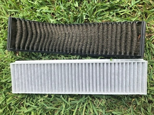

Glad I got around to changing the cabin filter. I wouldn’t be surprised if this is the original filter.

Ow lord, it probably was
Looks like it needed a shave too.
Can't wait to see what the original engine air filter looks like (and just you know it is the original...).

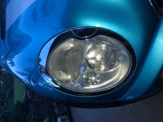

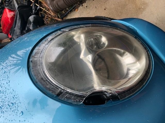

Got around to removing the vinyl stickers the previous owner had on the headlights and the yellow film. Then buffed the headlights with a random orbital and some meguiars cleaner wax because it’s all I had laying around. Worked pretty well. Did a before after at dusk with the flash.

Sticker bomb removal was the right choice

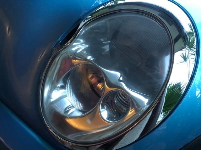

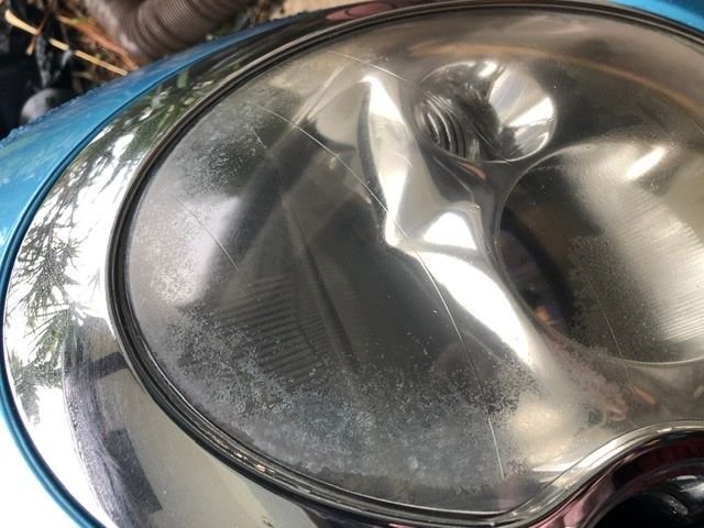

I also used the 3M headlight restore kit on my lights yesterday. Came out pretty good.
Before the restore
Before the restore
Removed chrome trim ring on the headlight with the broken washer

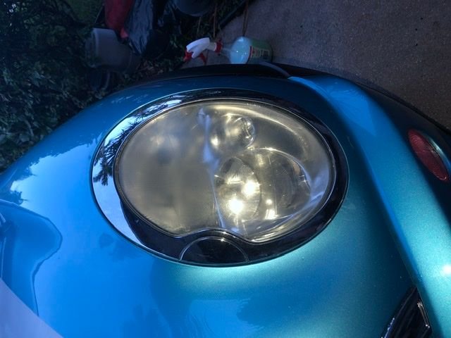

Taped off the other light
End result after restore.

Looks very good, well done
