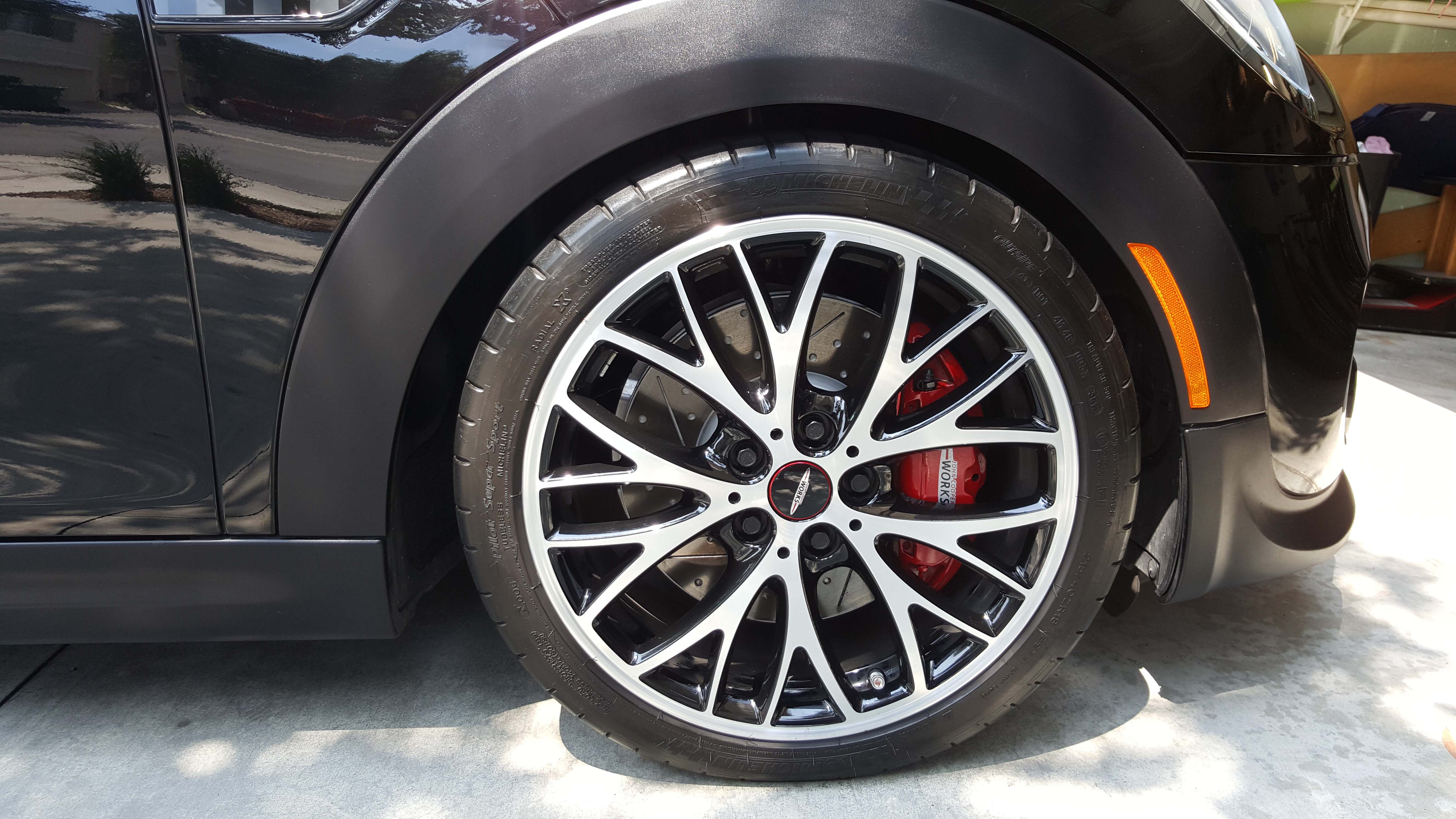

I am happy with mine. They're not cheap. but IMO well worth the price. While you're at it, you need to install braided stainless lines too. That will eliminate the sponginess that some people have experienced with the stock rubber brake lines. I used the lines from NM.

Are those NM wheels?
