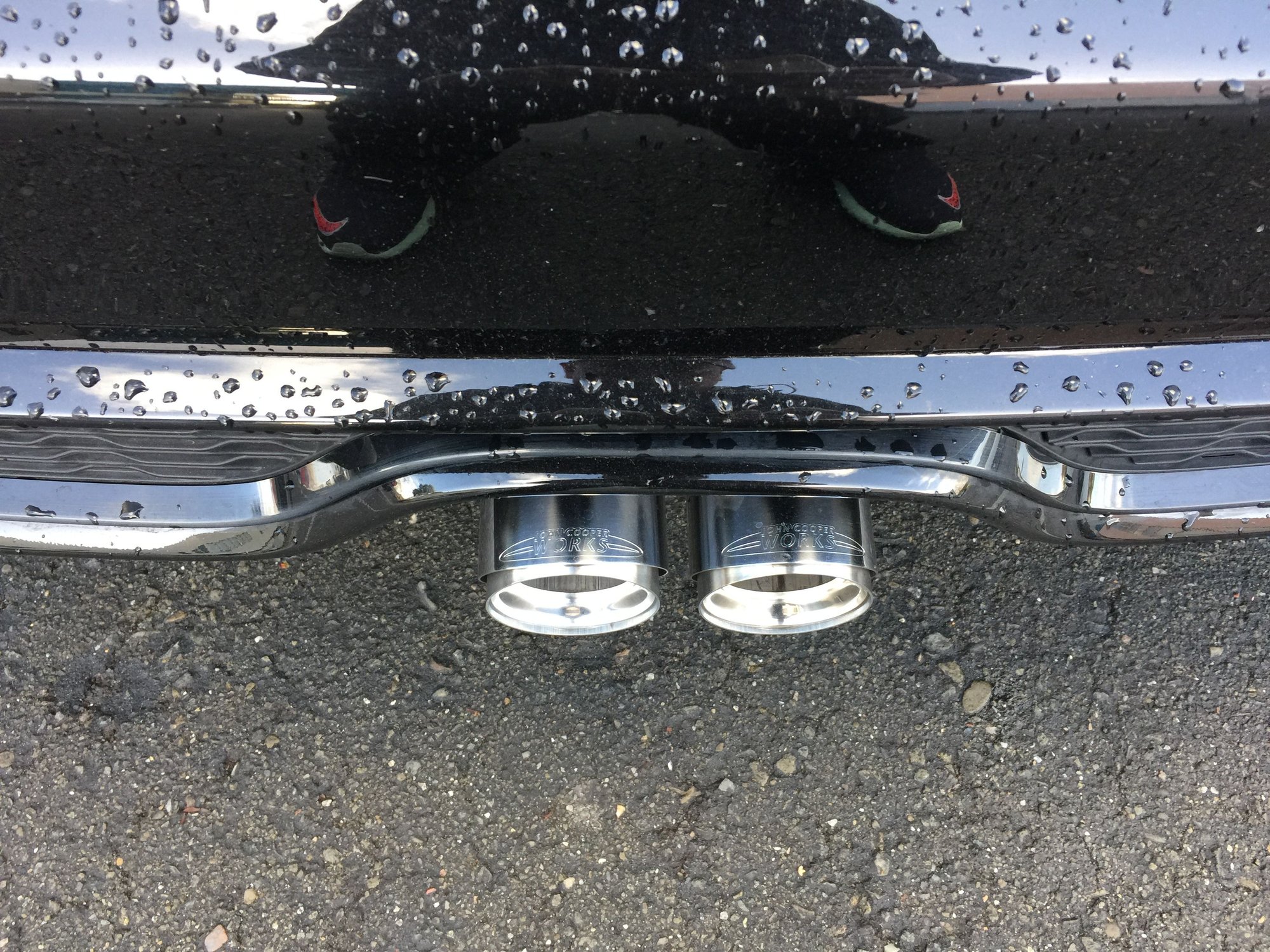

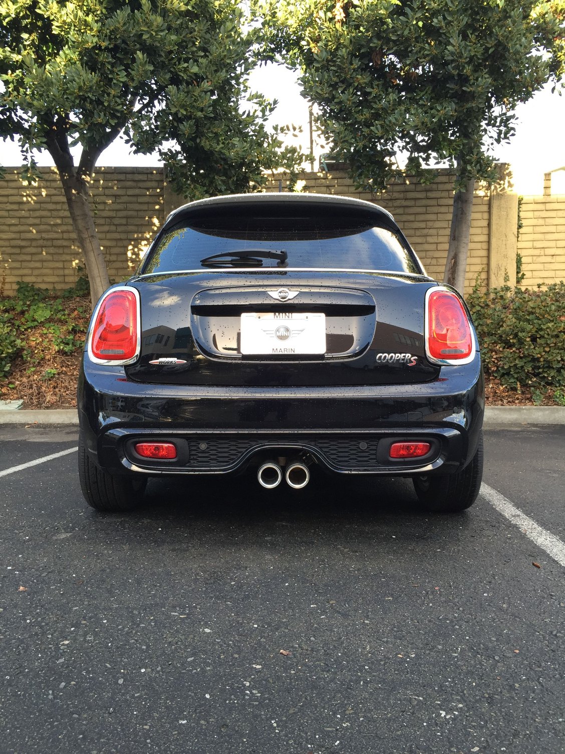

I would like o add one question, and that is how far out are the tips of your exhaust. The dealer installed the JCW PRO Exhaust and left the tips way in, so I had moved them a bit out. Trying to align it to the end of the bumper.
Can you post pictures of your exhaust tips relative to the bumper please?
TY!

Technically the dealer is supposed to install them "way in" as you say to avoid burns. As you have discovered, they are not too hard to adjust to pull them out if you want to. Here is mine:
http://www.motoringfun.com/wp-conten...1/IMG_0973.jpg

Would have preferred it a little more higher, than out.
Old Mar 23, 2016 | 08:11 PM
MoJo4Twenty's Avatar
MoJo4Twenty
Joined: Mar 2011
Posts: 151
Maybe half an inch higher would fill the gap in better. Saving up for a Jcw diffuser but need the Jcw rear as well. That should fill he gap even better!
