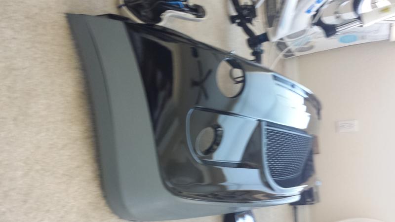

Here is a picture of my bumper.
Attached Thumbnails Am I going crazy?  Some JCW bumpers didnt come with the front turn indicators...-20150528_192509.jpg
Old May 28, 2015 | 07:00 PM
Manny_cooper's Avatar
Manny_cooper
Joined: Aug 2012
Posts: 431
I already painted the main part that is the same color as the car... but still haven't painted the "trim".

I guess you're talking about the marker light on the wheel arch trim. You confused everybody by calling them turn signals, which they are not (they don't blink).
Those lights are on the U.S. version of MINI to meet DOT safety requirements, but other countries do not have them. Did you purchase the bumper from overseas?

Well, when I was looking at the description that's the only name I could come up with either turn indicators or side indicators .
I bought the bumper from a guy in Missouri and shipped it down here to FL.... it has german stickers on it and it was already primed. I got a good deal on it.
My question is now, should I even bother trying to fit the marker lights?

Some people dislike the arch lights so much that they replaced their wheel trim with the Euro versions. It's up to you whether you prefer it with or without the lights. Was it a new bumper? You were lucky to find it, because the part was discontinued years ago.

As stated earlier, that's the Euro version which has no side markers.
For the rear, part numbers 51121479093 and 51121479094.
