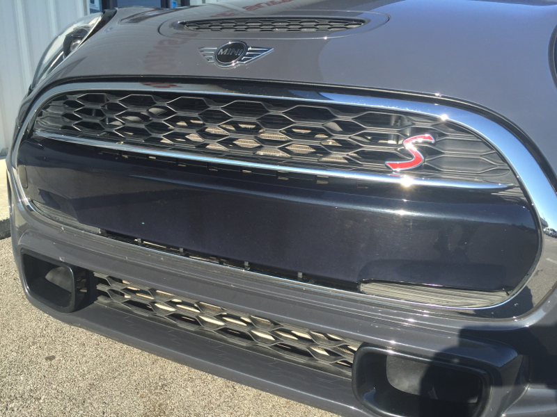

Just noticed it this morning, hard to see in photo but the black middle part of the bumper is turning white. Was fine 2 days ago. Looks terrible, called and it can be fixed under warranty and was told they have tried to buff it out with no luck on other cars. Pretty sure the new will do it again then I'll be back again.

There it goes...finally got it to load will take better pictures at lunch.

Having trouble seeing what you're talking about. Is it on the bottom of the middle part section? From what I found, it looks like a few people on NAM have had the paint flake off on their bumpers. Didn't see much about your complaint though. Here is one on NAM about the bumper paint flaking off and here is another. One had luck where the dealership took care of it. I'm pretty surprised, with how new your car is, the dealership wont do anything about it since it seems there have been multiple complaints like yours.

It's actually the Black plastic bumper that runs across the front of the car. I'll try and get a better picture on my lunch break. Looks bad. The dealer said they will take car of it for me just wanted everyone to know about it.

Hard to see it in pictures...

Yea it's a bad milky white look to it.

Ya, that's what I thought I was looking at. Very strange that the paint is doing that. I've seen lots on the paint flaking off from the F56, but not something like this. I'm sure this will be helpful to someone else in the future so thanks for posting! Hopefully it fixes the issue and it doesn't happen again.

Mine's doing it too but it's much worse than yours. I just haven't had a chance to go to the dealer yet.

Since the part looks like it snaps in...it might be easy to replace...
I'm wondering if the part in question rubbed on the car next to it in shipping...
So the clear coat on it is pretty much gone...so when they buff it, it looks good for a bit...but no clear left...so the paint the clear protects begins to look hazey...
Just a guess...
Since you live so far away..maybe the dealer can order you a part...save you a trip...rather than going in..getting itvlooked at, ordering it...then going back to get it swapped...

It looks like the paint is separating or reacting with the plastic underneath the clearcoat. It creates this milky, runny-looking effect. If I had my car today, I'd snap a picture.

For what it's worth, the replacement part is not much, about $50 or so. I ended up buying another one after I told the dealer 4x not to drill the plate bracket to that piece before picking up the car when I got it, you think they listened? They offered to replace it the next time I bring it in, but I don't want to wait until the next time I bring the car in for service, and they aren't so local, either. I'll replace it together with the JCW grille that I'm installing in place of the "S" grille.

Alright friends. I had a chance to take some pictures of my plate-filler piece. As you can see, the black has "faded" and there are areas where it looks like the color has separated and run. The piece is smooth; there's no change in texture. It looks like it happened under the clearcoat.
The car is garage kept except during the day when I'm at work.

We have seen a handful do this: 51117337791
https://www.northamericanmotoring.co...t-black-2.html
Genuine MINI with PDC sensor
https://www.ecstuning.com/b-genuine-...k/51117379434/
Aftermarket with PDC sensor
https://www.ecstuning.com/b-bremmen-...117379434~brp/
Genuine MINI and aftermarket without PDC sensor
https://www.ecstuning.com/Search/Sit...h/51117337791/
The replacement part has been fine.

I have the replacement part, it's been fine so far.

Yep, that's what most people were saying, once replaced it did not chip or oxidize. Like is was a production part issue. Parts for the US stock are usually second run or sometimes an alternate supplier.
