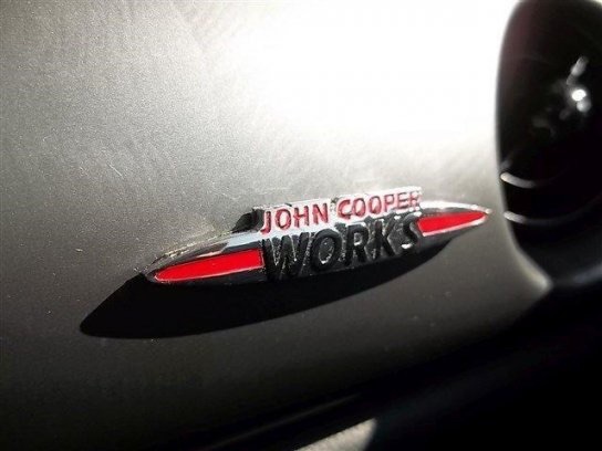

Now I am off to look at another mini claiming to be a JCW. Which is what I was originally wanting. Thinks to my first experience I am hesitant to trust anyone. Please tell me if this is a JCW. Keep in mind I haven't visited the dealer uet and will do so tomorrow. However I would like to know before I get up there and get lied to again. Here's a few pics. **edit** trying to upload pics via iPhone is proving more difficult than I thought. More pics soon sorry

Could just be a badge. Run the VIN here - http://www.bmwarchive.org/vin/bmw-vin-decoder.html

Don't believe badging.
Run the VIN

Looked it up. This is what I got. Could it be a cooper S with a JCW package? How can I tell when I get there?

1) The design of that particular badge is after badges used on the R56. The R53 badge is designed differently.
1st gen.
2nd gen.
2) I have seen knock off badges from China flooding the eBay sites and this one looks to be one of those stuck to the dash.....
ALL the 1st Gen JCW's have a badged/serial numbered plaque on the top of the valve cover like this one....No valve cover badge with serial number = Faux JCW
Good luck in your search !

The picture you showed in your first post shows the JCW badge on the inside of the car next to one of the dash vents? That shouldn't be there, unless they added that for some reason.

There was a badge on the JCW carbon fiber dash in the MC40 ...
The JCW badge on the dash of your car isn't the correct one for a 1st Gen MINI.

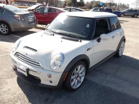

I think I might take it off. I have the gray dash like the one in that pic. Not sure if it is carbon fiber. I'll post more pics tomorrow. Haven't had time to really appreciate the car since I bought it on a weekday. Here's one pic from the dealer. Already thinking about blacking out all the chrome. Not a fan of all white. But I'm not picky when it's a JCW lol. Loving the drive to work now.

Is the front license plate easy to remove?
Old Mar 5, 2015 | 07:05 PM
minintrigue's Avatar
minintrigue
Joined: Dec 2003
Posts: 347
From: Cincinnati, OH
should be. hopefully they didnt drill the front bumper, but ive never had one. have always used a tow hook (no holes) license plate bracket.
