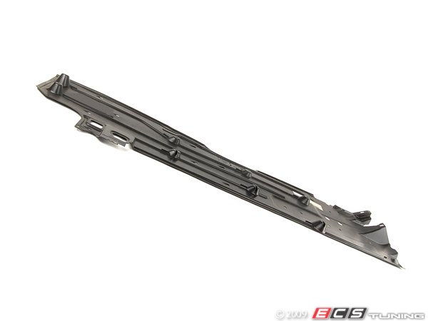

Yes the underpanels look like this. For the R56 2009 factory JCW
Click on the pics for the items.
Yes these were part of the JCW aero kit.

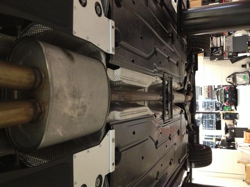

BlueToy - Thanks for the underbody shots.
I can tell you using the underbody panels for the R58 might be some work. First the rear section on the panels connects to the rear chassis center brace which is blocked by the additional supports which are on the R57 convertible and R52. Also near the center mid pipe square support would need some trimming.
Back by #5 and in the center by the inside cutout. Looks like there is enough room to slide under the brace to fit but it still might need removed and then re-installed , at least the outer arms.
Other then that it might work. Sounds like a DIY in the future Bluetoy. You do have the screw studs hanging down so it will receive the panel.

Kfmuller - Those look great on your 2009 factory JCW .
So clean and smooth !
