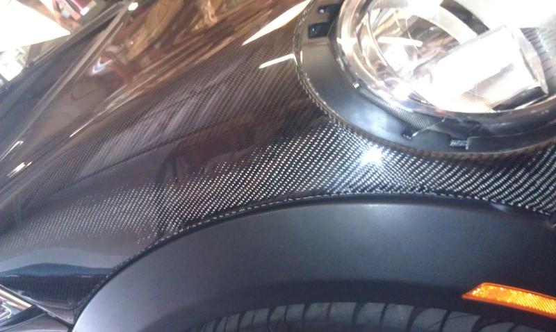

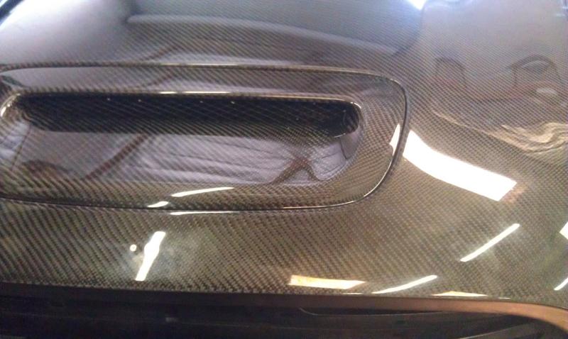

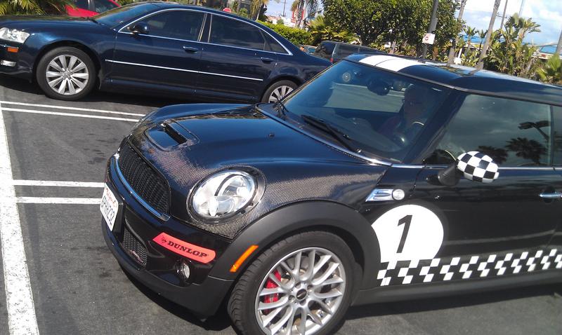

OK the hard work now begins
OK I got the hood to close and latch. i got the headlights centered in the openings. The lights still are sticking out too far and if I move the hood forward the hood will not latch so I am stuck. It is driveable now and that was the main goal of today.
Here are some pics of the fender clearance, this part is better than stock., a closeup of the carbon weave of the hood and scoup. The scoup has a screen only so there is more airflow than stock.
Now the bad news. I cannot for the life of me get the trim rings on the headlight openings. The hood is so much thicker in this location than the sheet metal. I am thinking I may need to bond them on in some way. Also the top grill trim is going to be a bear to get on. it is not pre-drilled for this so it is going to take some fabrication to complete.
Attached Thumbnails Carbon Fiber Hood?-imag0204.jpg   Carbon Fiber Hood?-imag0202.jpg   Carbon Fiber Hood?-imag0215.jpg
