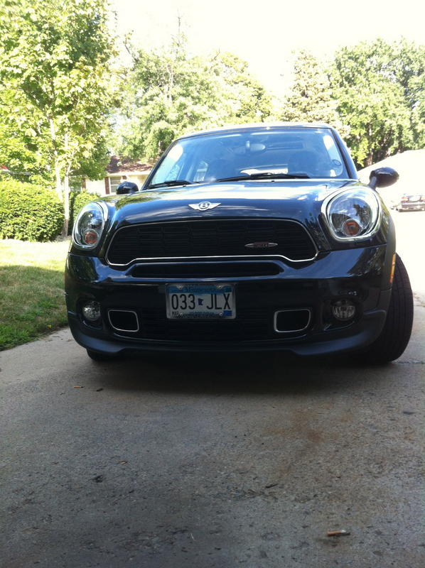

First and foremost, thank you to all who posted instructions for JCW lip/spoiler.The link to the pdf for aero kit install is extremely helpful. So far the trickiest part was getting to 2 small plastic OEM rivets behind flares (gently tug is an understatement) but I was able to remove lower valance in 20 mins & am currently waiting on a Fed Ex delivery....
Assembly of adapters/spacers & attachment took another 45 mins (would've been longer without instructions - thanks again)
Attached Thumbnails JCW lip questions-photo-2.jpg   JCW lip questions-img_2615.jpg
