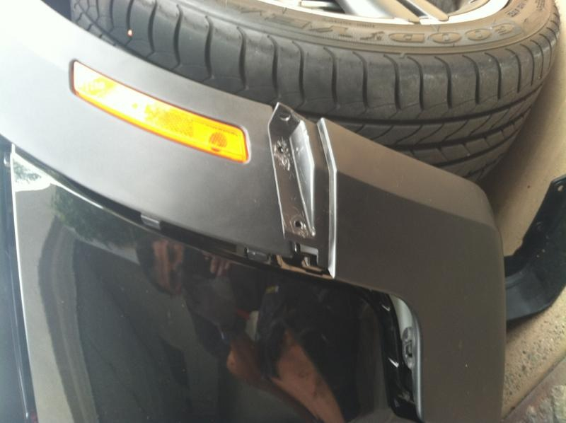

Well I started the install for this today, and got tripped up by those 2 hidden rivets in the flare by the parking light. I'm not sure how to get those disengaged.
Old Jan 13, 2013 | 12:30 PM
  #38
eenunez1's Avatar
eenunez1
Joined: Mar 2012
Posts: 185
From: San Diego, CA
If I remember correctly, I cut the head off of the plastic rivet and pushed it through... I suppose that you could remove the rivet head with a drill. Your kit should come with new rivets to install the new lip.

Posts: 709
i may try cutting the head off - i'm trying to do this without having to remove the wheel, and just turning the wheel all the way to get access to the rivets. i can see the first one but can only feel the second one.
few hits with a chisel and hammer, maybe?
Maybe this pic helps..
i thought about cutting the head off the rivet but didnt want to scratch the paint all around it. the best and easy way is to melt out the center with a solder gun. the tip melts through the center and it simply falls out without all the scratches. it worked awesome! if you do not have one there cheep and you can use it later to connect wires, or just melt stuff

you can get a set of plastic trim removal tools at harbor freight for like 5 bucks that pop these right out with no problems or scratches.

.. and fyi do NOT drill out any on the plastic rivets, there's no need to. use a pin punch and push the pin through on the smaller ones, the larger ones, use the removal tool i mentioned earlier. also do yourself a HUGE favor and tape down the 3 screw retainer clips, if they slide after you have the lip up it's a ROYAL pita to get them back into place.
