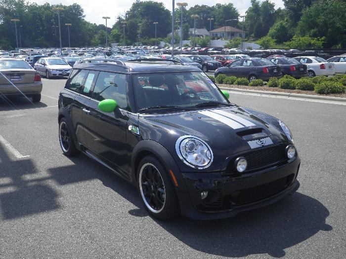

Here are some pics of the car:
It definetly has the body kit, but it's the exhaust tips that make me wonder, since they look bigger than whats on my Clubman.

Looks like a Cooper S to me, there is no JCW badging on the car

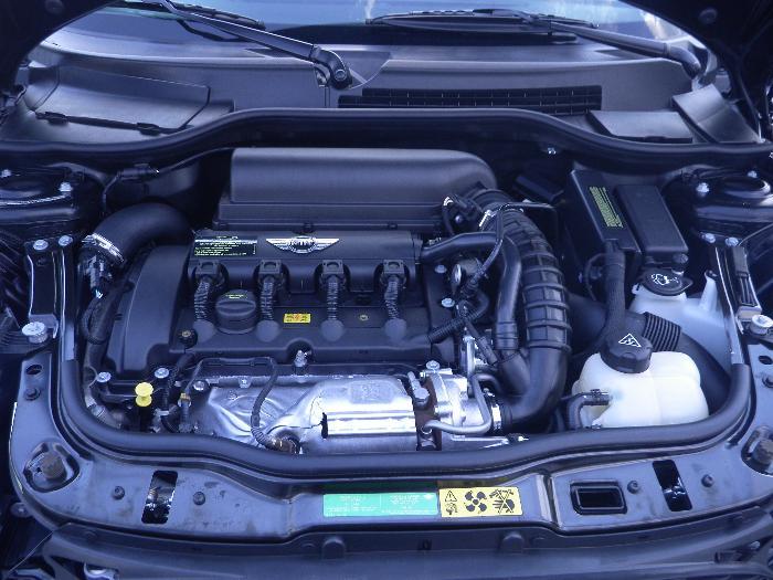

Kevtar, that car does not have a JCW tuning kit installed. [At first I thought you meant the JCW aero kit since you were talking about bumper damage.] If it had the tuning kit, you would have the engraved JCW exhaust tips and the badge under the hood with the engraved serial number. Here are some pics for reference:

I wonder if it has a magnaflow exhaust.

They could be just different tips. Need to see pics of mufflers.

FYI,
That is a standard air box and no JCW badging.
There is NO JCW tune kit.

The best place to validate if the JCW tuning kit is installed is in the engine bay. If it had the JCW tuning kit installed, it would have the JCW-badged airbox, there would be a JCW tuning kit serial# badge on the valve cover, and there would be another engine bay label with the spark plug change info that is specific to the JCW tuning kit.
That clubman does not have the JCW tuning kit.
