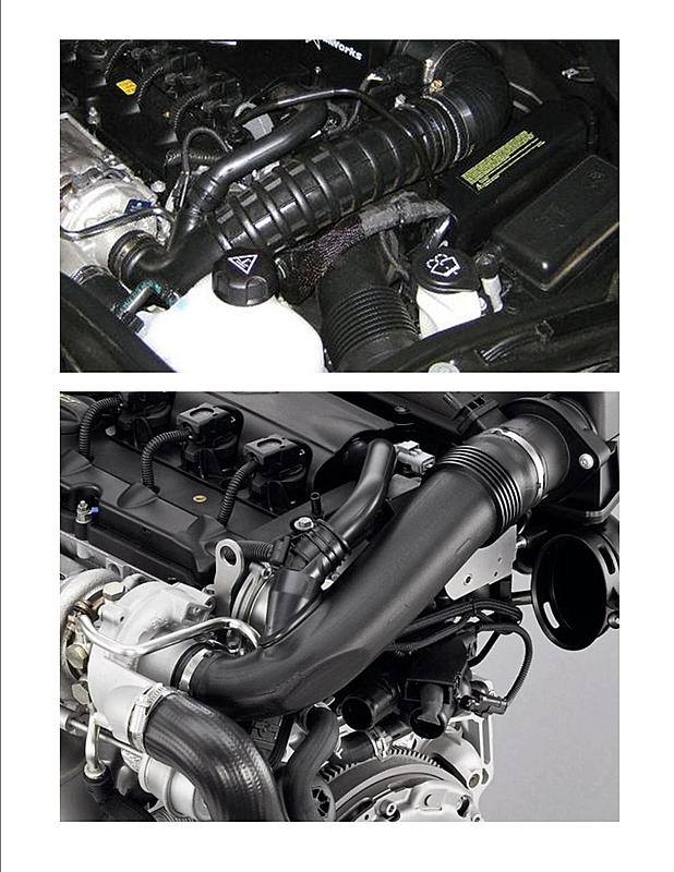

JCW Turbo Inlet Tube...?
On the JCW press release engine picture it shows a larger, smooth, turbo inlet tube. Is this a performace upgrade for us non JCW folks? Can I order this from the dealer?
R
You can indeed order this from your dealer. I ordered this for my stage 1 JCW earlier this week. The part retails at £67 and is stock in Germany. I should have this by end of next week. I believe the only change may be a larger inlet dia. at turbo. If so i'll have a spacer ring collar machined in plastic.
BTW: The factory works runs the flat panel filter from US spec cars and not the cylindrical filter as the stage 1.
Figure that one out
I'll post pics once done

Fitted it
Perfect fit with no mods required.
Tried to measure the inside dia. ( O.D. - 2 x thickness ) and it's not bigger but bigger for longer. It's now 2.75" right up until the breather hose connection. It's not as big as the ALTA version, but only cost me £58.63 and keeps the OEM look.
Not driven it in anger yet, so will post back later if i can feel any difference, although i doubt much if any.
Part no. M13.71.7.582.453
