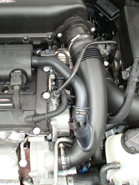

Originally Posted by japper
Fitted it
Perfect fit with no mods required.
Part no. M13.71.7.582.453
Japper, would you be able to take some pics of your install?

Originally Posted by zedaristo
Does this mean the US JCW and the EU JCW motors are even more different now besides the MAF sensor like before?
I'll take another later today, as i can't resize the one on file to post here.

Picture as requested
