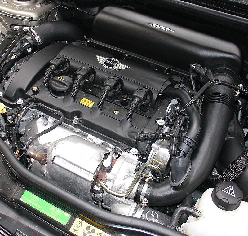

JCW Turbo Inlet Tube Installed.....
Well since I started this thread.......thought I would report back that the tube came in and is installed. Cost was $132.00. As mentioned before the rubber sleeve on the turbo end needs to be transfered to the new tube. Looks much cleaner than the stock tube, can't collapes, looks factory, looks more finished than the silicone hoses, and I'll assume delivers the same horsepower gain as the Alta tube. See the attached picture.........
Hoopty
Hoopty
How did you get the smaller hose off I am not familiar with the connector. Was it easy to transfer the rubber portion on to the new JCW inlet tube.. Secondly, I notice you have the M7 tube that goes between the Intercooler and Turbo. Did you do that before the JCW kit or after. Did you notice a power difference and did you notice a sound difference with the M7 tube. Do you think your dealer would have any complaints about warranty. It seems it just deletes the muffler. Last was it hard to get to in order to install the M7 tube.
Did you notice a sound difference with the JCW Inlet Tube
There is a strange 'U' shaped retaining clip that holds this hose in the valve cover. I wiggled it while pulling up on it and it popped off. At the turbo inlet the 'rubber portion' or sleeve comes right out of the JCW tube. And the sleeve in the OEM tube is bonded in and needs to be peeled out. The M7 tube is an impressive piece. It was a pain to get the screw holding the OEM tube/muffler in. Tried the top and the bottom and just kept monkey-en with it to get it out. This tube does delete the muffler and the OEM tube is kind of pinched off or kinked at the bottom where it bends and goes into the intercooler. The M7 tube is a consistent diameter the full length. Slight sound difference, and what seemed to be a slight performance difference too. My dealer told me that changing the exhaust (cat back) and changing the intake was OK. So I hope this still qualifies. I don't have a JCW kit just the air filter module. And your last question....No...I didn't notice any sound/noise difference with the JCW tube. My car has been running awesome lately, so thanks M7, Alta, JCW, and Magnaflow.......
Hoopty

Just received mine today and installed it on an Euro version car (non MAF) - Have to say the difference is night and day to the normal Cooper S airbox!!
Lot of torque throughout the rev range - and a whole lot smoother too. Coupled with the factory JCW exhaust the car now sounds like it should have been from the factory .. love it.
Before:
After:
