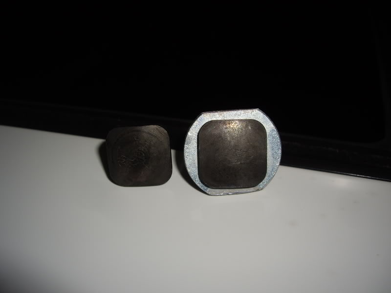

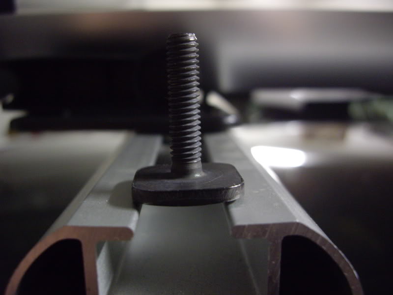

Alright, here are the pix of the bolt/washer setup for the Thule sidearm with the Xadapt1 kit.
As you can see in this first pic, the bolt head is much too narrow for the gap in the factory rack. Although it does have enough lip to secure the rear end of the rack down, the slightest forward or backward slide of the rack could easily cause the bolt to slip out of the gap.
In this pic, i am comparing the plain bolt to the bolt/washer combo. The washer itself i had to grind down to fit perfectly in the gap without being able to free itself, its very solid now.
As you can see, with the washer attached, there is a very snug and secure fit.
Hope this helps anyone with the factory rack!
