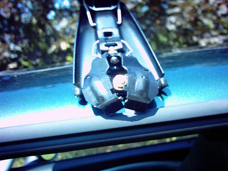

Once you have all four of the slots cut, first pic shows both on the driver's side, you need to get the bars ready to install. This involved loosening the clamp nut, whitch will draw the mounting clamp together.
more
Then you need to check orientation, here I had issue as the little pictograph pretty clearly points to the front and rear on the passenger's side, but those stickers really corrisponded to the driver's side. Right bars, front and rear, just backwards left to right.
Then just set the bars on the roof, they will rest on the little rubber bands and should sit gently in place.

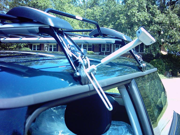

From here you need to feed the latch tongues into the body of the car, which is just a bit scary as it sure seems to take enough force to poke them in that it feels like you're scraping and denting the roof. Relax, push gently and firmly, wiggle a bit as necessary, they really do just poke in and sit in place. You will need to re-engage the tongues to their brass tightening nut, though, but it's pretty self explanitory.
Once they are all in place, put just a couple turns on the jam nut to make sure everything stays put, then attach the tools for tightening to each tower in turn to make sure it's in tight and torqued to spec. (Torqued to spec is until the arrows line up on the included torque driver.)
success
Once the jam nuts are tightened, they should look like this, then all you do is flip the covers down, lock them in place, and admire your work. It's hard to tell, but as everything is tightened up the little rubber bands are actually drawn up off the roof, so the only place it actually touches the car is where the tongues go though the body and latch in.

Did you have problems pushign down the "wire thingy tool", that is supposed to push the clamp together while you tighten down the nut? That thing kept coming off when I was pushing down on it hard enough to get the clamp together and under the nut, it would come off and fly. Almost scratched the car a few times....

I actually didn't even use the little tool for tightening the clamps. The trick for me was to wiggle each of the "tongues" into the slots on the car, then while I was holding them in place with one hand tighten a couple turns on the tightening nut to keep it all in place. Once they were tightened down a little bit they stayed in place just fine.
After I got all four sets slipped into their slots I went around the car a couple times tightening everything up. I went basicly hand snug with the tool, not even deflecting it, to get all four nuts all the way down and then went back and actually torqued everything. I just used the palm of my hand to apply firm pressure to them, then torqued to spec.
My tool however, the one for tightening the clamps, is pretty tough to get slipped in under the support bow it hooks to to pry against. I don't see if flying off easily at all. Perhaps they made a bit of a change between yours and mine with regards to the tool.

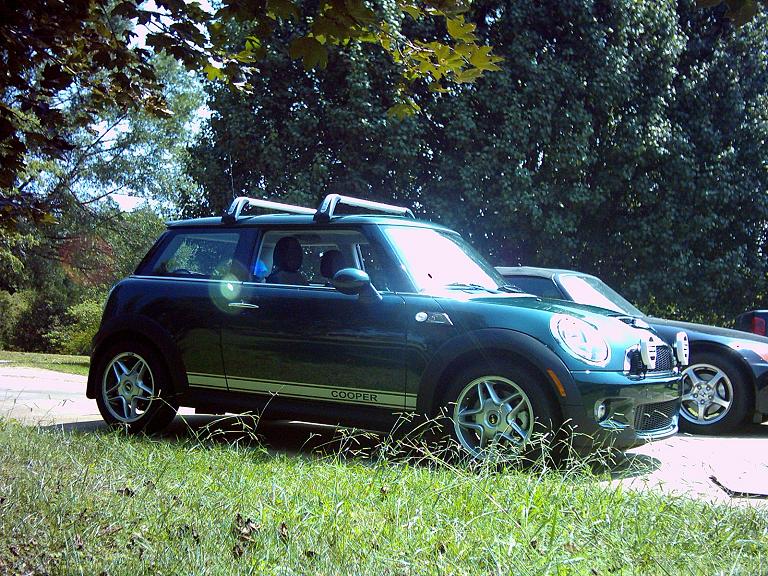

I decided my MINI looks cool with the rack on all the time. So I have left it in place. Heck, I don't even have any of the kits for it yet. It is totally not worth it to have a dealer do the install, it's just easy enough.

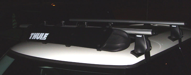

LOL~ i just finished installing a thule rack system. I was under the impression that the mini system drilled into the roof. Never saw the new design. Also, the thule rack system was 20% off.
Personally i kinda like the clamp on idea that the thule rack offers. It clamps onto the gutters from the bottom...instead of fitting into holes in the roof. Are those holes painted? Id be worried about the rack violating the paints protection of the metal....or maybe im justifying my purchase ;-)

Birdman, here ya go. Let me know if you want some daylight, better pics....All i can take right now...
Ill take some pics with the bicycle racks installed tomorrow, had to wait for the adapters for the peleton fork clamp-type rack.
I also purchased the "wheel-on" so i dont have to find a place for the wheels in the car. ive always found that to be a pain.
Finally, I plan on building a cargo basket for the top that fits between the two bike racks. I want a narrower one (and one that isnt 400 bucks!). Some streamlined steel tubing will make it slick!
Let me know if you want more pics,
Nick
