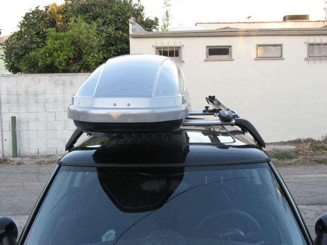

Roof rack config for cross country trip
I did a bunch of research before getting all of my gear and here's what I came up with.
Bought the oem rack from Morristown Mini from their website and it was just over $200 with shipping. Way cheaper than if I got it from a dealer. Went to Rack Solid her in Venice/Santa Monica and picked up the Thule Atlantis 1200 for 20% off, so it was just under $400. They're currently having a sale, so it's a good time to check it out. They're on the web at http://racksolid.com/. While I was there I picked up the Thule Peloton fork mount for my Cannondale mountain bike. I thought about getting one that holds the bike by the frame, but the owner suggested the fork mount as it would be sturdier.
Mounting the OEM base rack was a lot easier than some on this site have made it out to be. I rapped the bars up in a towel to keep from scratching anything and did the job all by myself in under 45 minutes, and that was taking my time. The grooves in the rain gutter are really easy to find when using the white card. I do suggest using a sharp knife to help cut thru the score marks when pulling the rubber trim sections out that cover the slots. It makes for a cleaner edge and prevents the rubber from coming out in 4 to 5 pieces, as opposed to one or two when using the knife. You have to apply a decent amount of pressure to get the clamps into the slots using the tool they give you, but if you tighten down halfway or so on one side, then start the other, it will make it easier.
The cargo box mounted with no problems, took the guy about 10 minutes. I took the bike rack home to do the install on that myself. Here is were I had to make some modifications. The bolts that they give you with the Thule bike rack are square and they are about a 1/4 smaller than the grooves that are in the base rack. This means that instead of grabbing both the front and the back edges of the internal groove of the rack, they only grab onto one or the other. It holds, but I want it to grab both edges. I'm going to check back in with Rack Solid to see if they have bolts with a bigger square base that will grab ahold of both edges of the rack. My other problem is that both the rack and the box prevent the rear hatch from opening all the way because they hit the spoiler. If I'm not paying attention I could likely do some damage to all three. It may be possible to trim a bit of the bike racks tray to get it short enough so that it doesn't hit. Unfortunately, that's not possible with the box. The entire setup with the bike mounted weighs in at just about 70 pounds. That leaves 95 pounds that can go into the roof box, which should be plenty.
Generally speaking, I'm happy with the entire setup. I mounted the box over the passenger side in order to offset my weight on the driver's side. I'm hoping that it won't affect the handling of the car, but I doubt it will. Pictures are attached
Attached Thumbnails R56 roof rack-img_1196.jpg   R56 roof rack-img_1198.jpg   R56 roof rack-img_1199.jpg
