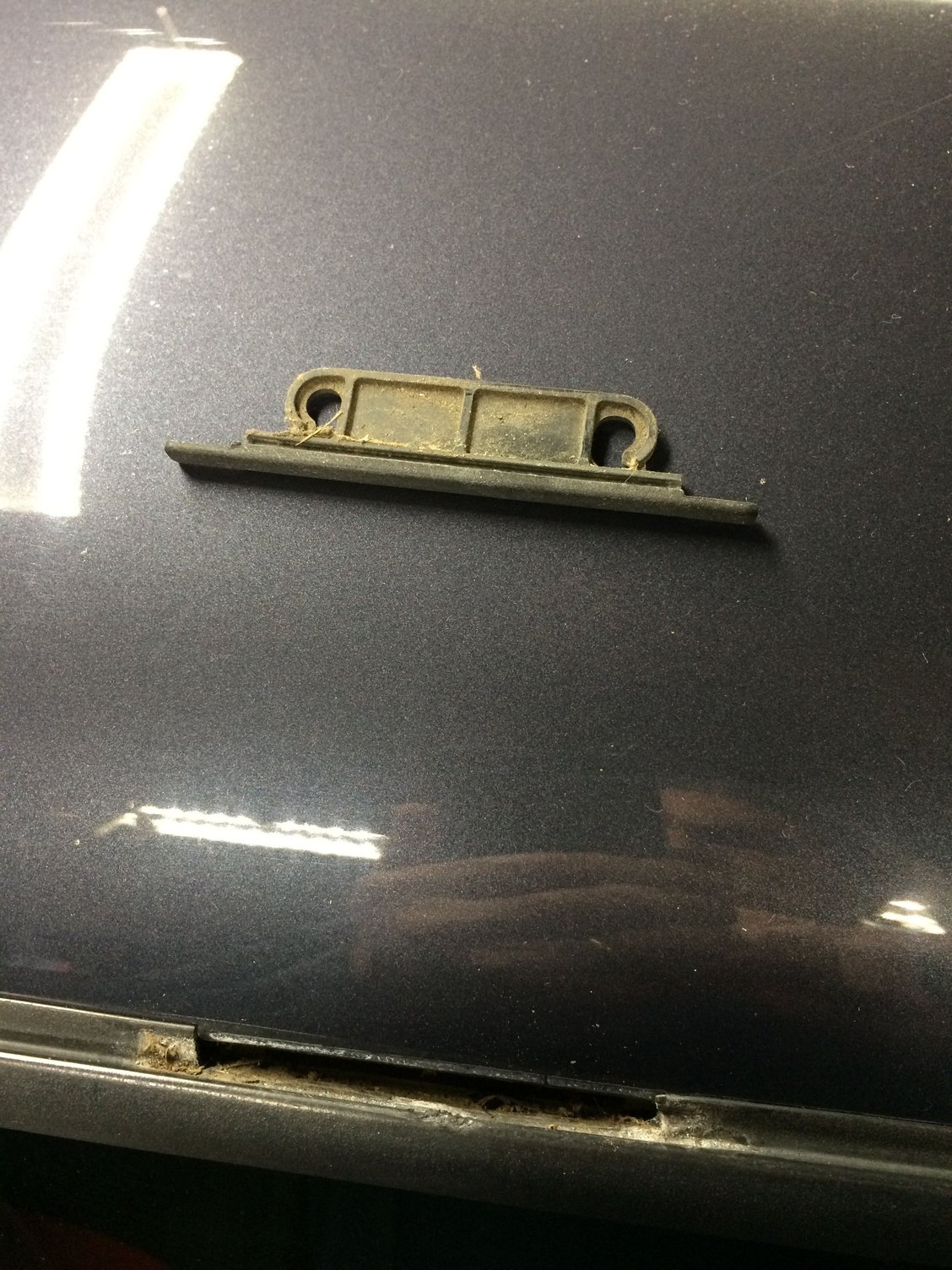

Here a couple of pictures of the cap for the roof rail on my R56 and how mine are installed.
Cap, ribbed side up for installation
Cap partially fitted into the roof slot.
There is an up and down to these caps. On mine the smooth side is down. I install it like I show above, one end first and then push the other end in. It takes a little push, but nothing extreme, and it snaps into place. When I took these pictures, the air temp was about 40 deg. I have installed these in much colder temperatures without issue.
Hope this helps.

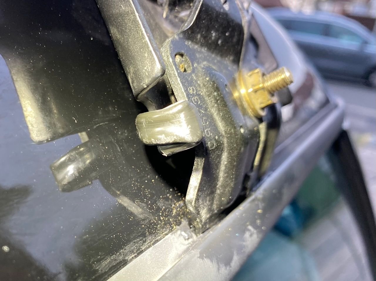

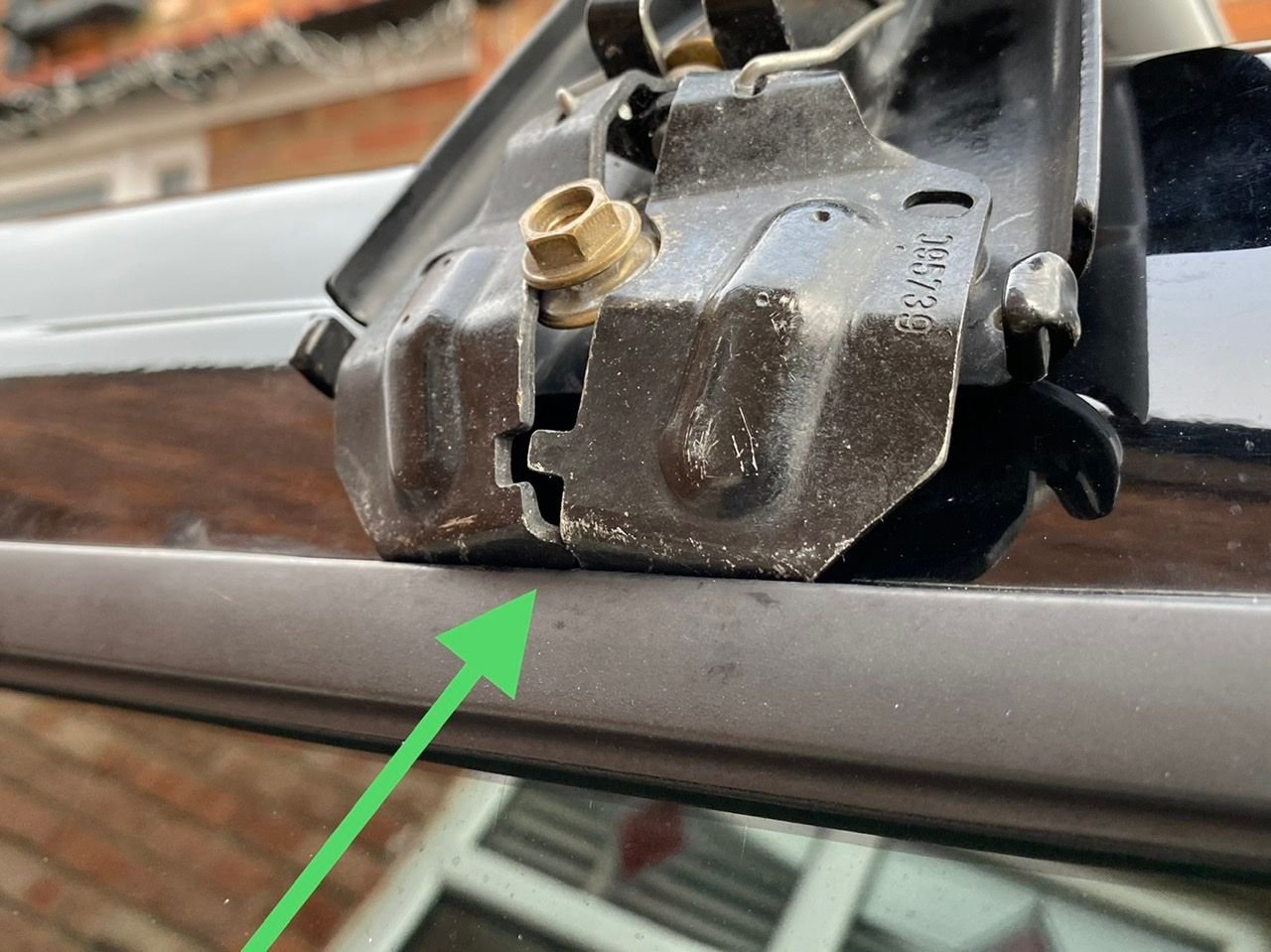

Hi thanks all I finally managed to get them fitted. One piece of advice I will give in case this was part of the solution - I used some silicon grease as I think I had problems getting the triangular bit that sticks out (see arrow) past the drip rail. For some reason mine was exceedingly tight, and added to my problem of getting the legs pushed into the roof slots. So lubrication helped I think.
I did as suggested and put triangular sticker on the passenger side (in UK!) this time, so maybe that also was the problem, I can’t tell.
Tight spot
fitted
