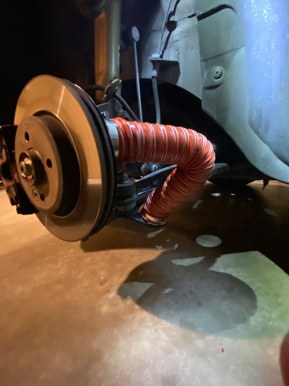

i was thinking of doing something like what i saw on the forum before where they routed the duct from the bottom and directed it to the caliper rotor area. I read that removing the fog lights for a brake duct does not provide enough air to make a difference due to the length air needs to travel.
i’m thinking of using pvc so inside is smooth and follow the crash tube line so it is as short as possible something like below. Picture is not from me. Picture is from this thread.

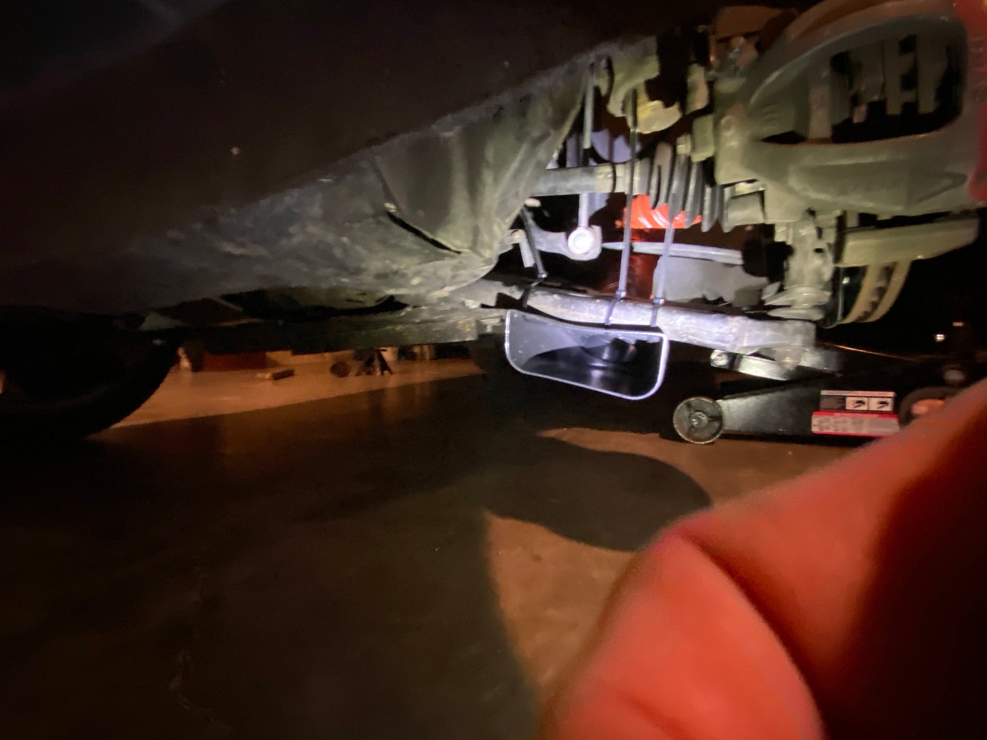

I have a somewhat similar setup.
My inlets attach to the lower control arm instead of the bumper though.
