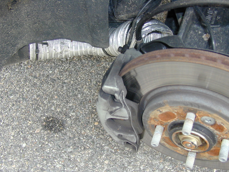

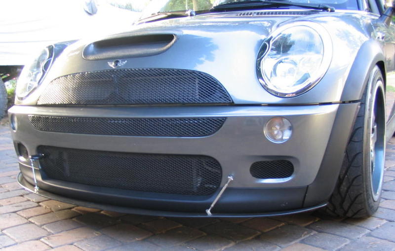

Here's my try at some ducts. I used the first listed duct at this site, but I've seen these plastic ducts other places.
http://www.discoveryparts.com/cgi-bi...roduct=ducting
Attached Thumbnails Brake Duct prototypes-brakeducts1.jpg   Brake Duct prototypes-brakeducks2.jpg   Brake Duct prototypes-brakeduct3.jpg

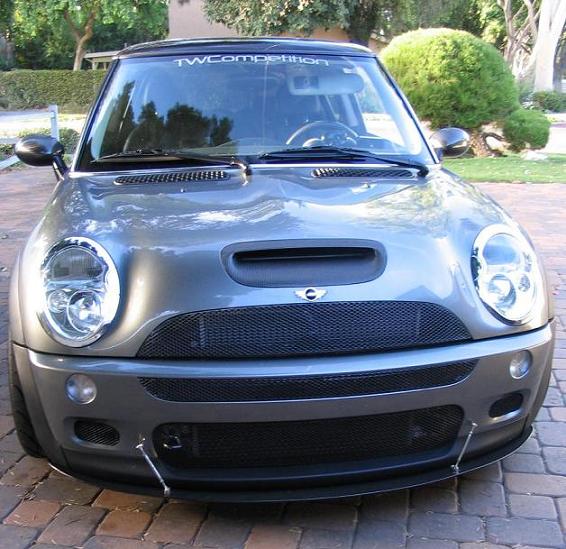

brake ducts tested 6/10
Here are the original photos of these custom fabricated front brakes ducts. They have since been painted black. Molded fiberglass inlets with 1.5" high temperature silicon hoses, they were made by Doug Livingston in Indianapolis for a three-day DE at Putnam Park racetrack. Doug runs ProSport Driver's Group, an open-lapping group that rents Putnam Park frequently and has also run groups at Gingerman and Mid-Ohio for fast, experienced drivers. My request was for a setup that would attach without drilling to the air dam under the front of the car, be easy to take on and off, get air to the calipers (because there is not an easy way to cool both sides of the vented rotors themselves), and be streetable (not lower than current ride height).
The inlets mount with a single bolt to a stock attachment point, replacing one of the points holding the stiff, black air dam in place. The dam itself is cut out to receive the fibreglass inlet.
These ducts were tested at Blackhawk Farms Raceway on Friday June 10. The air temp was 90 degrees and the track temps were 100-110 degrees.
Blackhawk is notorious for being hard on brakes. I ran four twenty-five minute sessions. There was new fluid (ATE Blue), new stock rotors (seasoned before the event), new PF97 pads in the front; rear pads were Ferodo 2500s.
I experienced no fade whatsoever in any of the runs. These are very hard pads (= Hawk Blues) and require a little more pedal effort to get the ABS to kick in at the threshold, compared to the more grabby Ferodos. At Blackhawk you must have pads that will hold together in extreme heat.
For more information about obtaining these ducts from Doug, call him at 317-289-7221. He's in Indianpolis; anyone in his area will be able to work with him on the installation directly.
A FAQ: Where do the hoses attach to the rotor or the backing plate? the exit of duct hose attaches to the caliper; when you change pads, the hose stays attached to the pad holder.

scraping
I have only scraped once, lightly. Clearance is fine - remember these are set in to the air dam just behind and under the plastic fascia are only fractions lower. My car has stock sports suspension +.
As to the nylon ties, they have not melted. They have a 500 degree plus tolerance according to Doug.
I am running at Blackhawk again on Friday June 24th and will update next weekend. These seem to be a great and inexpensive way to eliminate fade without going to a big brake kit.
pmello, nice integration into that front air dam...very subtle with the black duct.

Little update. The 3 in aluminum dryer hose tears when you bottom out. I've replaced the hose 3 times so far. The hose costs $7 at Home Depot. I liked it because it was stiff and I could point it at the little openings around the hub bearing. This is a compromise as you have to make sure that nothing gets fouled at full lock (steering left or right). Guess I'll have to get the good high temp silicone hose from the Aircraft listing.
It does work! I go to a 3/4 mi shifter cart track in up state NY (SLMP) twice a year. This place is VERY tought on brakes. There are 4 straights where you get past 70 and then into some tight turns. There is no time to cool the brakes. Most cars get only 2 good laps before hard fade and 4 to 5 before you boil the good kind of (Blue/Mutol 600 Etc.) fluid!!! It was very hot when I went in June and the brakes were a lot better. I had Frodo 2500 pads on this year with the good fluid (Castrol SRF) and the ducts. I could still make them fade some at the 4 /5 lap! I think I do like the Frodo 2500 slightly better tha the Mintex pads I had last year.
I'm going to remove the dust shields before I go this time (Sept 4/5). Any thoughts on this TCE?? My setup is just Frodo pads, Castrol SRF and the ducts. (We'll think about that BBK for next year)
