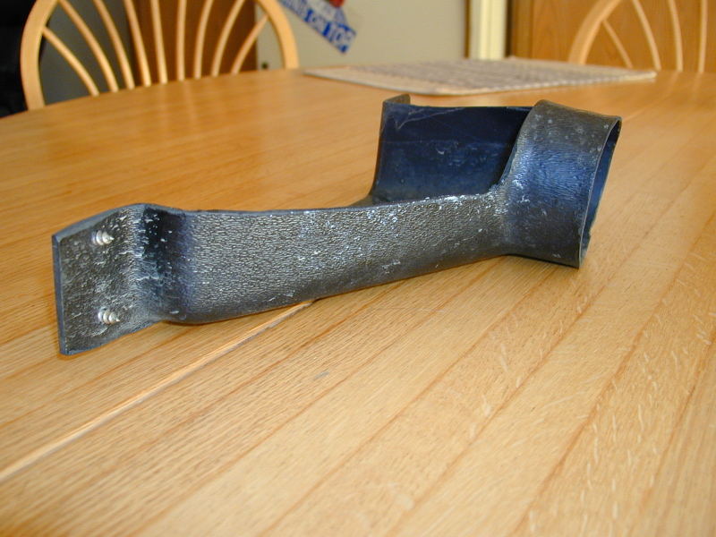

I took some pic's of how to trim the ducts today. I kind of tore up the right front one last Sat at a test and tune event. The parking lot is a little rough with a few places where I bottomed out pretty hard! Not a surprise. We got in 20 runs with just 1/2 hour track duty. What a great event. Something was bound to give though.
I was in a hurry when I did the trimming. Trim the bottom flush, leaving a little radius on the bottom. then put it against the air dam to get an idea how high to start the cut. I could have left about an extra half inch on one side. No problem. A little ducttape fixed it up! I used a hacksaw to cut the vertical cuts in the dam and a razor knife to cut the top. If you're careful the removed pieces can be put back at some later date! I used 4 SS #10 1/2 screws to hold the duct in.
Now that I tore one side off, I'm going to make some backing plates out of 3/4 x 3/32 aluminum from Home Depot.
Here is some food for thought....
I'm trying to help a Fox body Mustang customer with some duct issues as well. We did some note comparing and found that this car (like the SRT4 upon some investigating) has a problem with the fog lamp holes being the inlet.
In much the same manner that the ducts here shown may exhibit. Actually more here when thinking about it more...
'Cup cars have found that ducts placed too far to the outer edge of the bumper cover don't flow well. As speed is increased the air spills over the hole at such a rate that it does not enter the hole. Thus it's not a high pressure zone. This was confirmed with some poking around at the front covers of cars at the Glen. Air from the middle nearst the radiator is the spot to be in. Seems the SRT4 suffers this same issue.
Ducts shown in the first pic will have the same problem. You're in a low pressure zone below the chin spoiler or splitter. As the air dams up in that bend it washes up into the rad and rolls off the edges (in theory) producing down force on the nose. What washes under it is going to be very turbulant at best.
The place for those parts is in the chin spoiler area or the rad opening. Not under it.
Not being critical here, but the above work has turned on the light a bit more on placement. I'm no aerodynamicist (hell, I can't spell it!) but I do believe I'm correct on this for the MINI as well.
