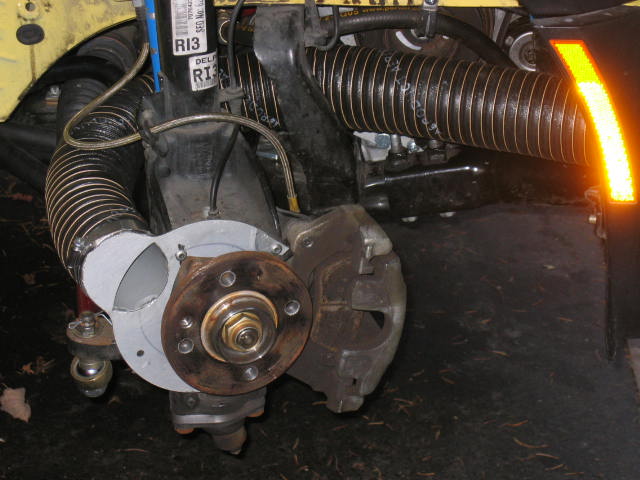

Better Brakes
All,
It is indeed winter. One project is air cooling ducts for MINI's brakes. Have completed the passenger side duct and am working on the drivers side duct, as we speak.
Fitting the passenger side ducts was tough. Hardly enough room for the engine, oil cooler hoses and the air ducts. Had to cut into the plastic fender liner to provide clearance for the duct, and even then, the wheel just touches the duct when on full lock. The air outlet to the brake disc is a modified BMW 3 Series cooling shroud that is available from any number of BMW performance tuners. Here are a couple of photos.
Hope these ducts help my brake cooling, after all this work.

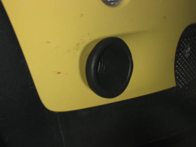

Wow those look great. The inlet is through the foglight holes, correct?

John, very nice! What's the redish bar in one of the photos?

Brake air duct intakes
RalleyMINI,
Old Dec 13, 2005 | 07:06 PM
  #370
Petrich's Avatar
Petrich
Joined: Dec 2002
Posts: 314
From: Sammamish, WA
RalleyMINI,
As I was trying to say..... Yes, am using the foglight holes. Attached is a photo of the intake openings. A bit dorky looking, but the best I can do for the present. Would be interested in other people's solutions. My primary intereste is AIR to the brakes in time for my next track day in February.

Bump steer correction
TonyB,
The red "thing" in the photo is an aftermarket tie rod end that allows me to adjust out bump steer. These tie rod ends are a BMW Z-3 racing part that fits the MINI exactly. Infact, as I recall, the brake air duct components are adapted from Z-3 products.
The short version of a long story of why the bump steer correction goes back to some posts that I made in May and June of this year. The topic was about the suspension geometry problems that come with lowering the MINI and what was necessary to raise the front roll center back near to stock height. After relocating the lower "A" arm and raising the roll center, I needed to correct for bump steer, hence the red "thing". A cheaper, but not 100% satisfactory approach for me, would have been to install a heavier front anti-roll bar, as many others do with their lowered MINIs. One of the most noticeable consequences of a heavier front anti-roll bar is to convert the MINI's independent front suspension to a close approximation of a solid axel suspension. Not for me, at least. There are other issues about camber gain with lowered MINI's as well. The stock suspension geometry in a non-lowered MINI is as close to perfection as I could ever dream.

actually that inlet looks very clean an integrated....i say you did very well

Originally Posted by Petrich
TonyB,
John Petrich in Seattle
John, I do recall a discussion or two along those lines, and I believe meb was big on roll center alteration via lowering. Heck, if you have any photos that show how this tie rod is situated, please do share. Nice to hear that this Z3 item fits very on the MINI! You ought to upload your many cool and unique photos into your gallery... Thanks again.
