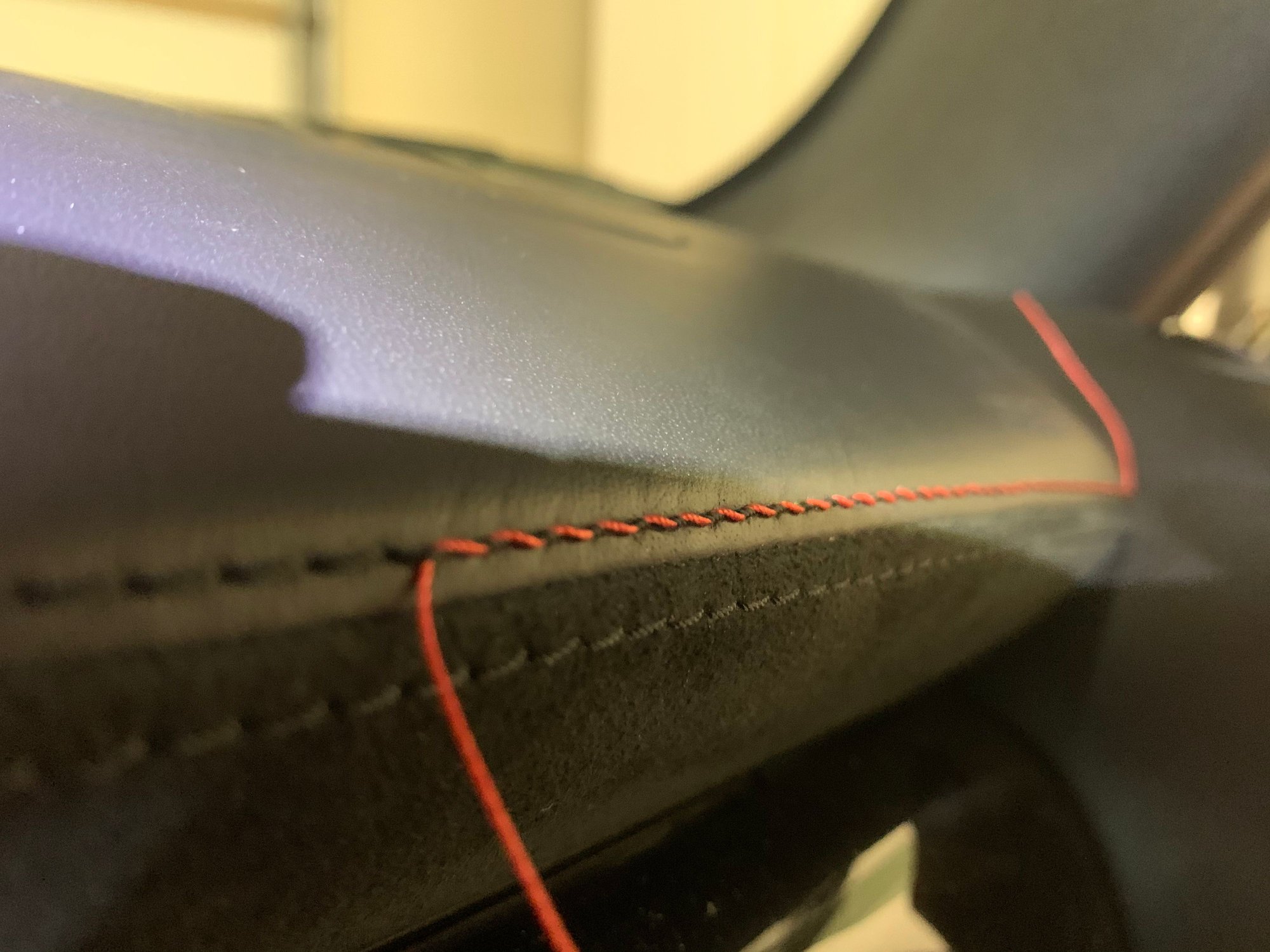

First attempt, not too bad. Sorry for the lighting. I will continue slowly as it's mind numbing. Now sure how to remove or tilt forward tachometer to gain enough space.
Only tricky part is hiding the knots under the trim. Well, and not scratching the leather or leatherette I guess.

That looks great! Can’t wait to see the finished interior. Any details like brand/weight/source on the thread and needle you are using?

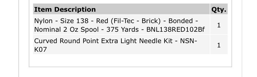

I got everything at Thread Exchange. See picture below. I was worried about the red matching the steering wheel and it worked out OK. I will have plenty of thread left so let me know if you need more and I can send you; min spool size is 375yds...although it's inexpensive, it's a bit of a waste. The thread has a bit of a waxed surface so it's hard to tighten a knot like when using a non-nylon thread. It comes undone so best to leave a little extra on the ends and tuck it.
I used the 20 gauge needle.
It's important not to over tighten the red/new thread because when you do so the original stitching also tightens and it becomes harder to insert the needle without damaging the dashboard.

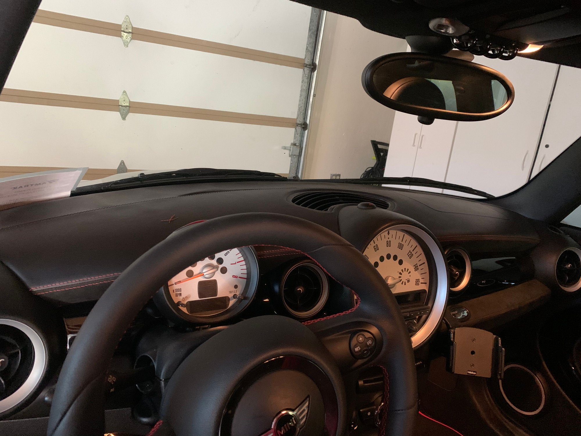

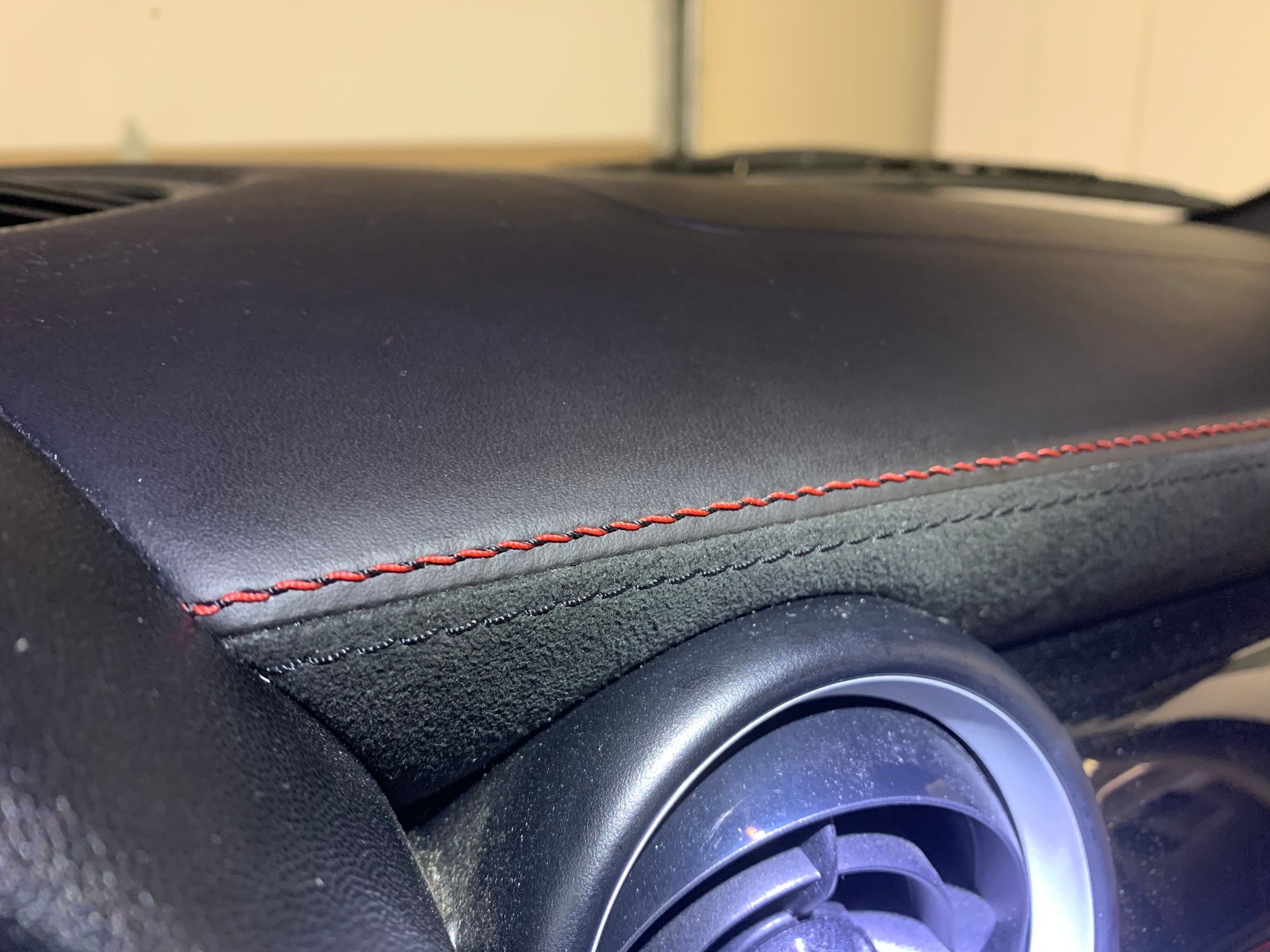

Finished front part of dashboard. I think I will skip the stitching on the very top of the dashboard close to the windshield, it's barely visible. I'm yet to do the glovebox area. Good little project.
