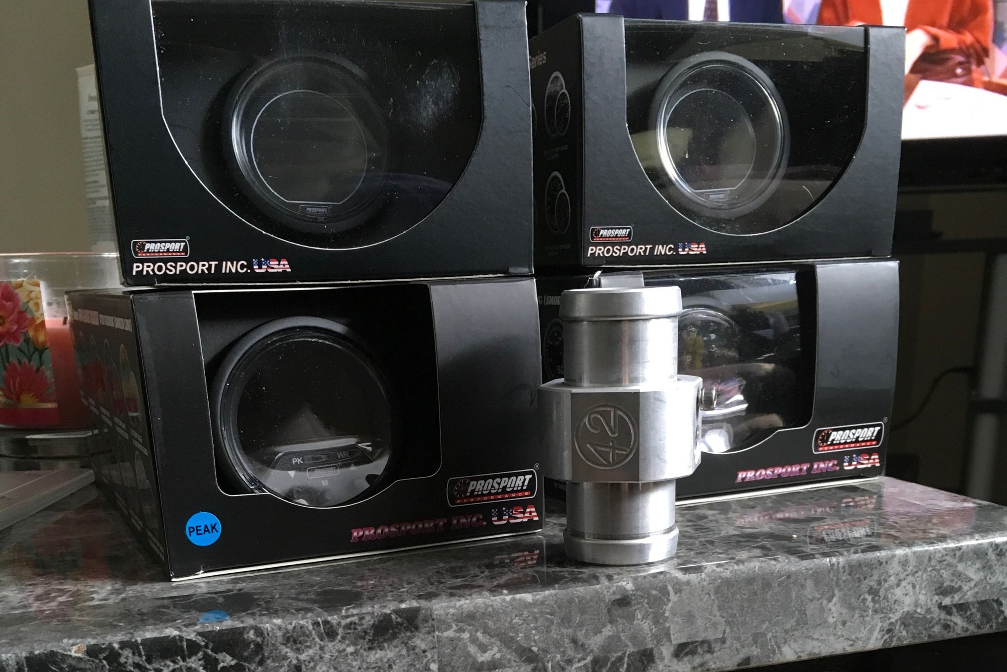

Old Apr 14, 2018 | 03:40 PM
carwhisperer's Avatar
carwhisperer
Joined: Mar 2018
Posts: 65
Above is my digital water temp gauge. It also reads DTC codes, fuel trim, vehicle speed and a few other things. This helped me correct my DTC codes. Now that I have a better idea of how the cooling system works, I think it's scary as hell driving around without a coolant temperature gauge on these cars. I had a bad ECT sensor connector. I ordered one from an as yet unnamed reputable OEM parts distributor. The wires I was sent did not fit inside the plug. I soldered in a junkyard connector from a GM car. I had to modify it to get it to fit the socket. Now my gauge reads constantly and my CEL went off after a long drive. I am very happy with this little $36 gauge. I was able to mount it with one of the Tach screws, using one of a longer length. It turns on and shuts off automatically when I use the car (most of the time!) This is what I believe to be the case about how the system works:
The thermostat opens at around 105 or 106 degrees Celsius, and will stay open for a while after climbing a hill (I just did an 80 mile trip with 8000 total feet of elevation change). At those times the ECT will drop into the mid 80s. In traffic the temp will stay right around 104 to 106. The cooling fan will not come on until about 106 or maybe even 107. In the absence of a valid signal from the ECT sensor, the ECU will run the cooling fan constantly, and will run for several minutes after shut down, even if you've only run the car for a few seconds. I believe there is only one ECT sensor and that a Mini will let you cook it's engine with no warning. A car will run with a bad or no ECT sensor. The ECU will hold open the thermostat and run the fan, but you could keep right on driving until the engine siezes. Correct me if I'm wrong on this but my car ran great for a week and a half with a bad connector sending no signal at all to the ECU. The cylinder head temps were around 170 farenheit according to a laser temp gun, aka the thermostat was held open.
