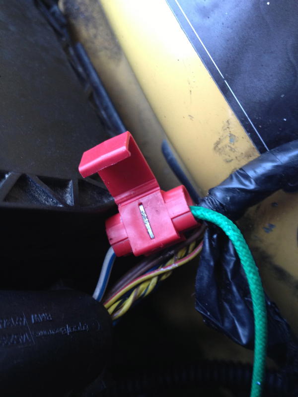

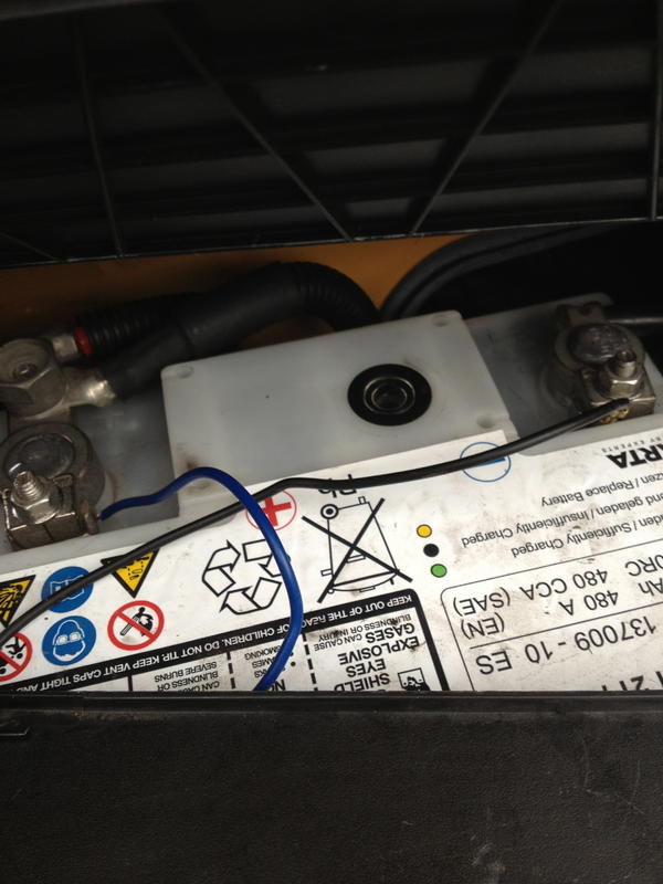

Ok this install isn't rocket science here but it still will not work correctly on my MINI. I just received the new converter and the problem is still the same. As soon as there is power hooked to them, they stay on ALL THE TIME. They do not shut off if I turn off the DRL on the MINI, they do not turn off if the lights are off, they do not turn off when I lock the car, they do not turn off if I take the green wire off the white/blue wire, they do not turn off until they are unplugged from the battery! I know this sounds like Dr. Suess but this is really frustrating! Aaron help!
Attached Thumbnails LED Fog Light DRL's from OutMotoring-img_1689.jpg   LED Fog Light DRL's from OutMotoring-img_1688.jpg
Old Jan 12, 2013 | 06:14 AM
  #146
mickdayank's Avatar
mickdayank
Joined: Aug 2008
Posts: 94
From: Mississippi
My Fix
Ok here is my fix and it's funny because after reading this thread a few times it is a hybrid of a few solutions.
Black wire- battery ground
Blue wire- white/blue headlight wire
Green wire- white/blue wire...but lights were dim and flickering at idle a bit...SO took off green wire and lights are bright and not flickering (look better anyway).
Turned OFF the DRL in the SETTINGS menu on the MINI.
Result: LED Lights come on with headlights, go off with headlights. Never wanted DRL in the first place so no lights during the daytime. LED are on with low and high beam. Fog lights still kick off when hi-beams are used.
If anyone sees a problem with this please let me know but this seems to be the only way they will work because no matter what I did, hooking straight to the battery put power to them whether the car was on or off...kinda like some 12 sockets in cars. The converter box didn't get hot or any of that so I think all is well.
Did the post directly after your post help resolve your issue? If not, please email me directly so we can work this out for you.
Aaron, yes the solution below has solved the problem. Don't know if you want to give feedback to the mfg but the directions included did not work at least on mine. Thanks again for the help and they look GREAT!!
