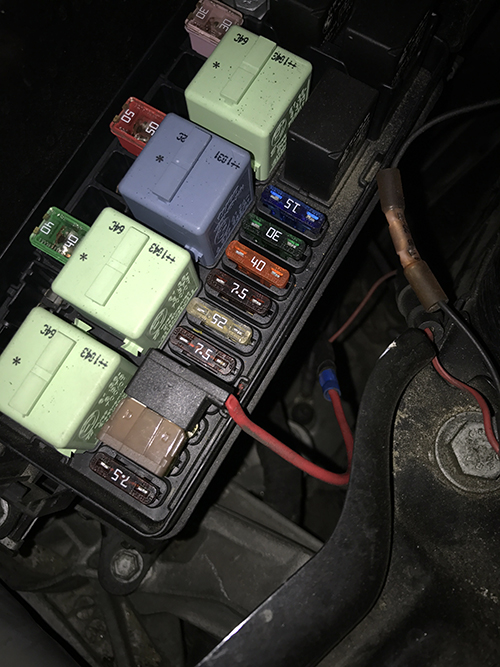

Originally Posted by njaremka
Curious which fuse you tapped for your light installation? Help a brother out?
I used the engine bay fusebox for easier wiring.
I added an "add a circuit" fuse adaptor, and grounded on a strut bolt to the right in the first photo. I cut a hole/channel in the fusebox cover to allow for the circuit adaptor wire.
Hope that helps.

One last follow up question: How long do the lights stay on once you leave and lock the car?
Hope that helps.
Jake
