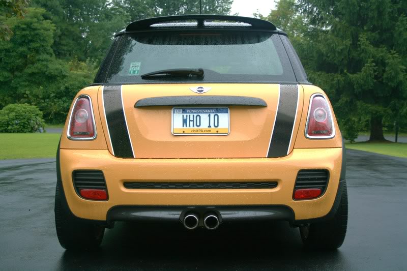

Thanks for the info, quaestor! I looked around Walmart and other auto sections for adhesives but didn't find anything I was comfortable with putting on my car. In the end, decided to leave my MCS unbadged.
Just did boot stripes in early August, and it was SUPER easy:

Looks great. That looks like a deeper yellow than normal. The stripes set off the black roof well. I'm still amazed how many come up to me about the car in parking lots and especially drive-thru windows.
They love the look and ask all about it. I just took it to Savannah 2 weeks ago and had a blast. So fun to drive and averaged 33.4 mpg. I love this car!!!!
